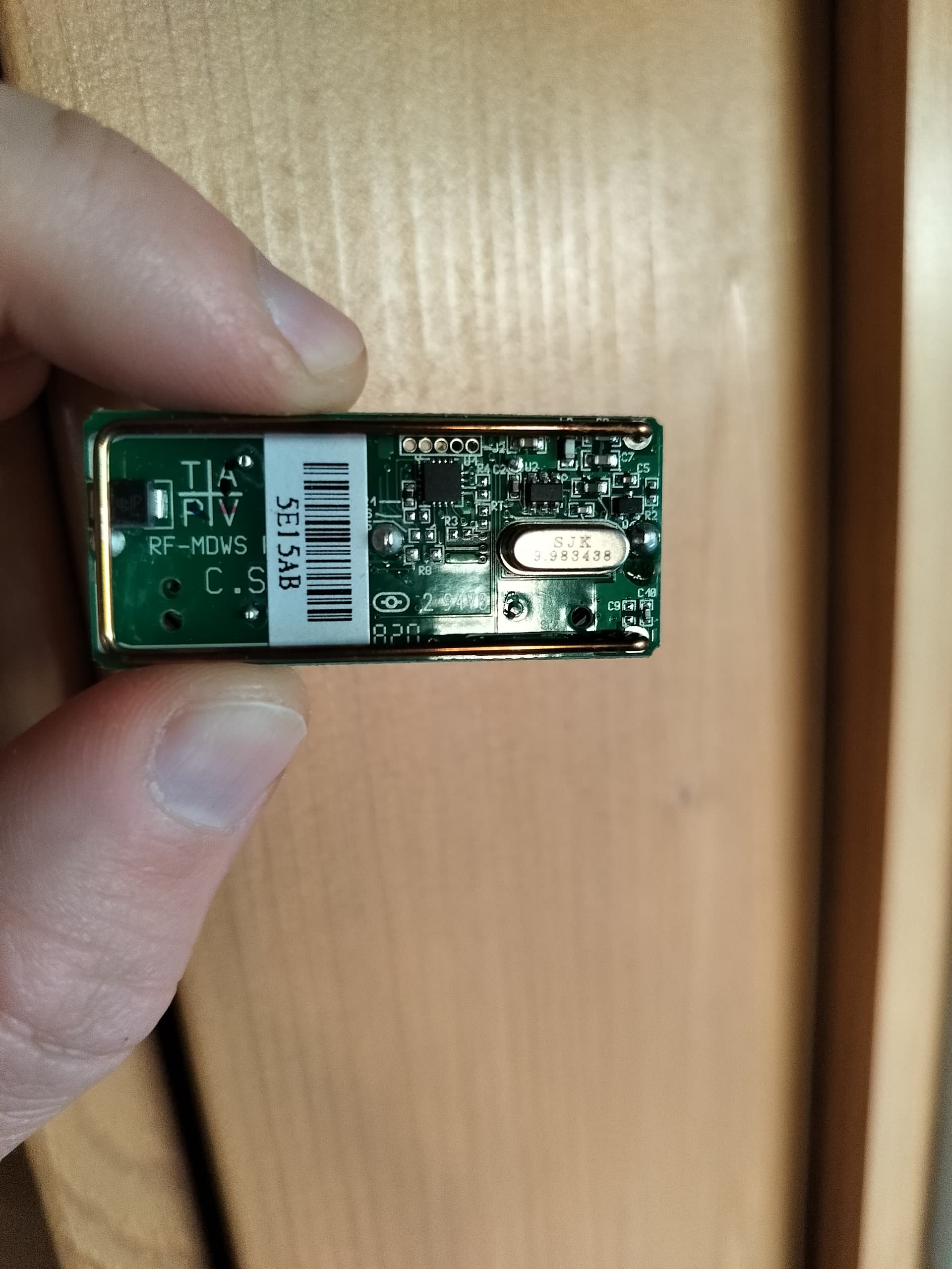

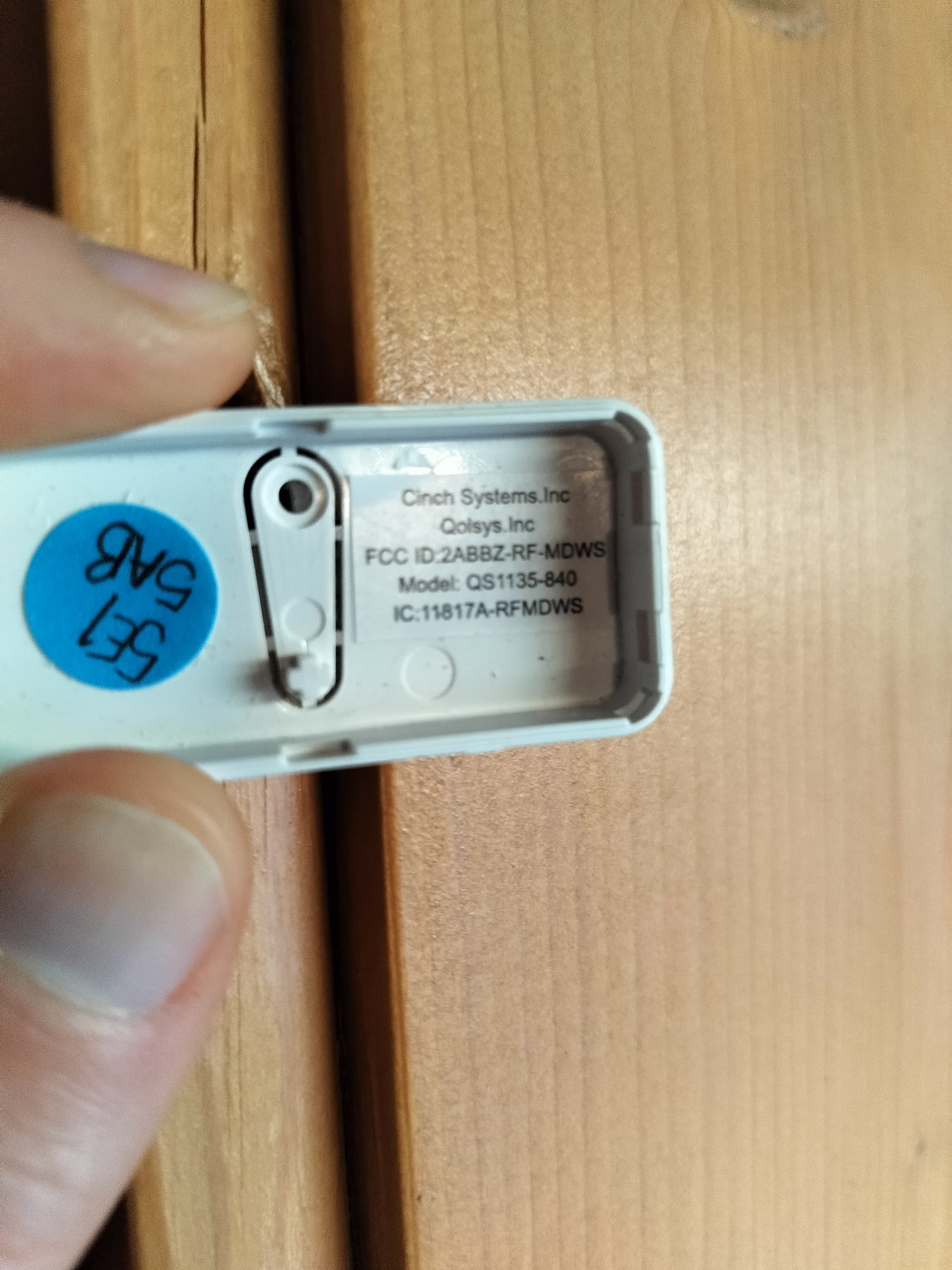

The Radio version depends on the types of sensors you currently have installed. What is the model of your current panel? This can tell us which frequency it has, as 319.5Mhz is for Interlogix/GE sensors and 345Mhz is for 2GIG/Honeywell sensors. The model number can be found on the back of the panel. You could also send us pictures of your sensors so we can try to figure out which one you would need.

All IQ Panel 2s have a Z-wave radio, but the sensor picture helps identify what you have. That QS1135 is a Qolsys S-Line sensor, which is a 319.5Mhz sensor.
You would want the 319.5Mhz radio version of the IQ Panel 4 if you plan to swap out the panel.
