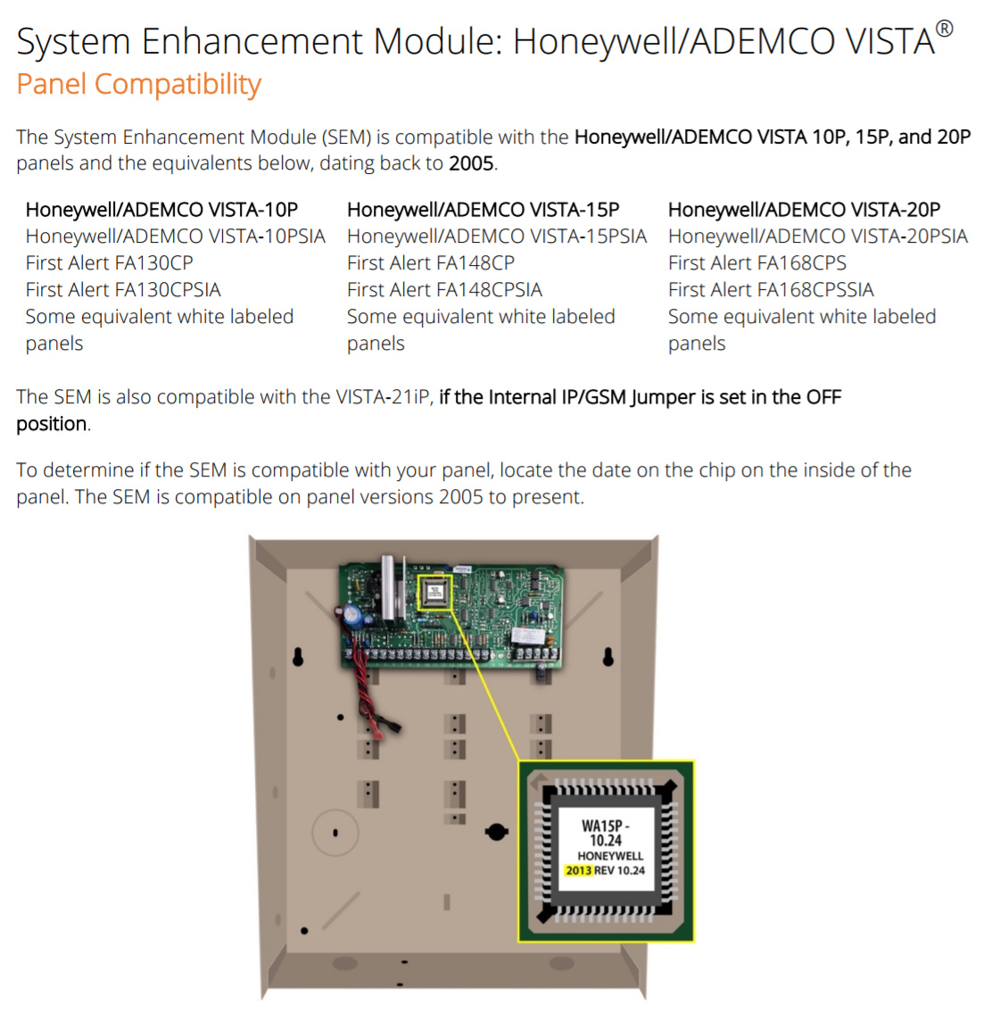

Another option may be the SEM, as the panel you mention is based on the Vista 20P I believe. We would need to verify compatibility.
Check the compatibility information attached.
