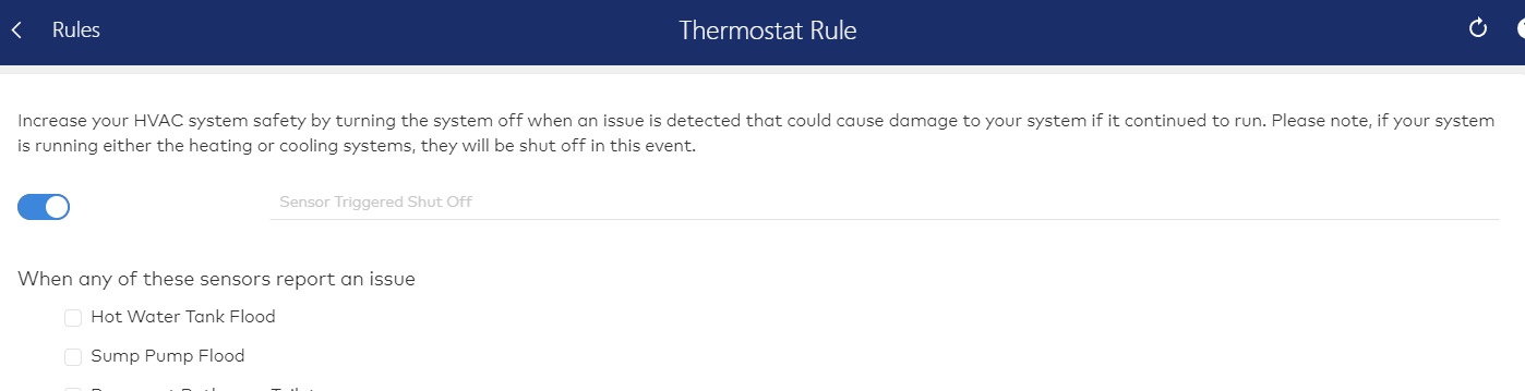

However, when I go to automation, click on “add new rule” , I can choose “thermostat rule”, it then directs me to sensor triggered shutoff when I can select mainly flood sensors, which is odd, and at the bottom is says “Turn OFF fan and thermostat”, where I can save or cancel.
As to what thermostat its referring to, I dont know. I only have one thermostat linked to my alarm.com account, its the Nest (wifi) thermostat.

I would recommend forwarding these images to your service provider so that they can check with Alarm.com.
We cannot open tickets in Alarm.com for an account under another dealer, and this looks like something is off about your setup.
Either this is an Alarm.com display bug, or you live in a region where this may be supported somehow and your Flood sensors are reporting/being categorized by ADC as Smoke, Fire, or CO detectors. My guess: this is a bug.

I will reach out to my dealer about this. However, I tested it again this morning, and indeed it does turn off my HVAC when a fire alarm is detected. It changes the mode to “OFF” from “Heat”. Checking the log, there is a entry that says “Home: A sensor on your account reported an issue and shut off Garage at time and day.”
Garage is the name of my Nest Wifi Thermostat.
