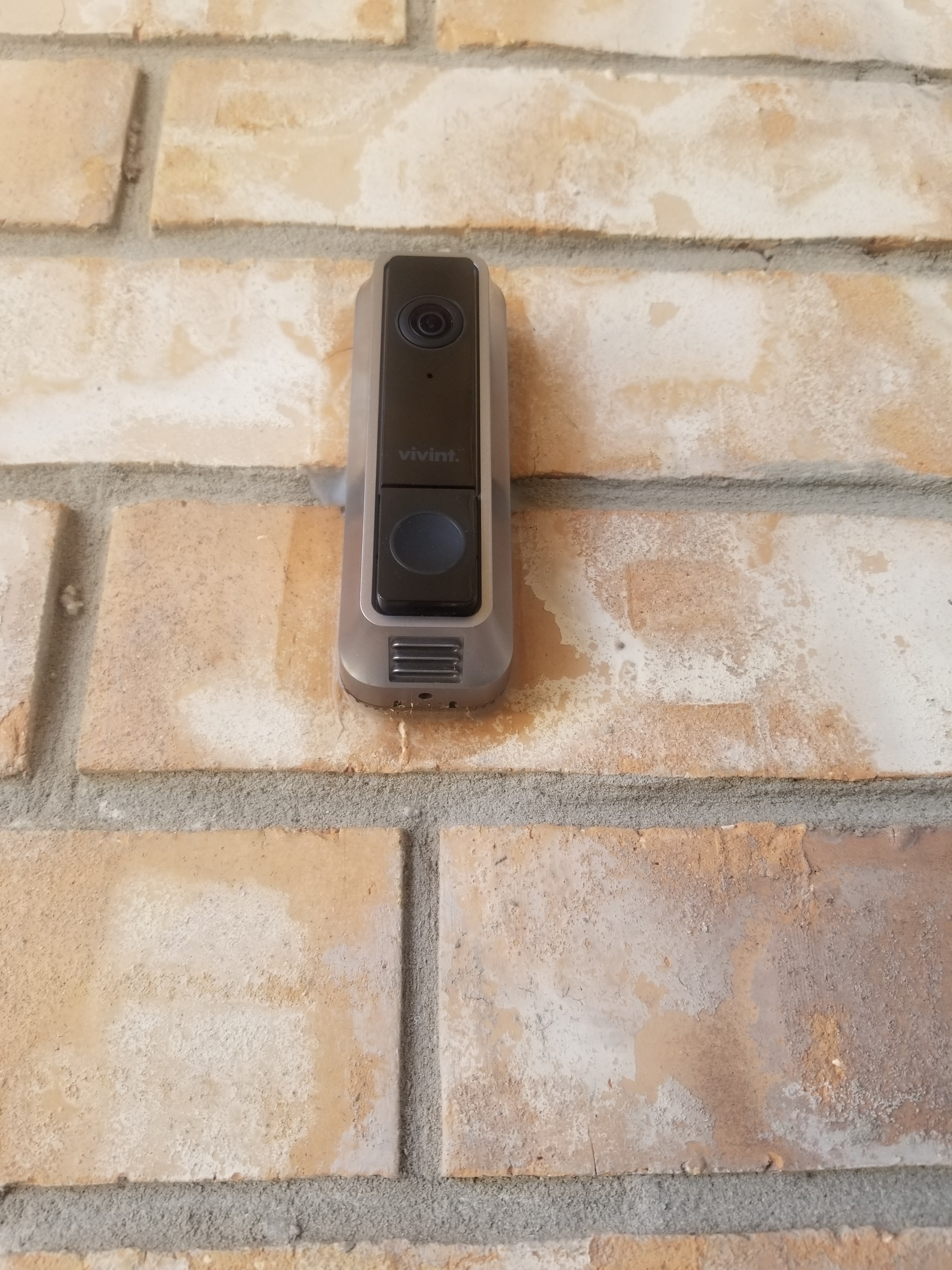

Just moved into my home I want to remove my vivint doorbell and control panel without just ripping them off the wall but they lack removal tutorials on their website. Can anyone help? Particularly the doorbell. I dont want to compromise the wires behind it.

The doorbell likely has a set screw holding the doorbell camera to a mounting bracket that is screwed into place. Do you see anything like that?

there is a hole at the bottom for a set screw. I just don’t know if I need an allen key, a small philips head, or flat head screw driver. If its an allen key I assume it is a small and a size I dont own.
I assume to get to those mounting screws to the brick I need to remove the face of the doorbell. It might be a torx bit to remove its hard to see in the tiny hole but I will give it a try
yeah the grey part (the doorbell itself) is attached to the black mounting plate. The plate is screwed into the brick. Removing the set screw should allow you to remove the doorbell.
you’ll want to lift it off gently to avoid yanking the wires, if possible.
Yes pulling the wires is exactly what I want to avoid I dont know how much slack I have behind this doorbell and Vivint support was horrible with giving info for the removal. The panel I removed but they leave a huge whole in the wall to sit the panel inside.
