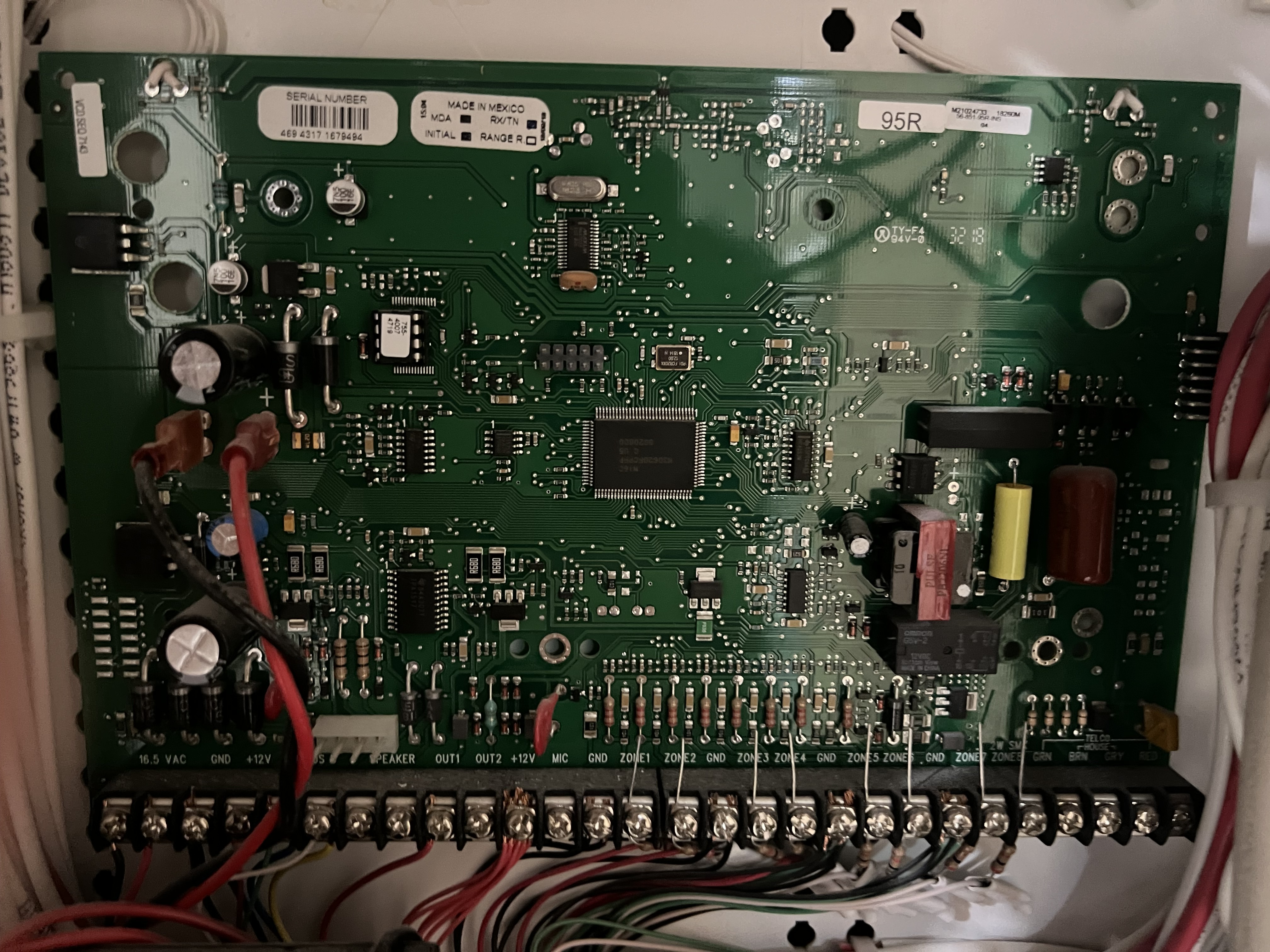

The attached image is of the keypad, not the panel itself. The panel is mounted inside a metal can (typically tan) and is usually located elsewhere, away from the keypad. The module would be mounted near the can in most cases.
That is a serial number label on the panel. That number is not related to the cell module.

Can you post a pic of the entire main control panel showing the wire connections?
A land line would be connected to the 4 terminals on the far right. So that’s not it.
If you have a communicator it would be on the keypad bus which is terminals 3-6 from the left, labeled GND, +12V, and BUS. Try to follow those wires and see if one of those cables leads you to the communicator.
Was able to get the system up and running today. Finally found the cellular module.
