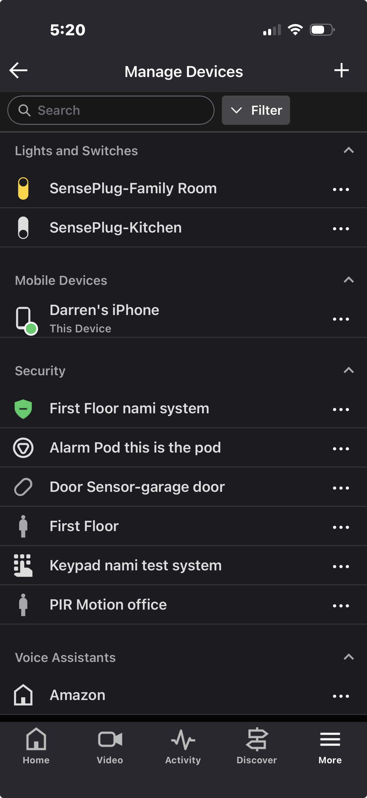

@Tyler I had a bit of a challenge getting the new PIR added, but it is now added and working.
What I discovered was that if I named the new PIR the exact same name as the previous one, it would scan the barcode, and just hang… never going to the “pong game” screen. Eventually it would just time out. This is even though I did remove the old PIR from the ADC app days ago.
I wound up just calling it something different and it added instantly. Interesting!
Just wanted to share.
Can you change the name back to what you wanted in the first place?

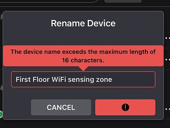

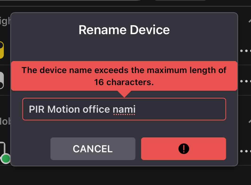

I just tried and the short answer is no, but now it says why!?:
Strange it was called this previously, and the UI didn’t give me this error on initial inclusion.

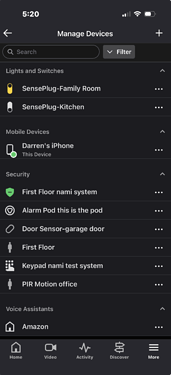

Here’s an older screenshot showing the original name just to make sure I wasn’t hallucinating.
Do you get that 16-digit error if you try to change another existing sensor or the same sensor with a different name?
I’ve got my pod and PIR named with greater than 16-characters
When I first installed the original PIR it was greater than 16 for me too! I only found this when adding the new one.

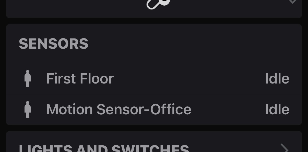

I just went through everything in my nami test system and tried to rename longer than 16. Here’s the results:
Panel Name: Yes, can be longer than 16
SensePlugs: Yes, can be longer than 16
Alarm Pod: Yes, can be longer than 16

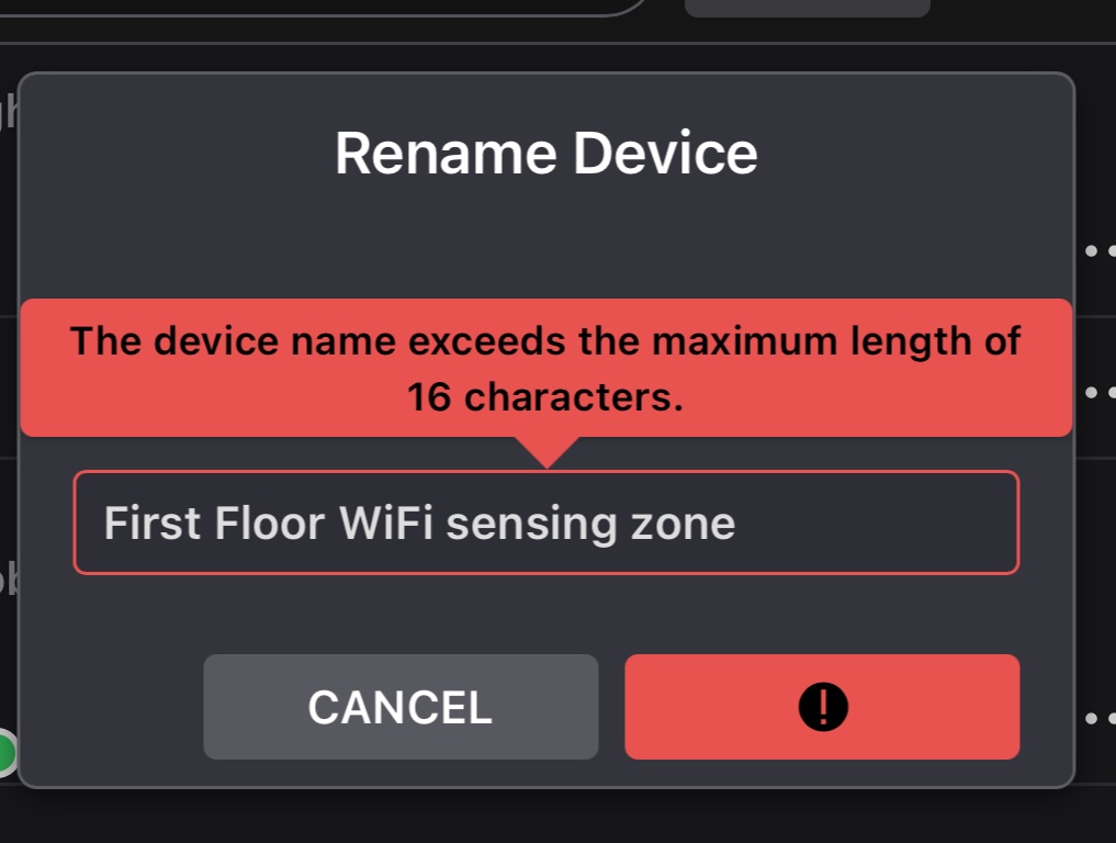

Wifi Sensing Zone: NO (see screenshot below)
Keypad: Yes, can be longer than 16

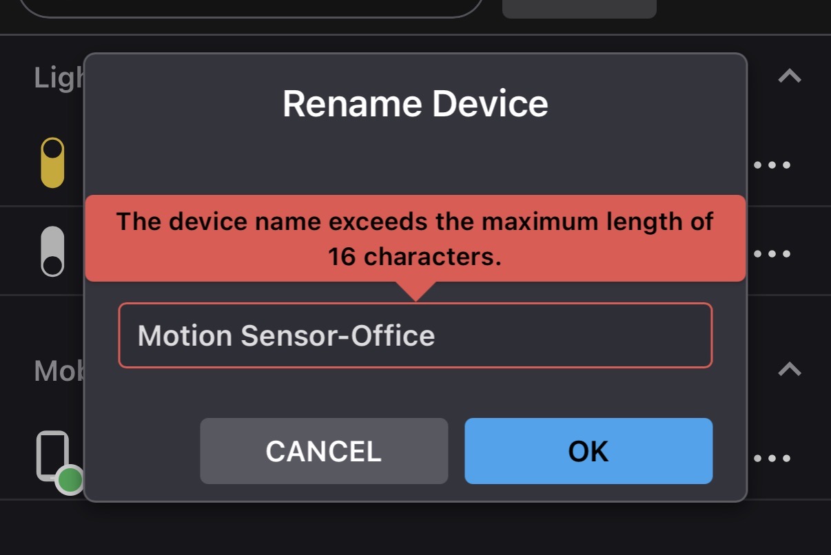

Motion Sensor: NO (see screenshot below)
We’re still looking into this issue. It seems like the 16 character limit is only enforced when adding or renaming a motion zone later, but not during initial system installation. Either way, I think 16 characters is too short a limit for zone names. We’ll follow up when we have more information.
The 16-character limit seems to be an overzealous limit that slipped in on the Alarm.com side. It’s being worked on. Sorry for the inconvenience.
