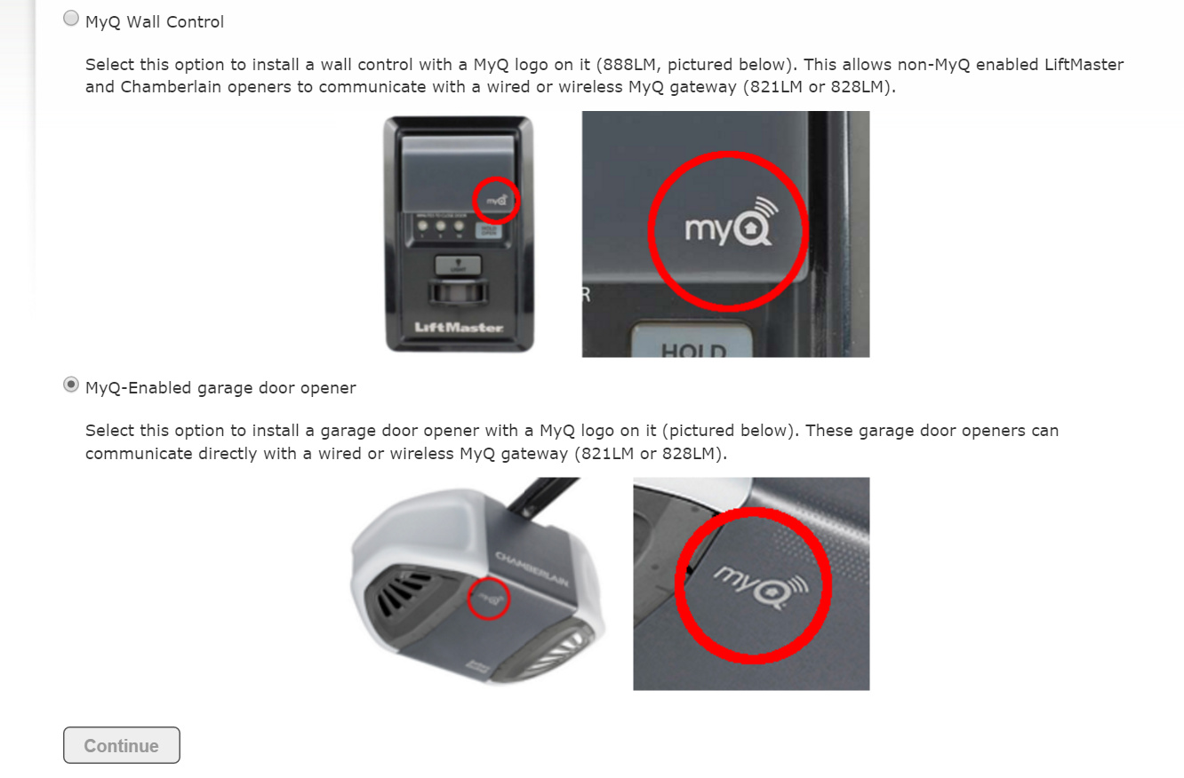

So far my attempts have failed. When I go to alarm.com and select add a garage door opener with WiFi, it say to put the opener in learn mode and click continue. Between the opener’s installation manual, alarm.com directions and tutorial videos, I’ve seen three different ways to put the opener in learn mode. None of them have worked.

So, just to clarify, you are selecting “Add a new device” in Alarm.com, selecting the “MyQ Enabled Garage Door” option, then verifying your gateway LED indicates it is looking for new devices, then pressing the button on the overhead controller?

On alarm.com I select “add a new device” and “MyQ enabled garage door opener”. It then says to press the learn button on the opener for 2 seconds (this is different than how the manual says to put it in learn mode, which is push 3 times and listen for a beep) then click continue. Then it times out and says “We couldn’t find any new devices on your gateway. Press the retry button below to restart the learn-in process.”
