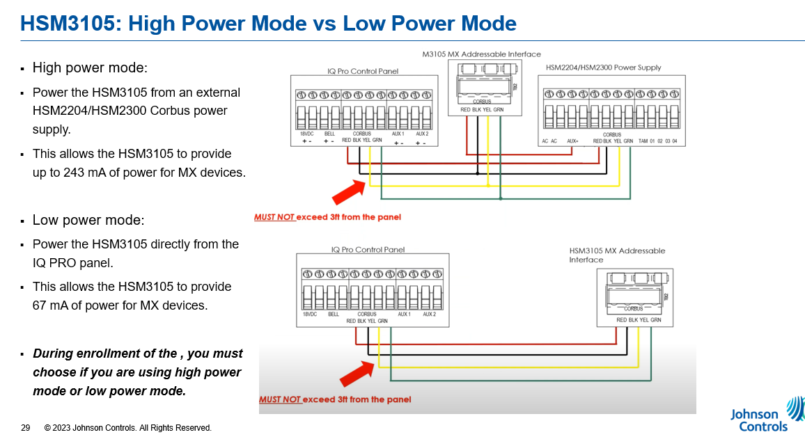

I was wondering how to install the MX3105 in metal IQPro panel. The instructions indicate that the ground terminal on the MX should be put to the same ground as the IQPro, but the IQPro doesn’t have any obvious ground terminal. What’s the best way to tie it all together? And presumably I’d need to ground the IQPro itself to something.
Qolsys is observing Martin Luther Kind day and will not get back to me on this questions until tomorrow. I will update you as soon as I hear back.
Qolsys responded saying there is no Earth Ground on the IQ Pro. That the only wiring needed is displayed int he diagram below.
