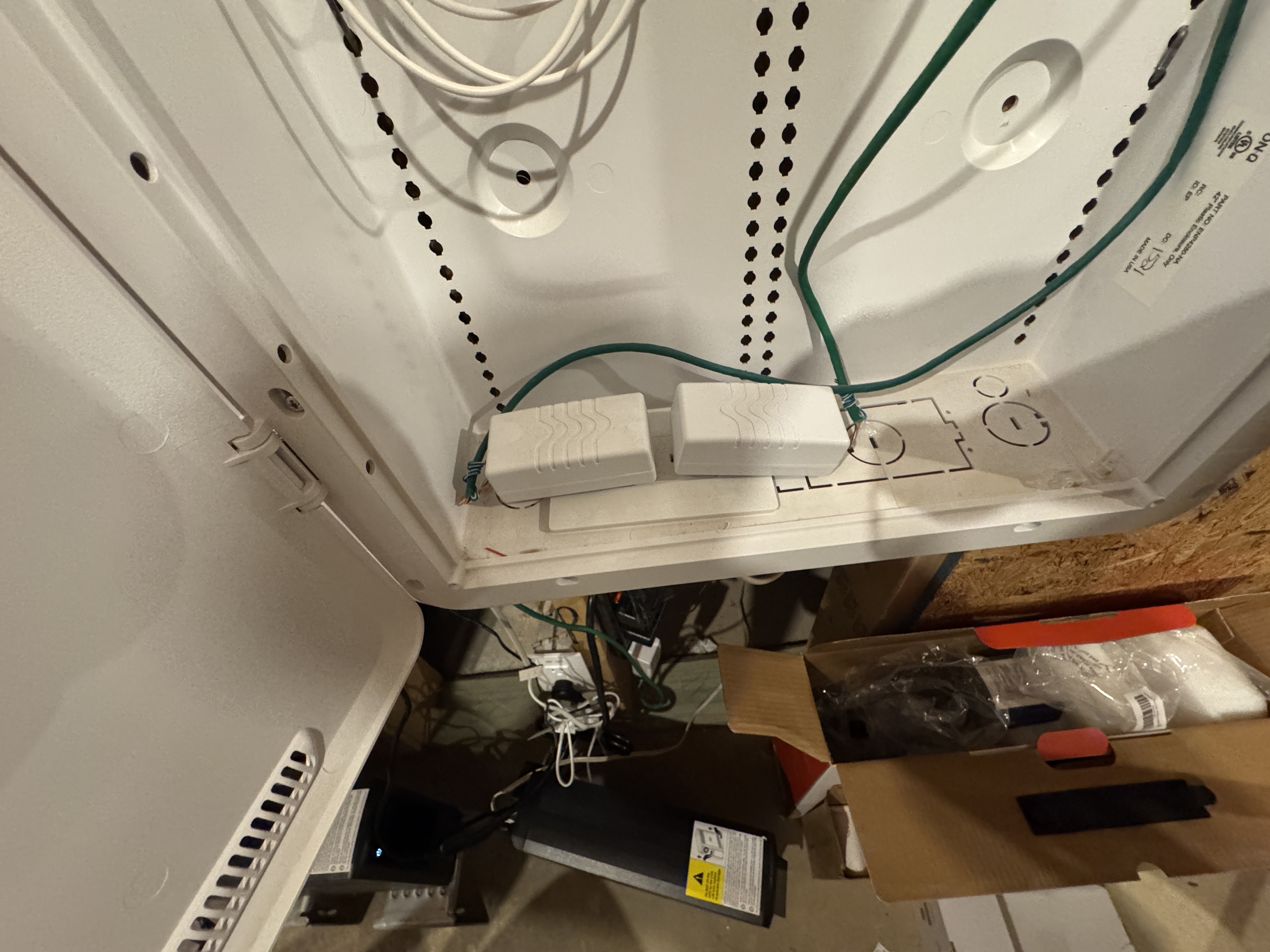

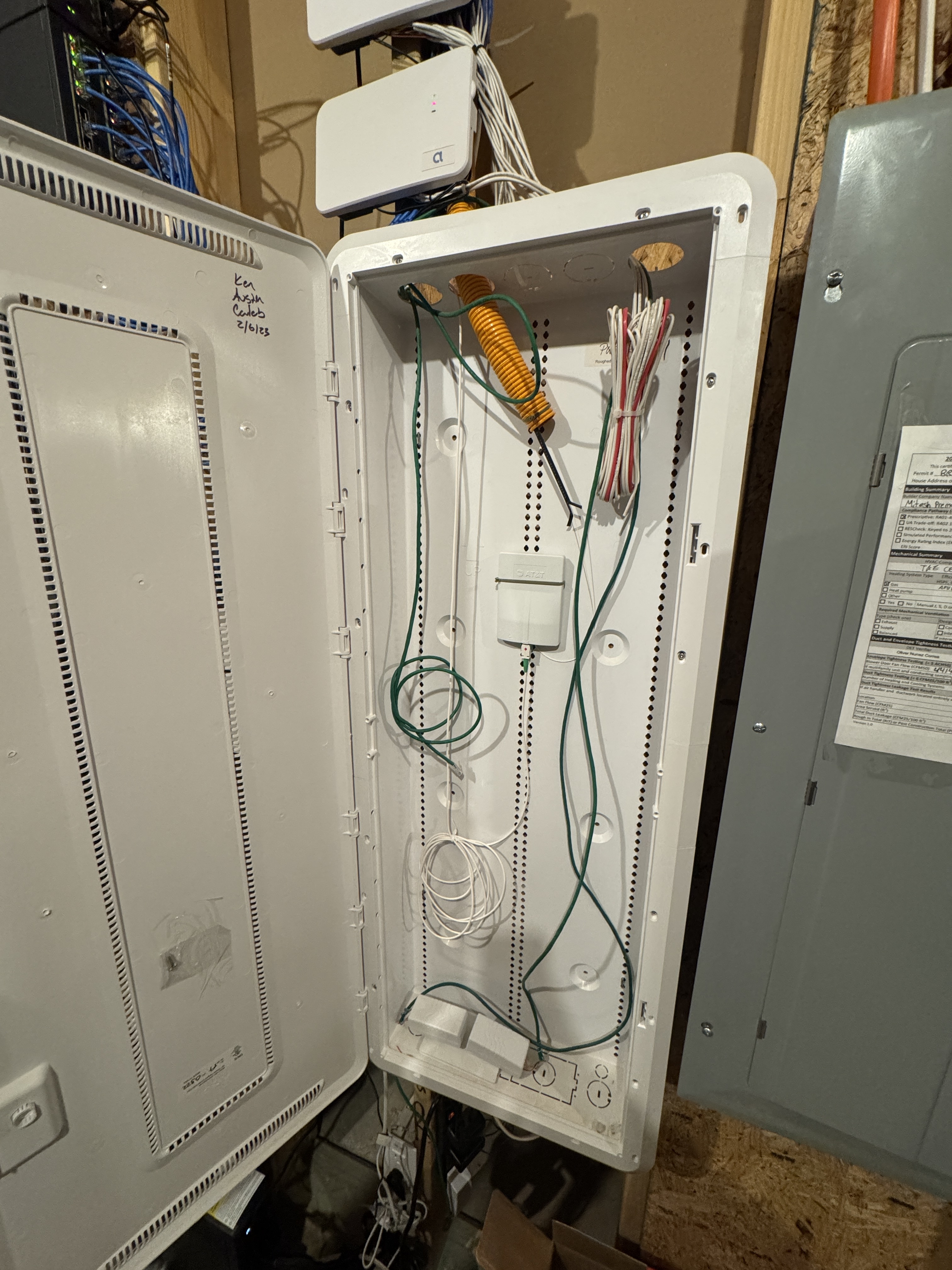

Attached is a picture of the inside of a plastic cabinet I found in my machine room which bears the logo of the original alarm company.
Thanks for the photos, yes often homes are pre-wired for some wired alarm sensors but a wireless system is used, so a wired to wireless translator is installed to make use of those wired sensors.
You do not have a 2GIG TAKE-345 but it looks like you have the Alula/Resolution Products equivalent. That looks like you have an Alula RE508X up above the cabinet where the bundle of wires are running.
The RE508X pairs zones to the panel the same way as a 2GIG TAKE-345, where the each zone has the same TXID as the translator, with the last digit changed to match the wired input number for that zone, 1-8.
That would be the device which is transmitting the status of your wired alarm sensors.
