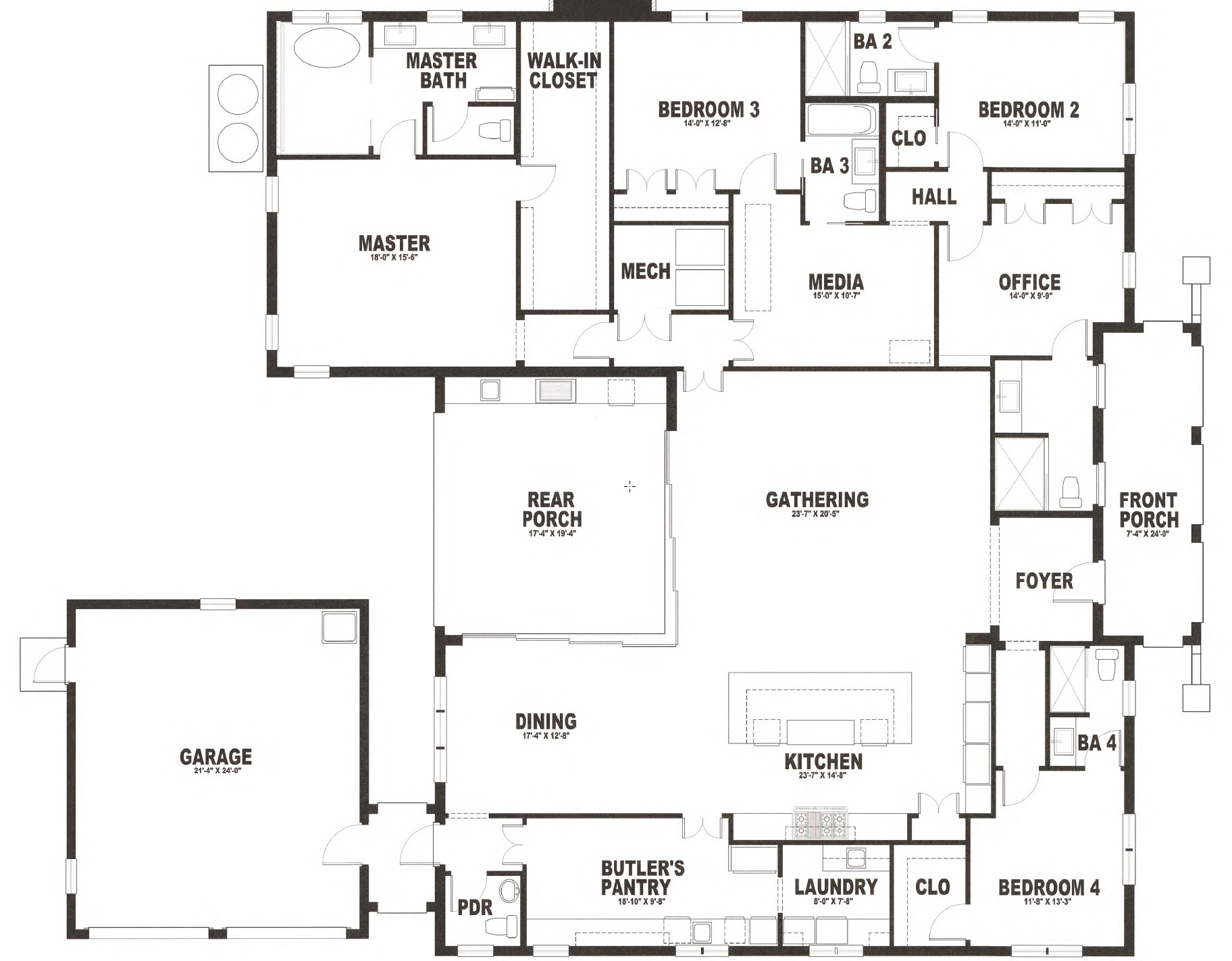

Helping someone design out system for new home and looking for some input on motion sensor choices.
Floorplan of the house
Note that the south and east walls out to the rear porch are full sliding glass door walls.
At least during initial deployment, we are looking at motion detectors to cover the Media Room, Gathering Room/Kitchen, and possibly Dining Room.
For the Media Room, I am thinking an IQ Motion. Is there any reason it makes sense to spend more on a PG9914/PG9984P for such a small area?
For the Gathering Room, a PG9984P in the NW corners of the room seems to make the most sense, given it has the longest range to cover southward into the kitchen area. That being said, I don’t think I really need to reach too much into the kitchen area because it’s a dead corner (fully walled) so it’s not like an intruder will be in that area without tripping the motion from the gathering area, unless they come in from the butler’s pantry door closest to the kitchen and immediately hang a right into the kitchen and park themselves there. Because of all of that, I was thinking about maybe offering the PG9914 for this area, mainly because it’s more discrete looking, but looking for thoughts on if giving up the range would be a bad idea, or there is some other reason having a DualTec sensor would be more desirable for this area.
Optionally looking at another motion in the NW corner of the Dining Room. I am saying optional because the thought was that an intruder is going to traverse into the gathering room zone at some point. If a motion goes here I was thinking perhaps a PG9914 just so it stretches further into the Kitchen than IQ motion would go, but going back to that train of though above, is it necessary? Can we get by with just an IQ Motion in the Dining Room to save some money?
