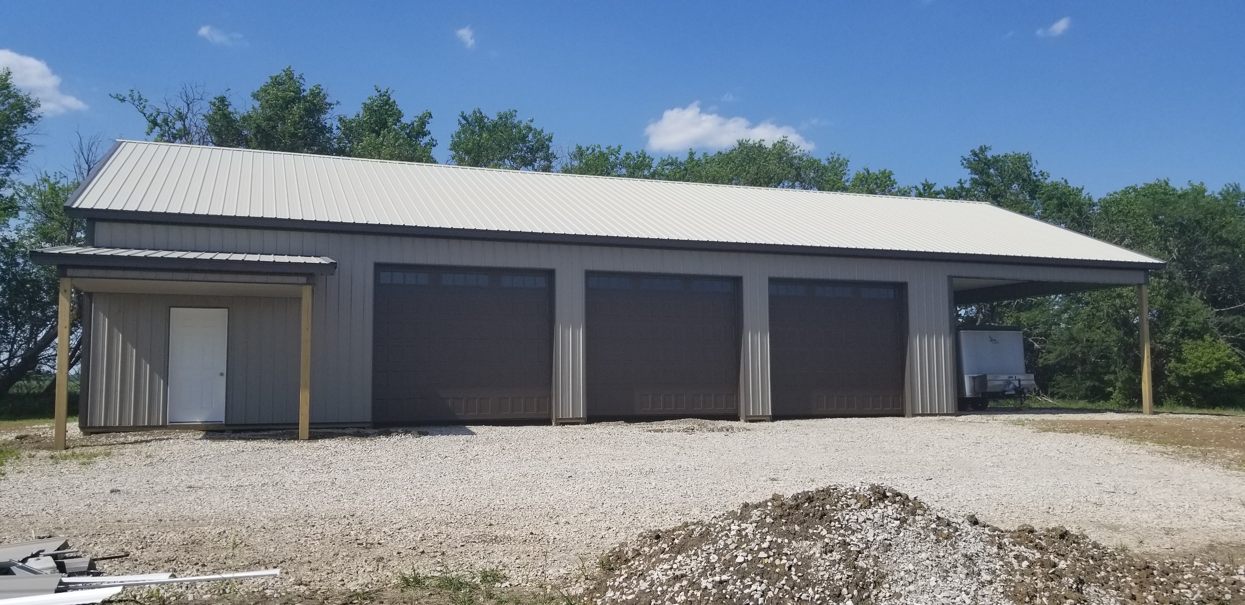

Is there a way or a specific product that I need to monitor my shop that’s approximately 200 feet away from my house? I do have a Cat 6 network line out there with working internet and would like to monitor it with my existing GC3 panel. The shop is metal which attenuates any cell and FM signals so I don’t know if a signal booster from the house will work. The building is not insulated or heated yet, but I plan on doing that next year. Can you give me some suggestions?

I do have an extra cat 6 cable pulled and if I can use that than I’m fine using wired sensors and a few DW10s. How would I set up the DW10s? Wire the wired sensors in series to the Cat 6 then terminate to the inside of the DW10? Ste the DW10 as a perimeter sensor?

Yes, you could use a few different DW10’s if you want multiple zones or you could wire them all in series to one DW10 if you are ok with the detached building being one zone.
The DW10 comes with an input plug and wire leads for a wired contact input. The DW10 wired input uses Loop 1, and typically yes you would program those doors as perimeter.
