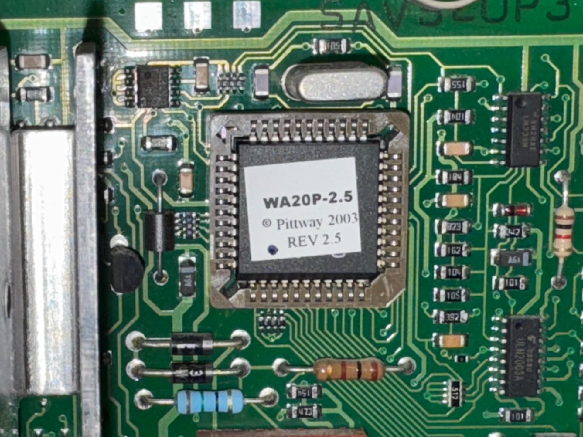

Another follow-up, I see that the SEM has compatibility restrictions. Looks like our panel is manufactured in 2003 and the firmware version is lower than v5.2. Does that mean I cannot pair a SEM with this model?
In order for the SEM to be compatible with the panel, the vista 20P needs to be 2005 or newer with version 3.1 or higher.
Since this is a REV 2.5, I wouldn’t recommend replacing the PROM chip as this is a huge jump. I would instead recommend swapping the panel with a newer vista 20p.
With swapping the panel with a newer one, you can reuse the same keypads and alarm enclosure.

IIUC you are suggesting to replace the PCB with something like this which has newer PROM chip (ignore the enclosure)
While replacing, if I exactly replicate the connections with the new PCB would that be enough. Or is there any additional programming required to pair with the existing panels

You would be required to reprogram the panel. The programming is what tells the panel what each device is, and what the panel should do when a zone is triggered.
Nicholas is correct. You would need to program all the zones and tell it what each is as well as any used codes on the panel. The panel will come with factory settings.
