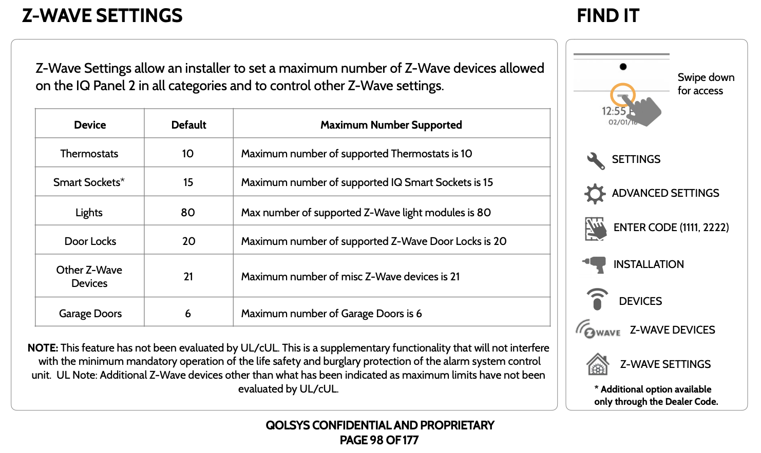

So I just tried to add a 4th Z-wave lock to my qolsys panel. Apparently I have a limit of 3? I have a Qolsys panel. Is the limit of 3 a Qolsys panel issue or a surety account issue?
Thanks!
Thanks!
you might be able to change that limit in the settings. I’m not at my panel right now so don’t remember exactly where, but do remember seeing something like that in the advanced settings.
