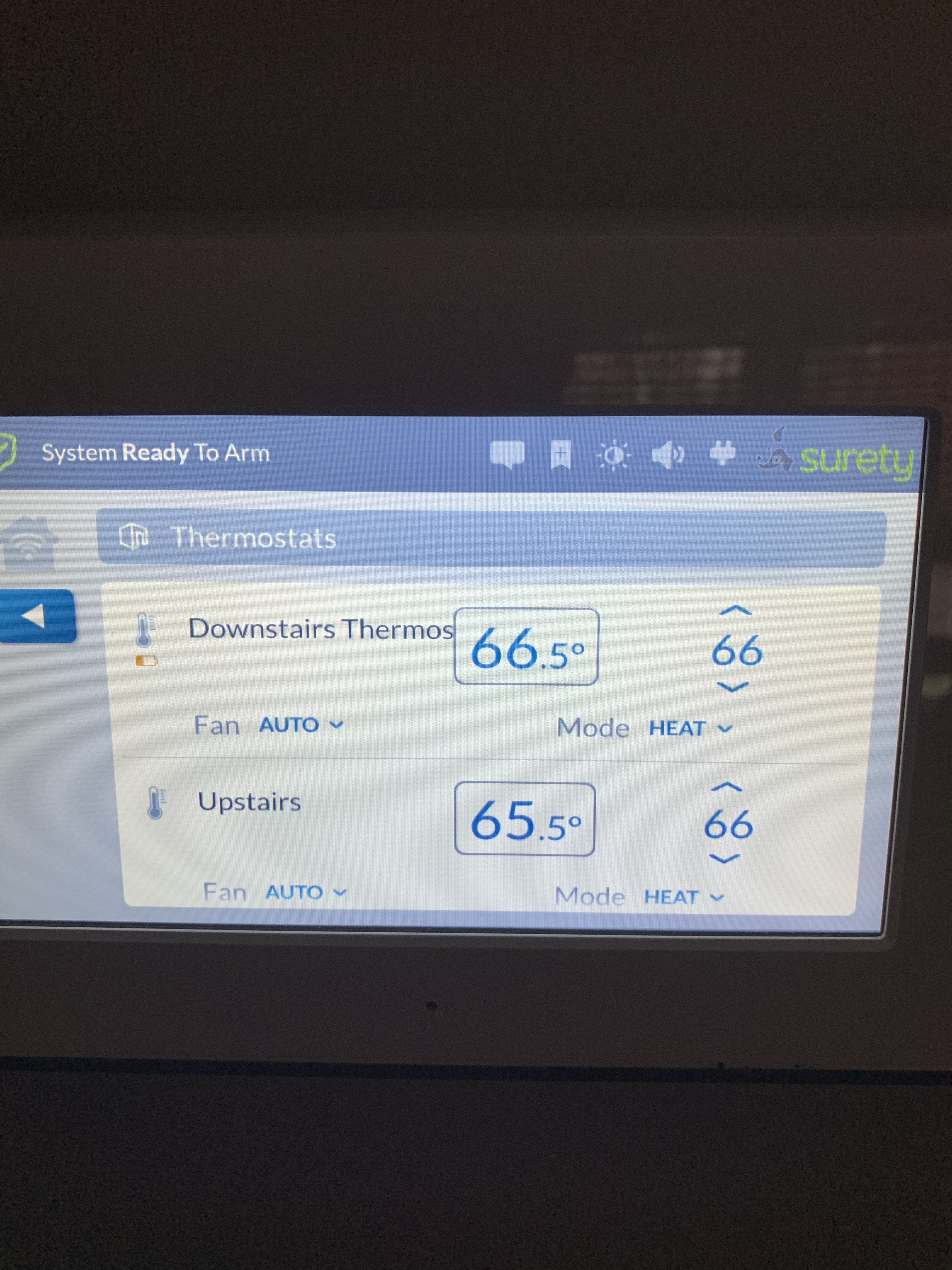

Hi - I have 2 ADC T2000 Thermostats in my home. (Upstairs and Downstairs)
Downstairs reported a critical low battery alert.
I replaced the batteries with brand new ones.
I then received (about 24hours later) the notification that the critical battery alert had been resolved. Nice. Normal Behavior - Right?
Now I am getting the same critical low battery alert for the same thermostat. When I view the thermostat on the alarm panel, I see the low battery icon.
For grins, I changed the batteries again with brand new ones. No change in behavior. I forced the panel to rediscover my network. No change in behavior.
Perhaps something needs to be cleared/reset on the backend?
Thoughts?
Thanks!

Hey Jason! Thanks for the response and suggestions. Add’l info:
1: This TS is connected to a C wire. The batteries have been fine for right at a year (I installed them prior to Christmas last year)
2: The new batteries (I replaced all 4) are date stamped Feb 2030.
3: This morning, I removed the batteries and waited two minutes before reinstalling.
4: The low battery icon is still visible on the panel. How long before the network refreshes that information?
Of course, the upstairs thermostat has no issues. :wink:

Does the thermostat itself indicate low battery on its display?
No sir!
I’m thinking that status is just stuck at the panel side. Can you try a power cycle of the panel? Unplug transformer (from outlet) then battery. Wait a minute, then plug in battery followed by transformer.
Hi - I did a complete restart: Removed wall power and unplugged the battery for about 5 mins. Reconnected and restarted panel. Same low battery alert for the downstairs thermostat on the panel.
I then removed the thermo completely from the zwave network.
Placed new batteries (again) in the thermo and added it back to the zwave network. Great news - I no longer have a low battery icon on the panel for the thermo!
However - I still see the “downstairs” thermo in my ADC app/profile. ADC thinks there are now 3 thermos. 2 down / 1 up. Can you remove / re sync for me?
Thanks!
Happy to! I sent some resync commands and a network rediscovery to your system and the additional downstairs TSTAT was removed.
You can send z-wave resync commands yourself via the System Manager feature of your Surety account now as well, should you need to in the future.
Awesome! Appreciate it Tyler. I was not aware of that feature where I could send the re-sync myself. Thank you!
No problem! You can also send remote panel reboot commands from there and make changes to your service plan as well. Have a great day!
