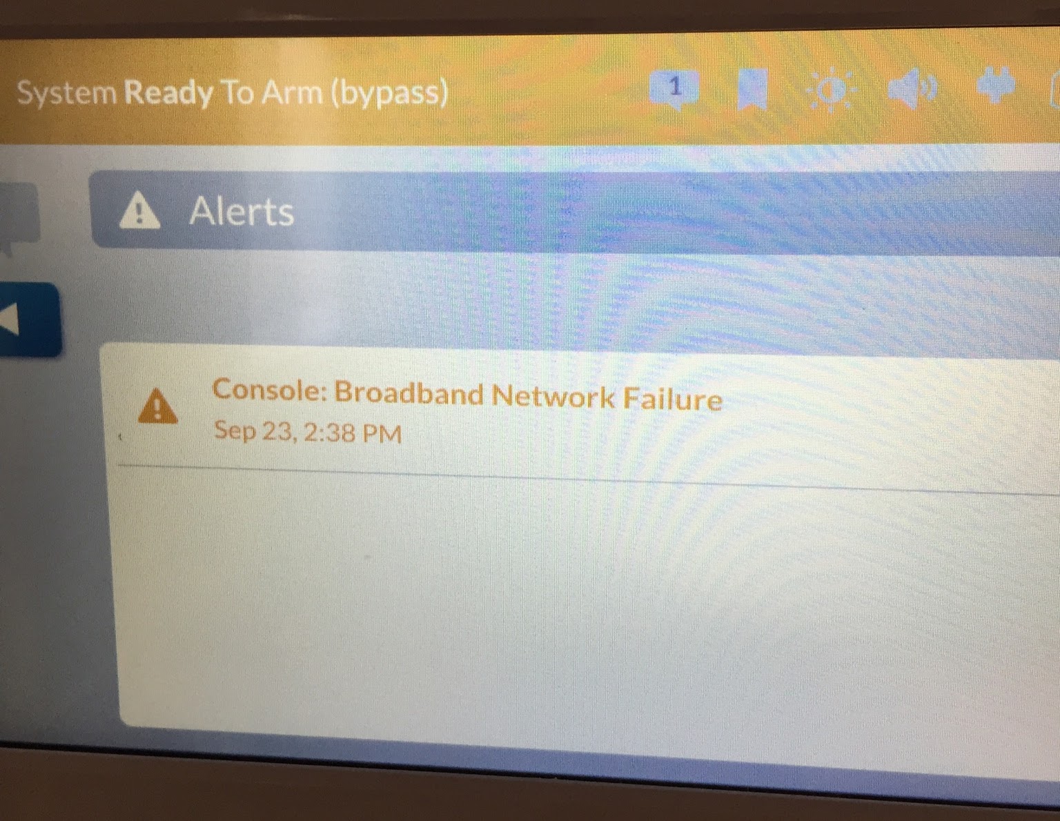

Hi, the other day, my wife called me to tell me our GC3 was beeping. She sent me a picture and it showed that the panel lost broadband connection. It never alerted me via the ADC app - should it have?
Anyway, the alert went away (I will check again to make sure it isn’t still showing an alert), but I have noticed that the arming/disarming via the app has gone back to the same delay it had before the broadband connection. Once I updated the firmware and connected via WiFi, that delay went away and arming/disarming was almost instant.

It never alerted me via the ADC app – should it have?
No, broadband backup failure is not a separate alert in Alarm.com. This alert will be shown on your panel. We’ve requested this be added to configurable alerts in ADC
