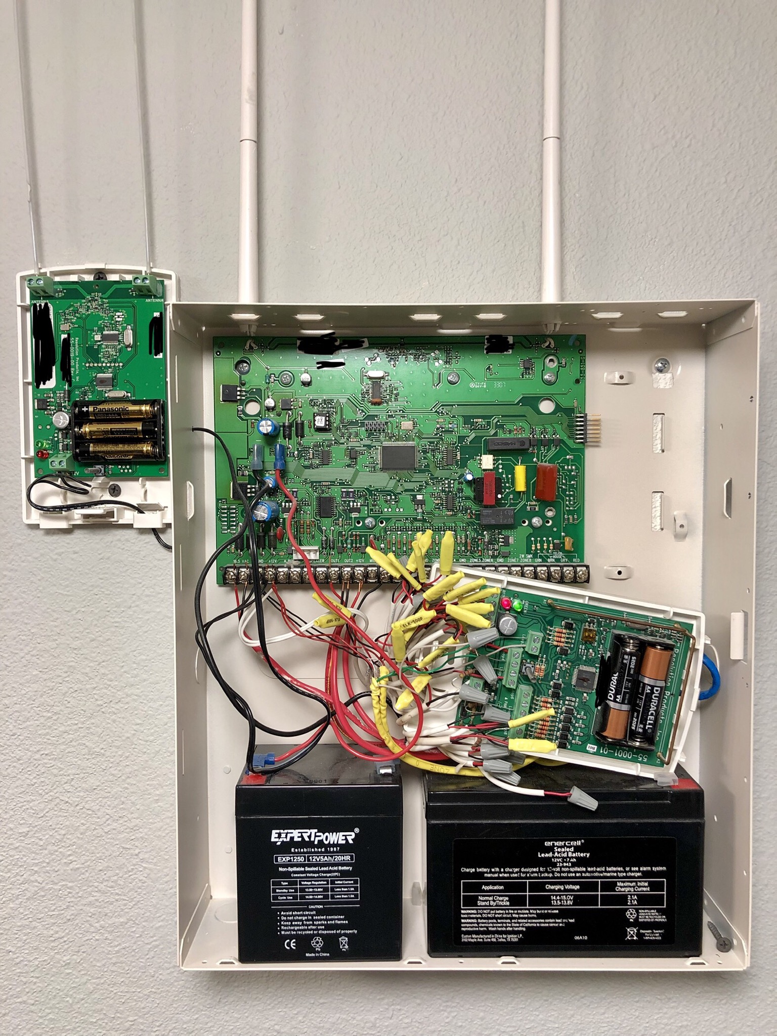

Can you post an image of the wiring at the translator and let us know which zone is causing the trouble?

Unfortunately in the image I am not able to see the wiring for zone one. However, a general issue is apparent in the photo.
The wired to wireless translator should generally never be placed inside the metal can. The surrounding metal, batteries, and circuitry can eat the wireless RF signals being sent by the hardwire translator. I believe we have had a prior conversation where this was mentioned, but you said the door cover is never installed?
The wireless translator should be at least a little further away from the large metal can. It should not be so close to a large metal object. The combined effect of both translators being installed the way they are can possibly be a cause of intermittent supervision and signaling errors like you are seeing. At the very least since this issue appears to be similar to what you were reporting before I would recommend ruling this out.
Try moving the wireless translator further from the panel first. It may even help to just use a 12VDC plug in power supply for it and mount it on a wall facing the open metal can, rather than beside it.
I assume you are referring here to the wireless to wireless translator mounted on the wall outside the box?
If I were to move the wired to wireless translator outside the box, or change to a single translator setup with a TAKE-345, I assume that would require splicing in additional wire length from the original wired sensors, which could be significant particularly if I were to mount the translator on a wall opposite the metal can?
Yes, the first step I would try is moving the wireless-wireless translator away from the box.
Yes, judging from the image, you would likely need to splice additional wire if you were to relocate the wired to wireless translator.
Is splicing in additional wire length what is normally required when converting a wired system to wireless to enable the translator to be placed away from the box? Or is my wired setup in some way atypical, which led whoever created the current setup to do it what way they did?
Wires are usually cut to the appropriate length to wire into the old panel terminals and not much longer. That means sometimes you can re-route them out of the can, but often extra wire must be spliced on by the installer to extend the zones out of the metal can so the wired-to-wireless translator is not inside.
The installer of the hardwired takeover module should have done that in this case. (A little surprising if it was a professional installer, but these things happen)
