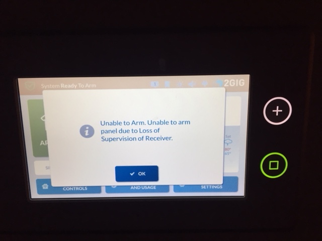

Could you post an image of the error on your panel? What we see on the back-end is simply a general “Module Malfunction” This error typically refers to the sensor transceiver.
Of course. See attached.

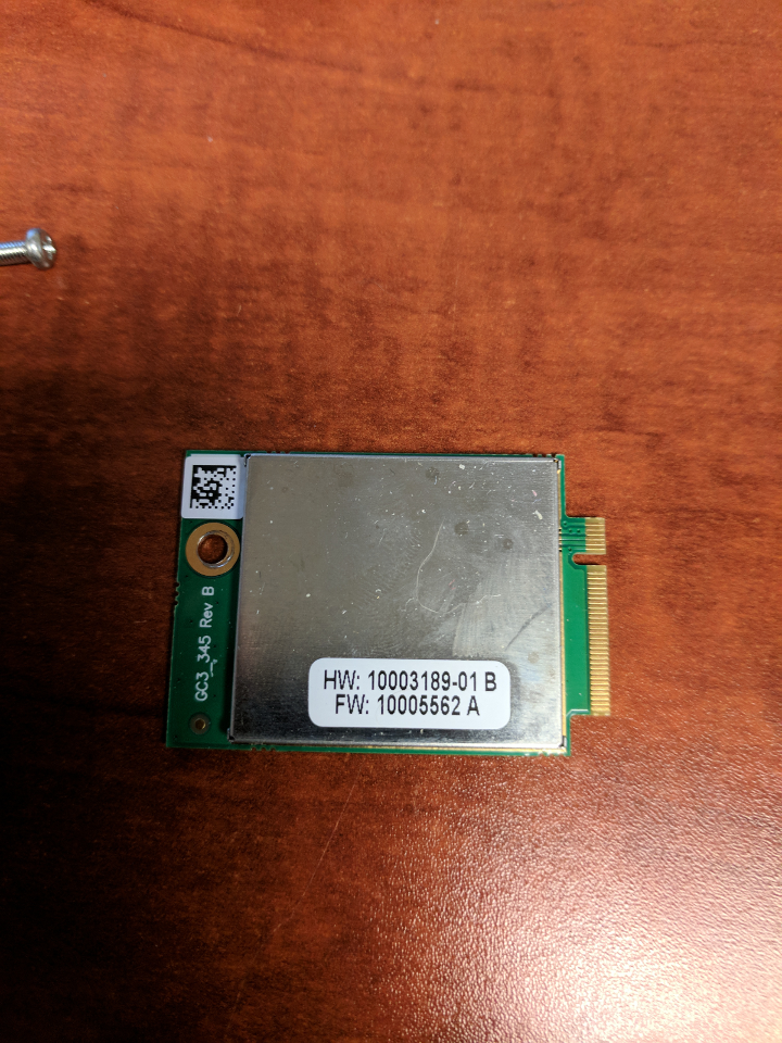

Thank you for the photos confirming the panel errors. The timing of the alerts with the hardwire sensor closing appears coincidental. The issue is going to be with the part in the image attached.
That is the sensor transceiver. If the nearby ribbon was pulled the transceiver may have also been dislodged, especially if the set screw is not tightened fully. Try powering the panel down completely, carefully remove the set screw to the transceiver and reseat the transceiver in place. Secure it with the screw. Then power up the panel. Does this resolve the issue?
Thank you, Jason. I just tried removing and reinserting the transceiver. The first time I booted up the GC3 after this, it gave me the same ‘loss of supervision receiver’ error. So I turned off the system again and removed and reinserted the transceiver. Since then, it seems to be working fine. I gave the system a few minutes (in the past the system would work and then the error would arise later on) and repeatedly armed and disarmed the system.
I am back at work, and the system seems to still be able to arm and disarm remotely through the app. Fingers crossed. I’ll keep you posted.
Thanks again.
