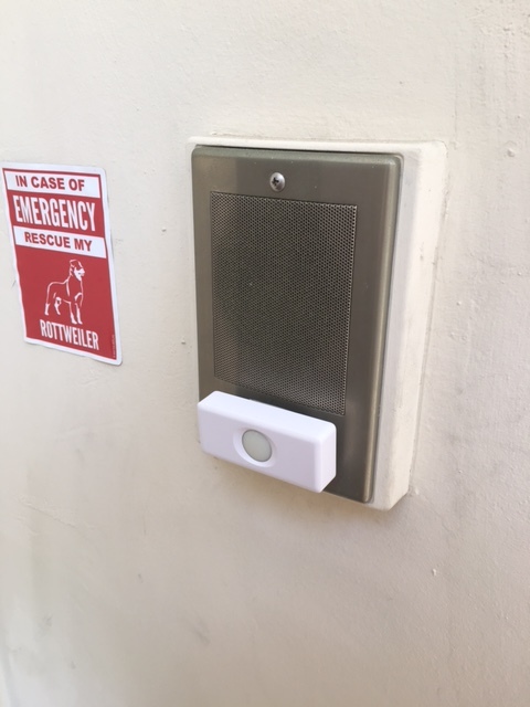

Ok here is my mod.

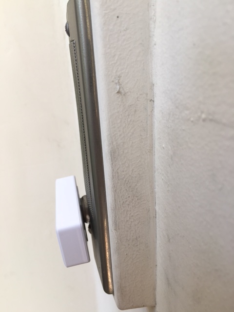

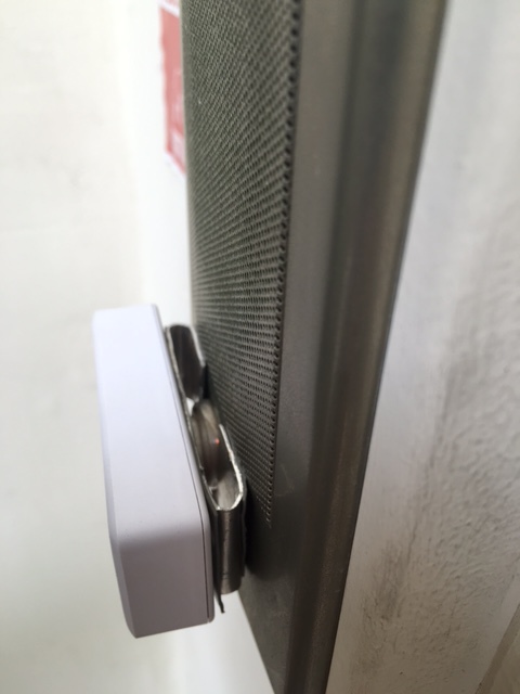

The problem is that there is a square cutout on the back of the doorbell right in the center. I stretched a piece of 3M VHB tape across and stuck it on. It held, but somewhat flimsy as it was mostly tape and no hard plastic making contact.
I went to home depot and bought a thin piece of sheet aluminum for 2 dollars. I cust it with sheers and bent it to make a bracket so that it would have surface area for the tape to stick to. It just barely covers the existing button.
Only the 2 gig rings which is OK. I can still use the intercom and I have 2 extra TS1’s so the chime goes through the house.

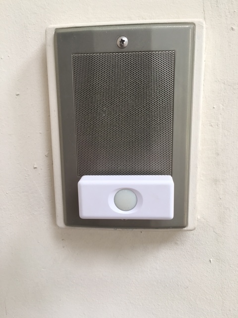

Also here is the after front view picture
