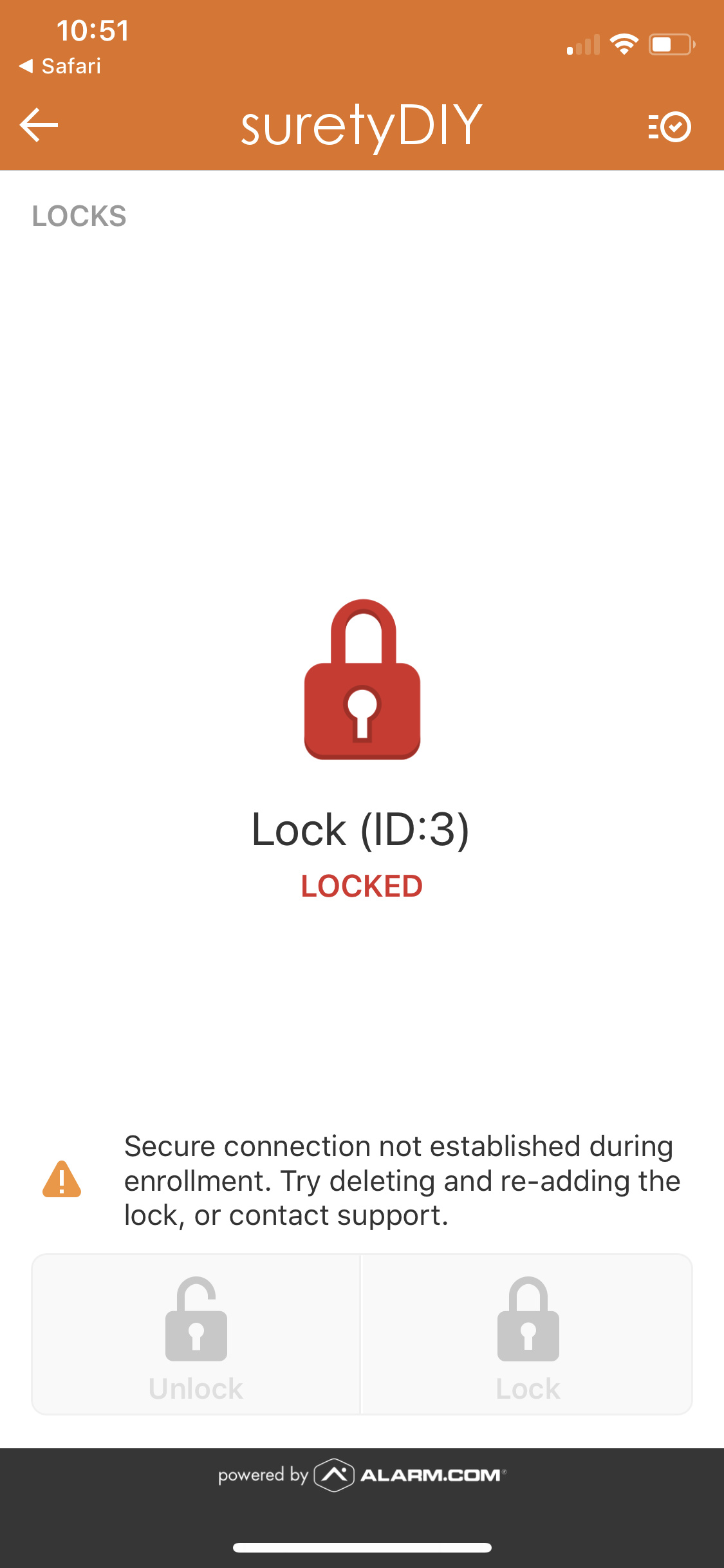

Yes Jason , I have repeated the procedure you describe several times and get the same result secure connection not established during enrollment, I have repeated the steps you described several times, it would not work for adt either. I’m assuming once these locks get programmed to a vivint sky panel , vivint somehow renders them useless to be enrolled to another panel except their own??? I know they use proprietary sensors and equipment now, such as DW 11 sensors and GB2 glassbreaks, could they have blocked it somehow?? I’m glad I’m not alone in this

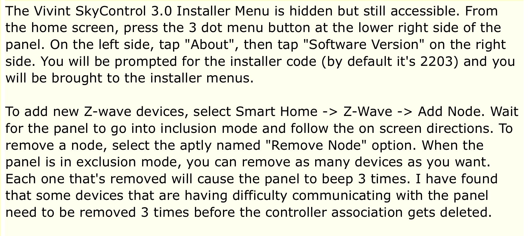

Apparently in newer firmware Vivint has made it harder to get to the installer toolbox. That’s why I could never find out how to remove it without resetting the panel. I finally found the info attached. Hope that helps anyone else having this problem in the future!

I was able to finally figure it out after all this time , I had given up lol. Just an fyi vivint has a antitheft feature built in panel for lock making it useless with any other panel unless you remove it completely from vivint sky panel. I had to remove it , then re enroll in sky panel , then remove it again from sky panel, that was the trick , my lock was able to successfully enroll in my new panel???
