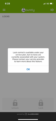

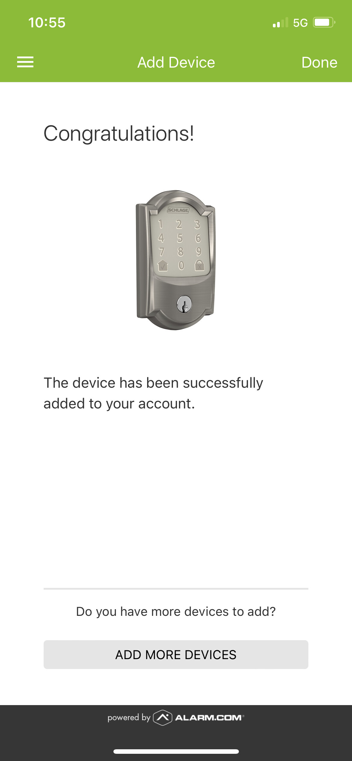

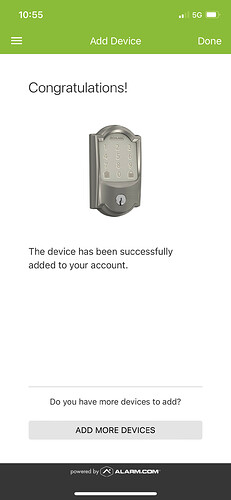

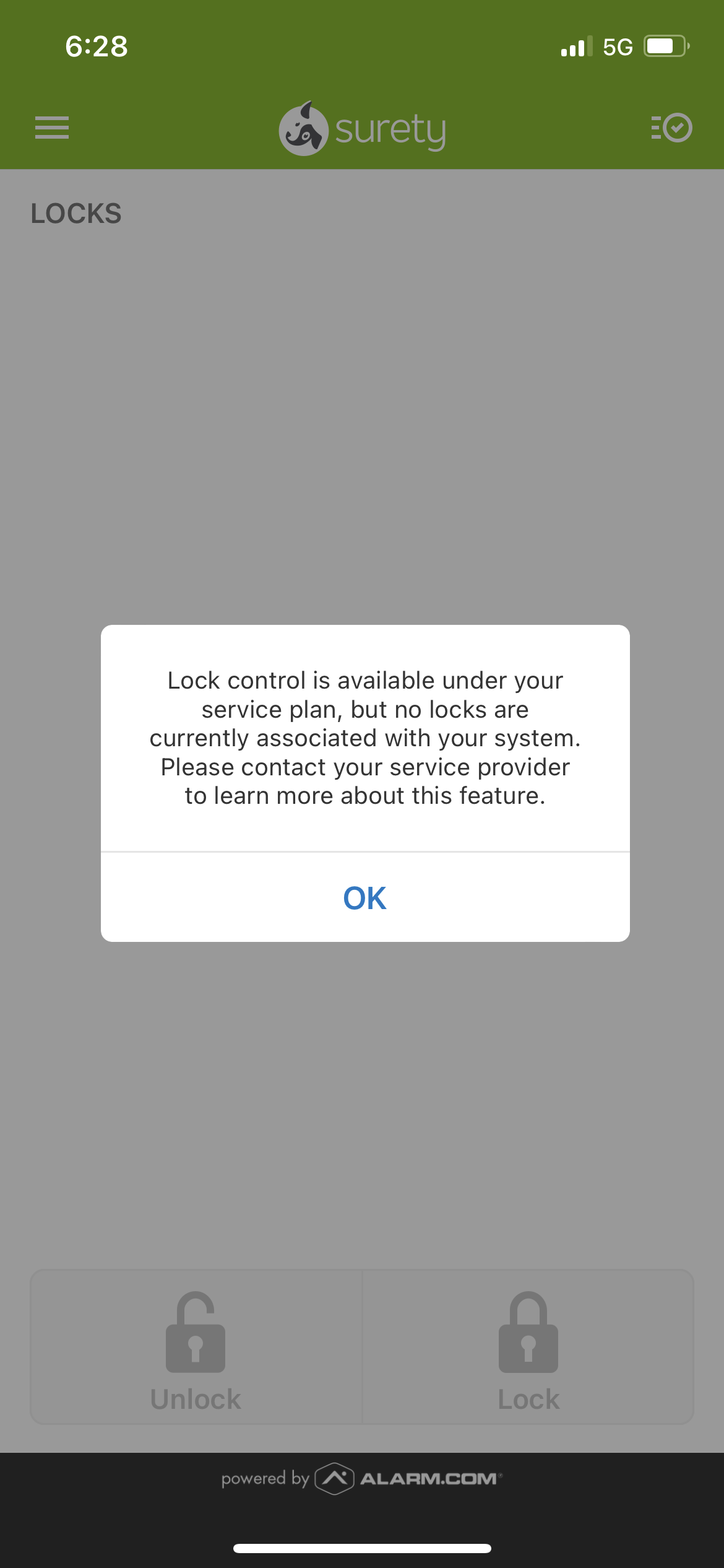

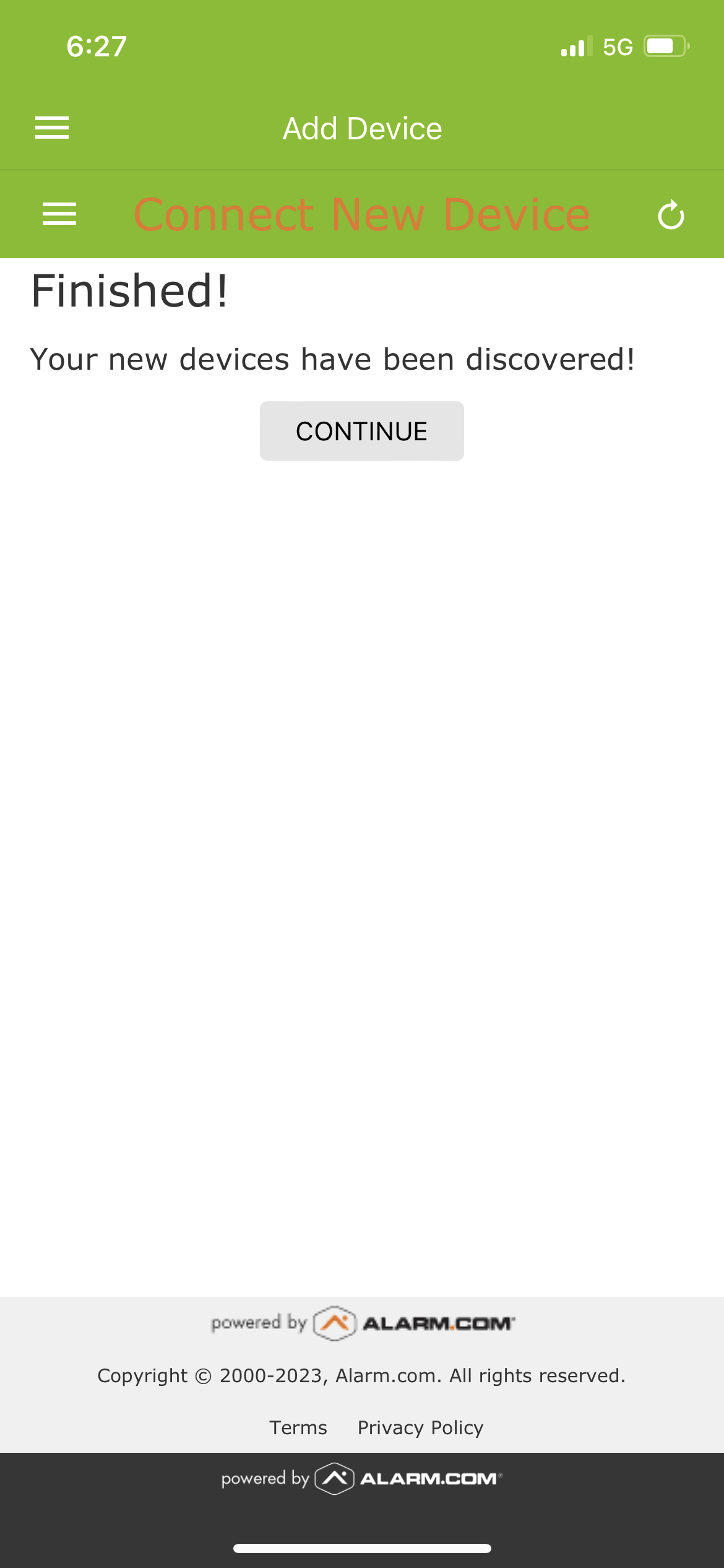

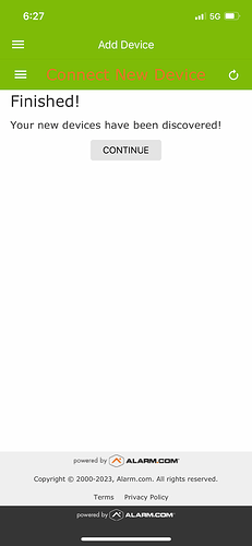

I’m having issues connecting Schlage Encode locks to my alarm.com account. Tried several times adding and deleting without success. When I go through the process I get the confirmation that the lock was added but nothing shows up on alarm.com. I contacted Schlage support and they are pointing fingers at alarm.com being the problem but are unable to provide details. I added some screenshots of the “successful” device confirmation and the error I get when going to the lock section on alarm.com. Any ideas on how to resolve this?

When I look at your equipment I can see that a Schlage account link is there, but there are no reported devices.
Thanks for the quick response. I checked the model number and it looks like I have the newer 499 models. So I guess that’s the reason why it’s not working. Will support be added for these in the future?
I cannot confirm 100% or provide an ETA, but if it can be I would expect so. I am guessing the direct Apply Home Keys integration or related changes may be the roadblock, but that is a guess.
Schlage Encode Plus (BE499) is supported by Alarm.com now.
