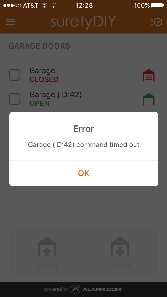

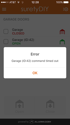

I have finally gotten around to do this. Upgraded firmware on the 2GIG panel and was able to pair the garage opener (ID42). However I’m having mixed luck with operating it. What I get a lot of is time outs when sending close/open commands from different iOS devices with the newest alarm.com app, whether on WI-FI or on cell network. Attached is the screen cap.
Logs on alarm.com don’t give me much granular detail. How would one go about troubleshooting it?
