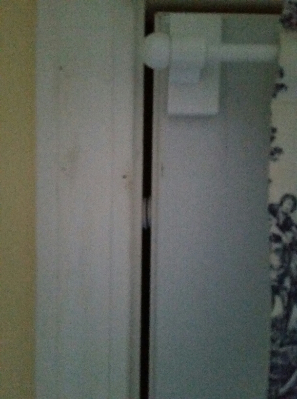

If there was no physical presence at the door, we could explore the possibility of the door or magnetic rod interfering. Would you might posting a photo of the sensor as it is installed and the door is closed? We can probably tell pretty quickly if it might be the culprit.

Magnetic interference or the sensor at the edge of its magnetic gap along with slight door movement can account for this. Can you post an image of the sensor as it is mounted to be sure?
The big white rectangle has a magnet underneath. It is a steel door. Alarm has been installed for about 2 years and this is the first false alarm we’ve had.
The time it has been installed can be a bit of a trap, because lowering battery levels can affect signaling and the metal door can affect signaling for recessed contacts, as well as affect the magnetic gap. Is the magnet in the door or is the sensor in the door?
Sensor is in the door, there wasn’t enough space between door jamb and bricks to put the whole sensor length into the jamb side. The sensor is about 15 feet from alarm panel. similar metal door install in basement, which that door is on another floor of the house and about 30 feet away (never any basement door issues).

As this sensor is installed in a steel door, you may need to replace your battery more frequently than other sensors to ensure optimum signalling. This would also depend on usage.
If possible, you may wish to move the curtain rod hook away from the sensor as much as possible to ensure that the magnetic base does not affect signalling.
