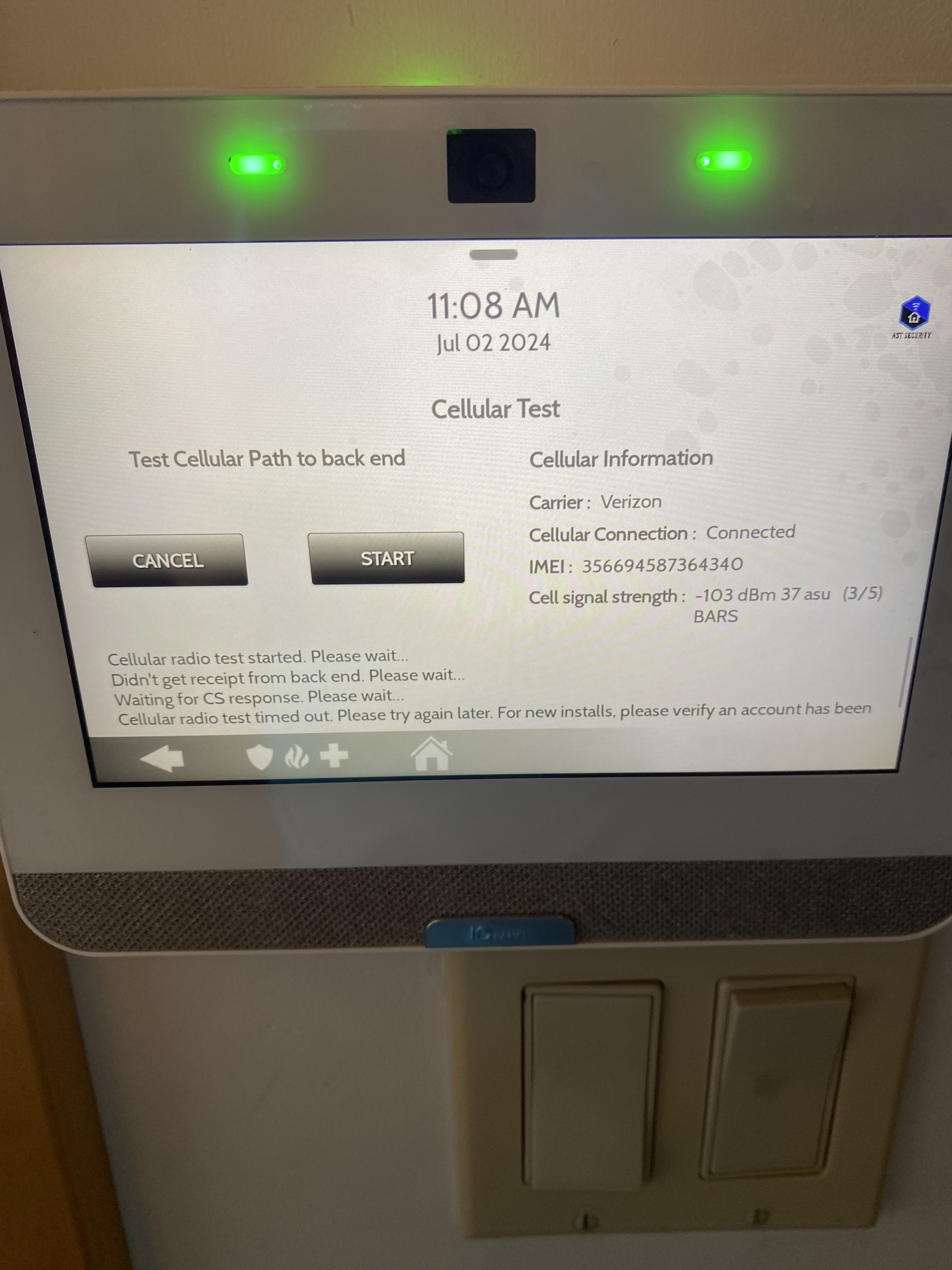

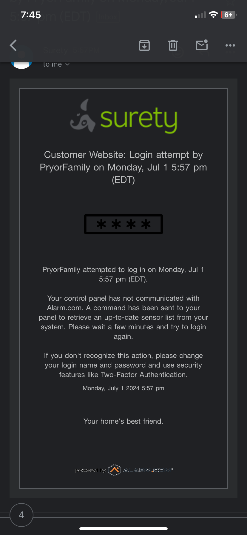

I have everything setup that I believe should be set up. But when i attempted to log into alarm.com I get a email that my panel hasn’t communicated with alarm.com and it doesn’t let me sign in. I factory defaulted the panel once but it didn’t do anything. Then i called the central station to see if they were getting any signals. They weren’t receiving anything but there’s no troubles on my IQPanel4 at all besides it won’t pass a cell test.
The login limitation is normal if the panel hasn’t communicated yet. I do not see any response from the panel in your history to anything sent through ADC. There have been no successful cell tests.
The first thing to do when this is occurring is to power down the system, leave it off for about 20 minutes. This will force address a few potential causes of cellular connectivity issues.
After 20 minutes power up the panel, let it boot up and wait a couple minutes, then run a couple cell tests. Any change?

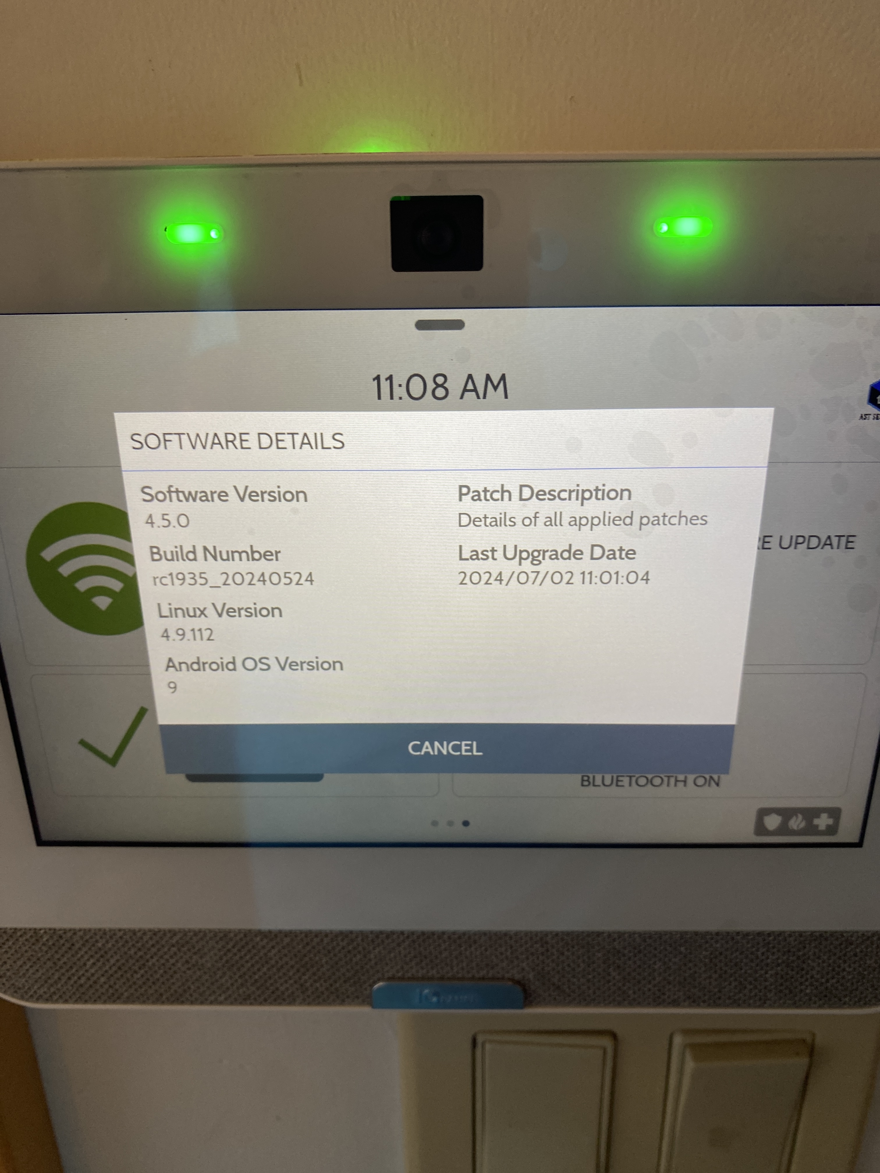

Leaving it off didn’t help anything the firmware is 4.4.1 and yes I can connect it to wifi
Next, update the panel to the latest firmware, 4.5.0. Instructions are listed in the link below, including the necessary patch tag.

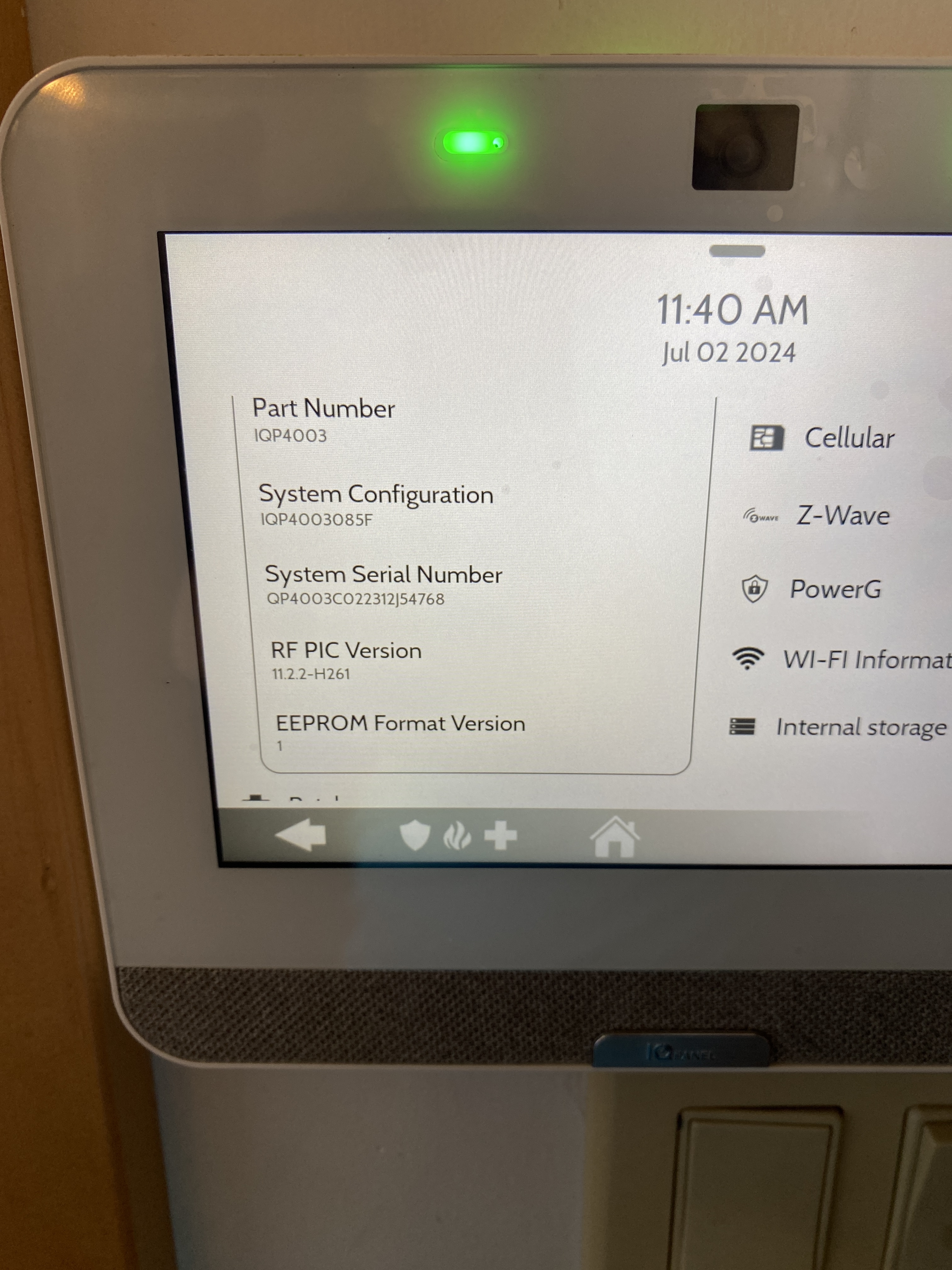

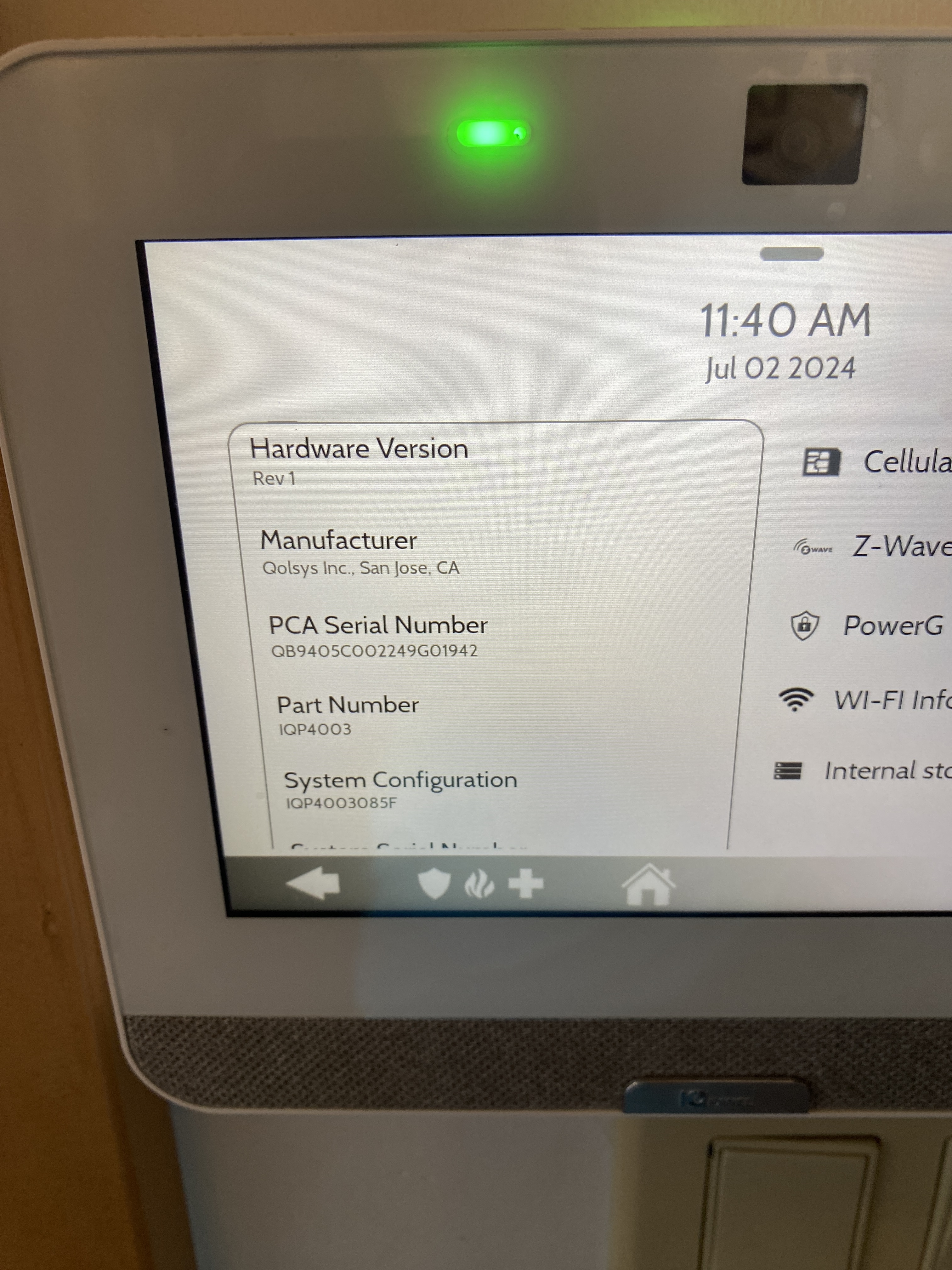

Hmm, some of the Alarm.com account data on this IMEI is odd. So that we can best assist, can you please confirm the exact model number of this panel?
Can you provide a photo of the hardware section of the about page?

- After reboot, wait 5 minutes, re-run cell test. Any Change?
It didn’t work and yes there are door sensors programmed it has never been used with alarm.com previously
