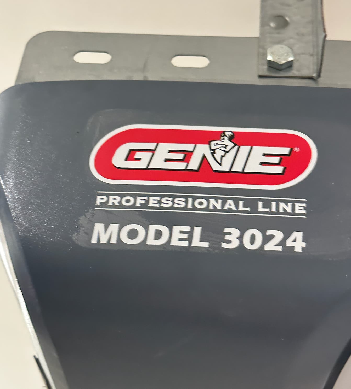

The Linear Go!Control Garage Opener in the picture is a Z-Wave device that allows for remote control of the garage, it will also have a matching black tilt sensor mounted on the door to track open/close status. You may have two separate sensors on the garage door.

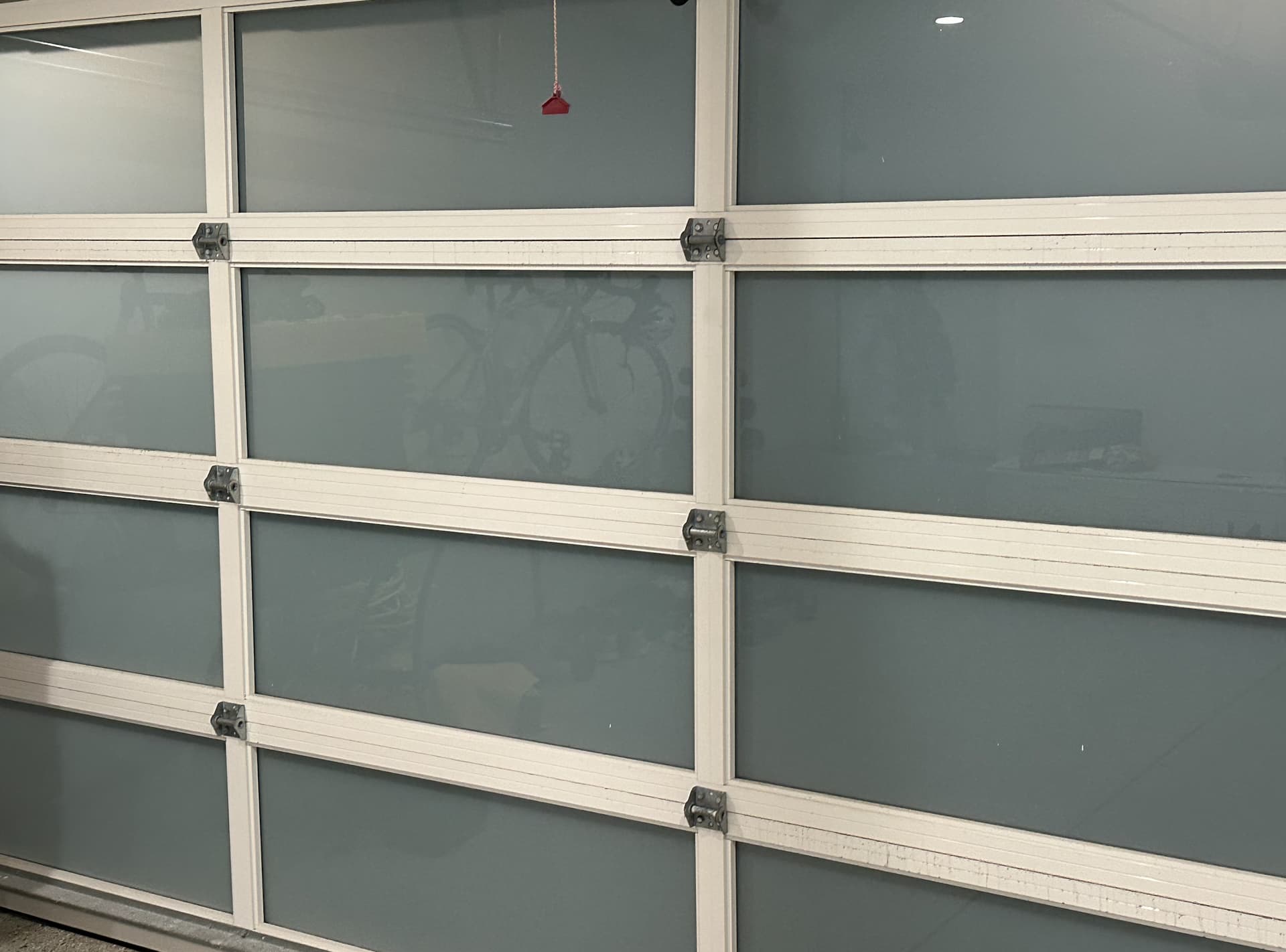

This is a potential sensor, I don’t see other sensors on the door except the typical lower sensors that are a part of all doors:
Left sensor (shows red):
Right sensor (shows green)
The app does show the garage opens / closes when you trigger it to do so.
Thanks

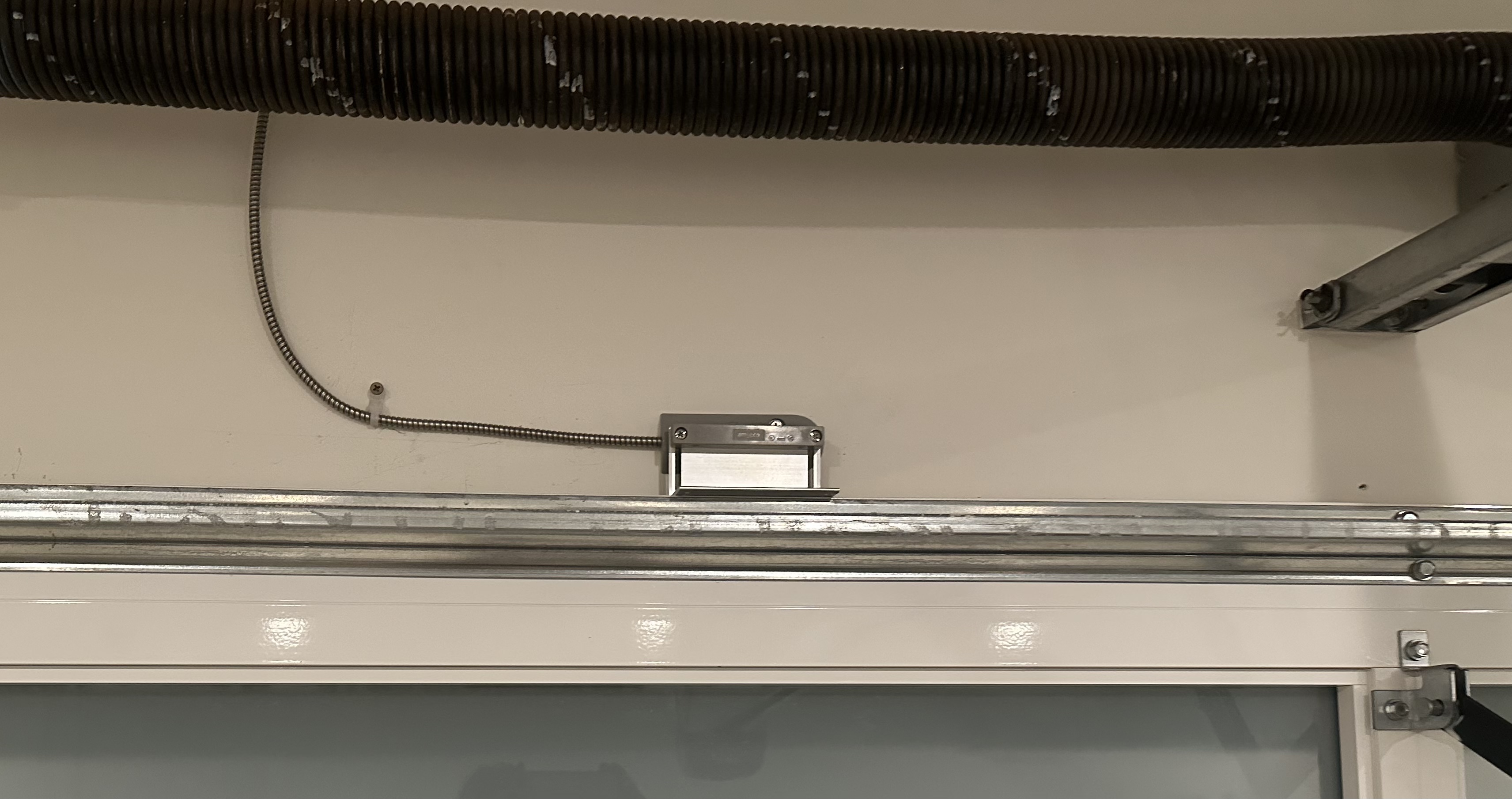

The device at the top of the door is a wired sensor and magnet. That is likely it, but you would also have either a wireless sensor nearby connected to the other end of the wire to act as a transmitter, or it is wired to a Hardwired to Wireless translator box somewhere.
Can you provide a photo of the other end of that cable coming off the sensor?
Usually those wired garage door sensors like at the top of your door have a wide magnetic gap, but I can’t tell how far away the magnet and sensor are from that image.
If the door does not close fully or if heavy wind pushes on the door and the upper panel can move a bit false open events might occur.
The problem may also or instead be at the transmitter end so a photo of that device and the wiring would be needed.

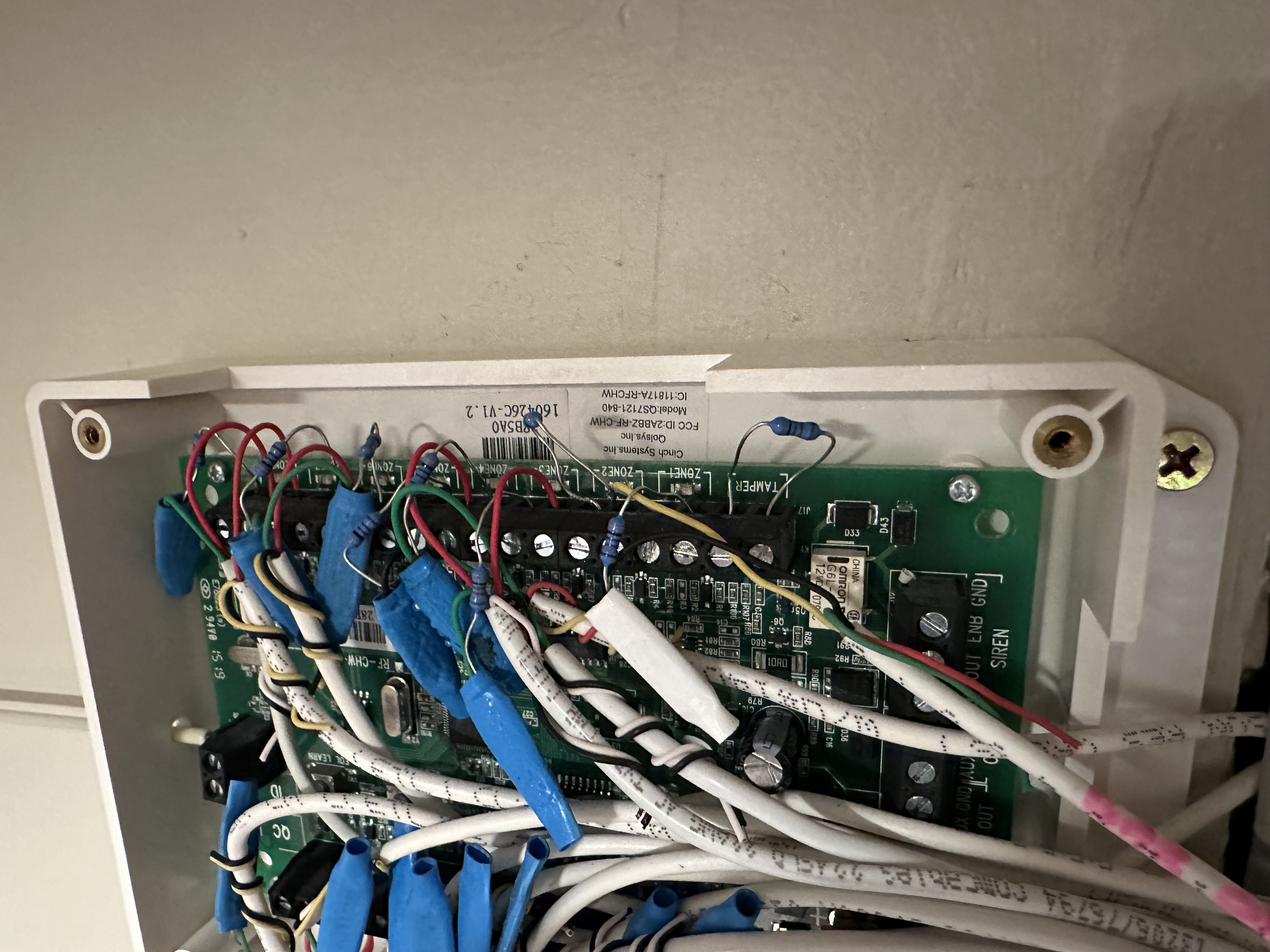

Can you provide a photo of the inside of that wireless sensor that the garage wired sensor is connected to?
It is wired here:
Can you confirm which zone terminal it is connected to and provide a closeup of that zone wiring? Double check by giving a little tug on the wires to make sure it is not loose.
Hello, I’m not actually sure how to know which wire is which. He said he switched it do a different one so the one written down (2) is no longer accurate I don’t believe.
Based on programming it appears to be using zone terminal 1. Try testing that zone terminal by removing a wire, does that open the zone?
Check wiring to be sure there is nothing loose. Also be sure that the wire sheath on the individual conductors aren’t accidentally cut or scraped down to bare wire, as that can cause a short on the circuit if the resistor or two wires connect, which would show a tamper.
