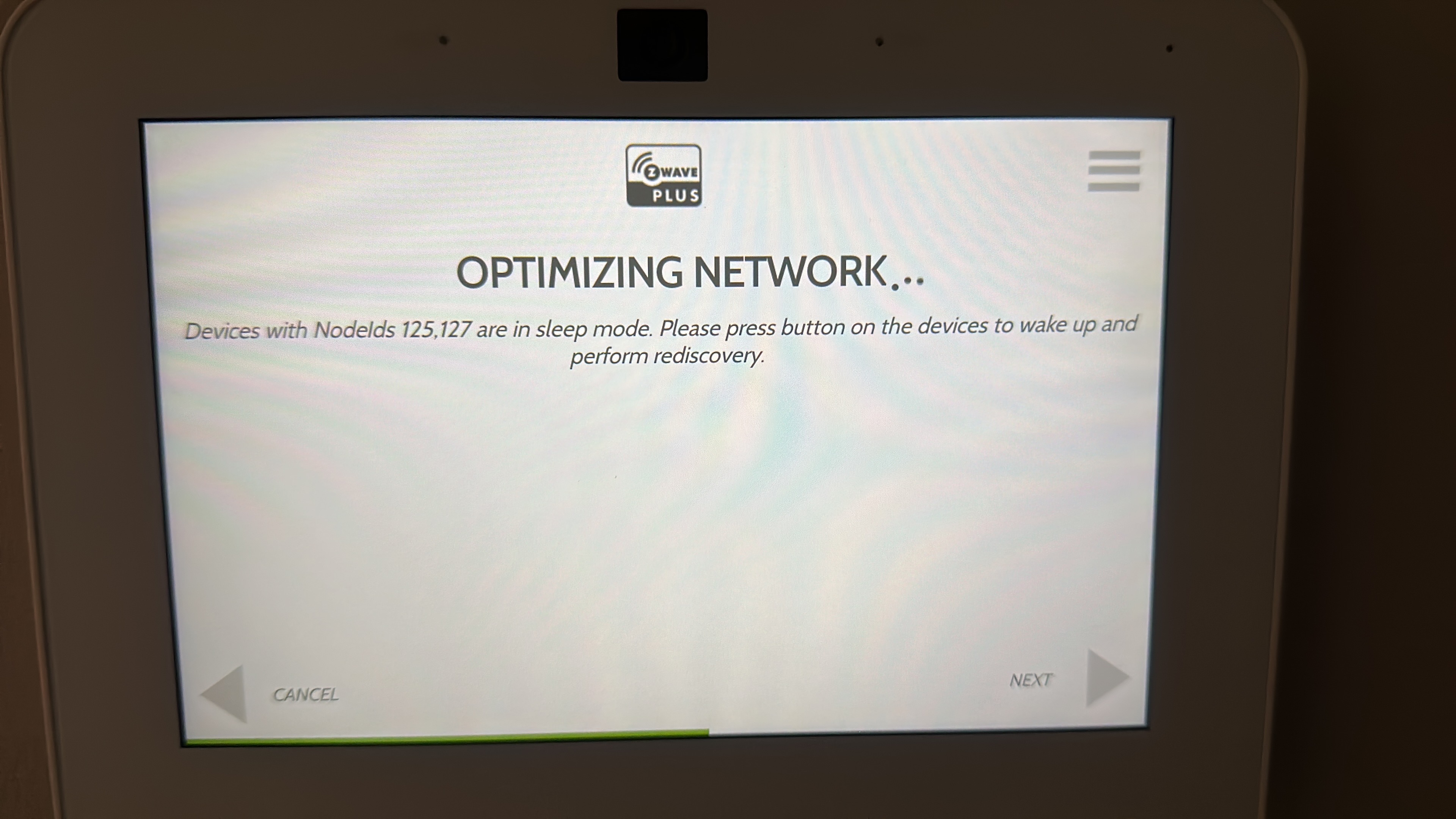

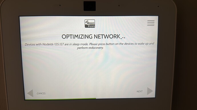

I try power down the system for extended time, removing battery power at same time and restarting system with “optimizing network” during start up and left it on all night with out changes. Just suck on that screen.

The temp sensors will not participate in rediscoveries.
It looks like the main issue is that the panel was waiting for responses from the temp sensors, but this would never occur. You can tap the button on the side of the temp sensor to wake it up, but it will not communicate a response to network rediscovery.
I do not see a node 125 on your system, was that deleted and relearned?

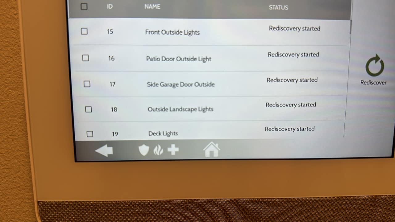

Hey Jason I did delete that sensor. As of this morning panel was still acting up. I understand about temp sensors and yes I always push the button to wake them up during discovery. This has all zwave devices showing in my picture stuck in forever discovery, they never come out of it. Has been like that for two days now. I’m not home but will call my son to see if it changed since you send command from your end.

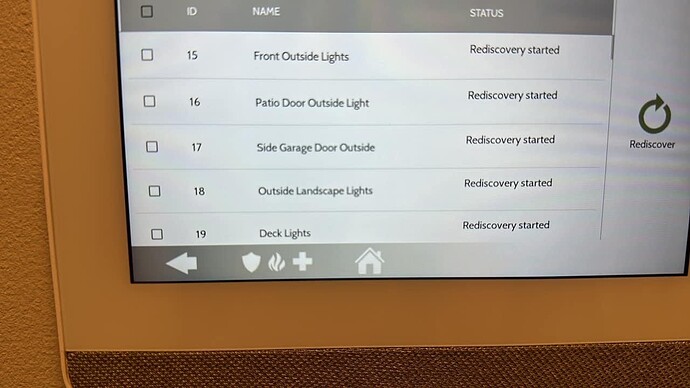

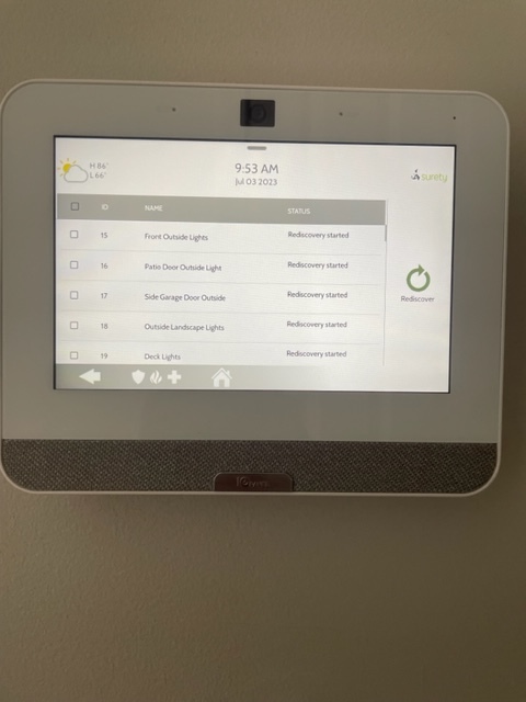

@jwcsurety no changes please see picture bellow panel still showing “discovery started” on most Zwave devices.
Let me know what the next step would be? I personally think is a bug in the qolsys firmware. Never had this issue until to 4.1. I had this happen few times lately on one or two devices. no big deal remove them and repair and you good but now I have it on all my devices. Not looking forward to remove 40+ z-wave devices.
Which ones do not show that?
Looks like at least 7 should have responded. ADC shows a new rediscovery date for all the devices, but it looks like there was a successful response for 7 before the rediscovery failed.
Can you confirm all the node IDs for the devices that completed rediscovery according to the panel? That might help identify what is going on.

I’m not home but that sounds about right. 7 are completed with discovery and the remining are all suck in rediscovery mode. Once on the pictures I have in that post for sure are still showing in rediscovery if you need some nodes #,that picture was send to me by son this morning after you send rediscovery signal. I did try to call him again to confirm exact # of the nodes but he is not home.
