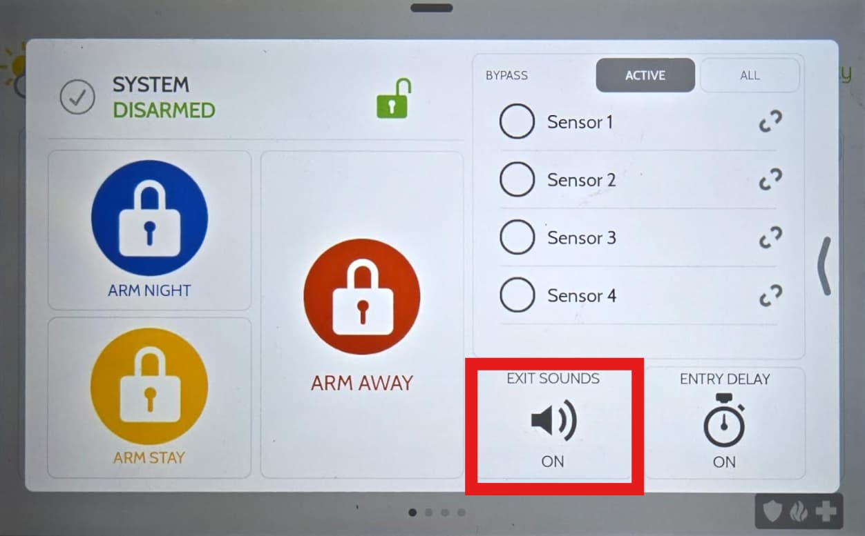

To perform a silent arming, press the green lock to arm the system then press the arrow on the right to show all of the arming options. Make sure Exit sounds is set to off. Then try arming the system.

You can see the Exit sounds option in the picture attached with the red box. Make sure it is off so that when you arm the system, it doesn’t have the exit beeps.
That’s not at all what my panel looks like that and the setting for quick exit beeps is in the sounds setting and set to be disabled.
