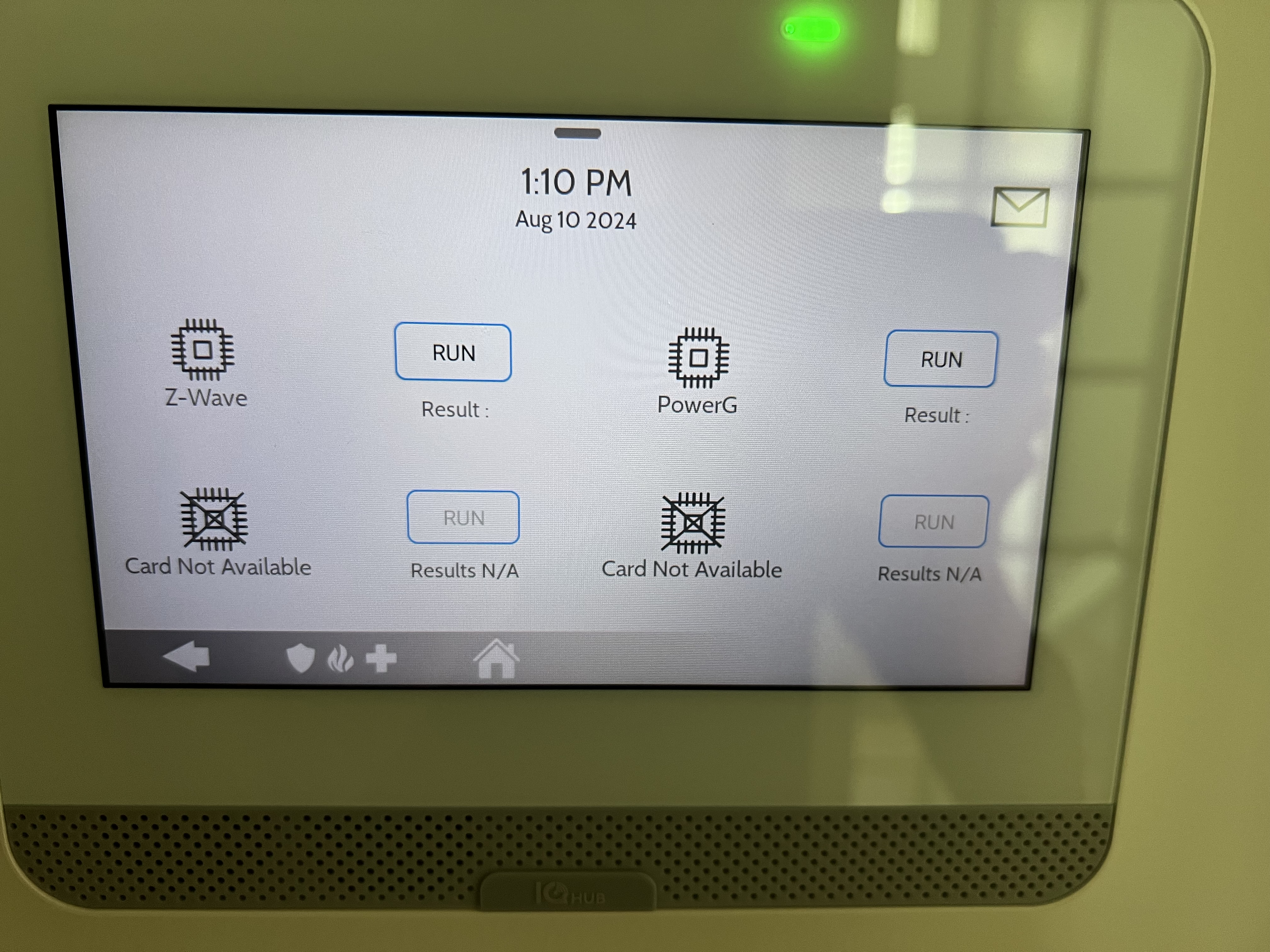

Sorry I was traveling all week and just getting back to this. I am now confused slightly. I got home and am confused on what daughter card frequency I have(if any). When I go to settings, advanced settings, system test, daughter board I only see Z-Wave and PowerG. Does this mean I don’t have either 319 or 345?

Sorry think I was misspeaking, it looks like it’s a hub. The model number is IQPH054
Yeah that’s the PowerG-only model. I’m not sure but you still may be able to add a 345 MHz or 319.5 MHz daughter card to it. Is “slot 3” available on your hub?

Are you suggesting to see physically if slot 3 is available or through the GUI? GUI states only two cards(see attachment). I can pull the unit off the wall and check if that’s what you’re suggesting, just let me know.

That’s up to you. I just think I’ve heard that you can add the card to the IQ Hub. But not sure. I don’t have a Hub. Maybe check with support before ordering.
I pulled the unit off and it has a spare spot labeled “Slot 3” and the documentation on qolsys website states that it’s compatible so I will give it a try.
Thanks again!
For anyone interested this worked perfectly! Put the 345 card in(Didn’t have a card installed in slot 3 previously) and used the FF1e-345 combo unit.
