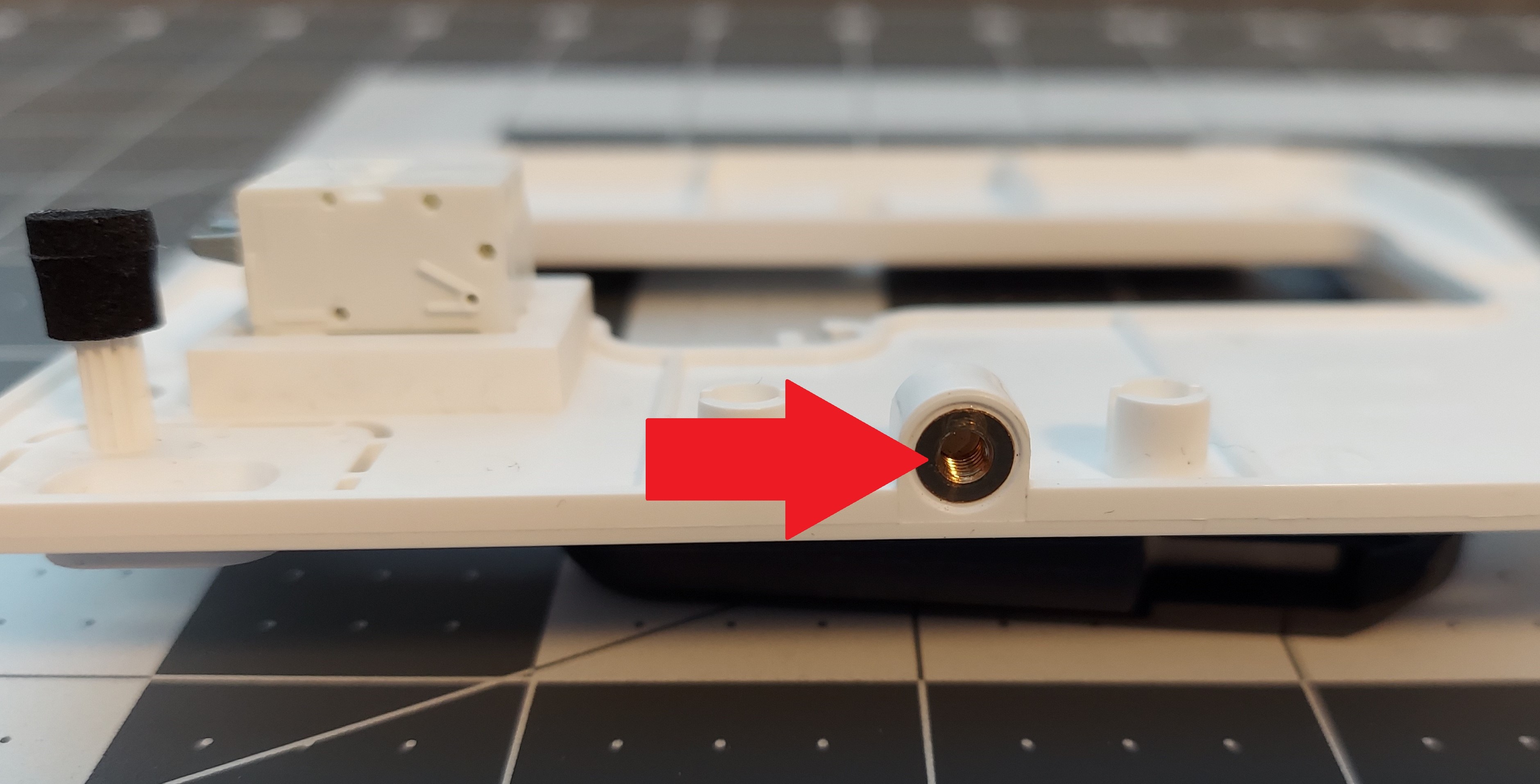

Any tips on getting this screw with the spring to catch? I cant get it to catch and have spent and incredible amount of time on this
The backplate should tab in at the top of the panel cutout first, then seated all the way into the cutout. The screw hole on the back palte should line up with the set screw at the bottom.
If its not catching, make sure the back plate (or stand) is lined up properly. Make sure the back plate has the metal insert in place for the set screw to catch onto as well.
The set screw with spring has some play when not screwed into the back plate fully so you’ll need to line it up with a screw driver a bit before screwing it down.

I finally got the screw in and its not easy at alll
When in place on the wall it requires precision to be sure. Happy to forward feedback. Luckily once it is installed, the IQ Panel is designed to never really need to be reopened.
