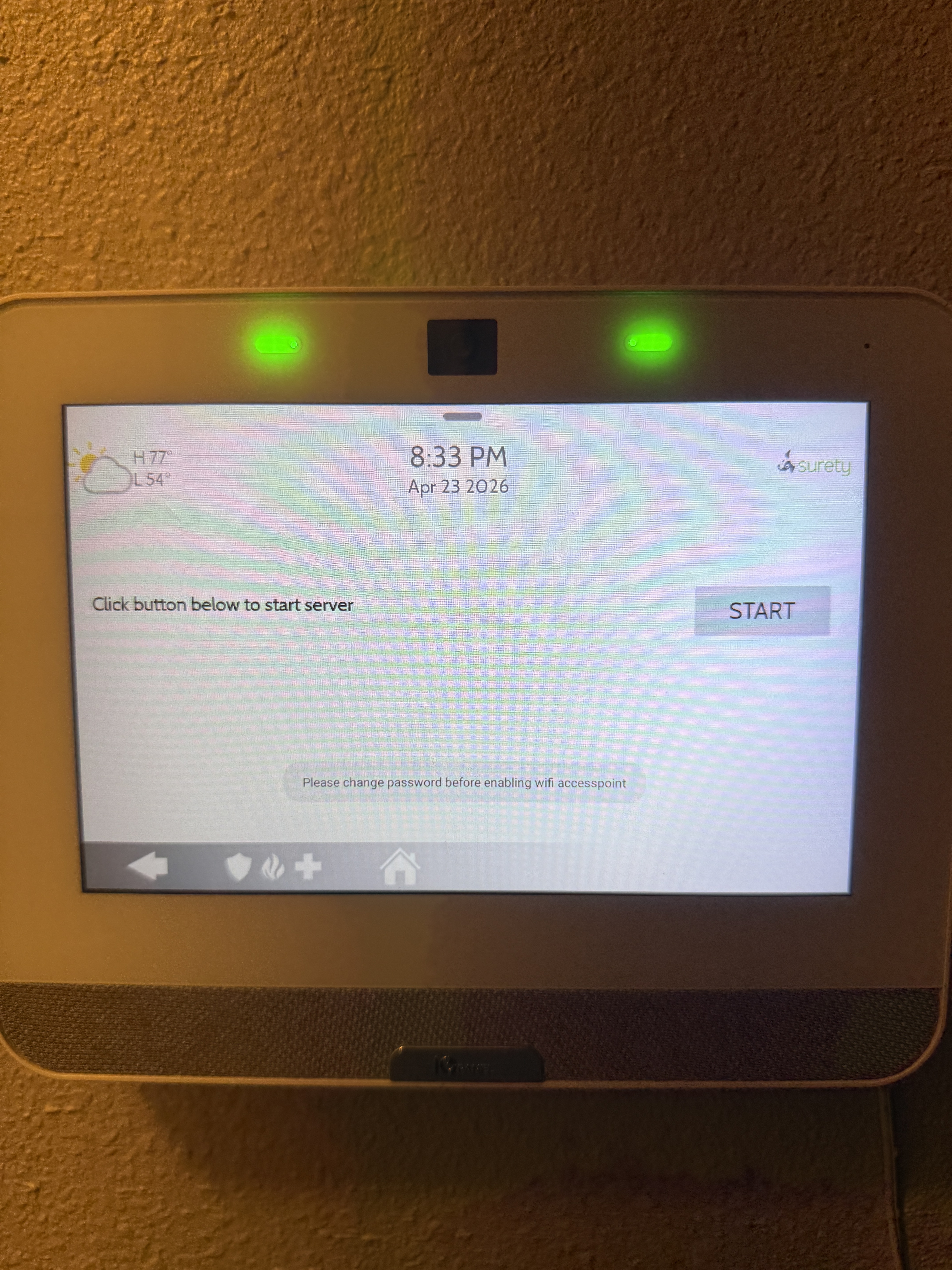

Iq4 panel access point
why does my iq4 panel say this? and how do i fix it?
Swipe down > Settings > Advanced Settings > Enter Installer or Dealer Code > Installation > Devices > Wi-Fi devices > Access Point Settings > Enable Wi-Fi Access > Change Password > Create password and confirm then save > You can disable the Wi-Fi access point if you’d like and now you should be able to enable the server
