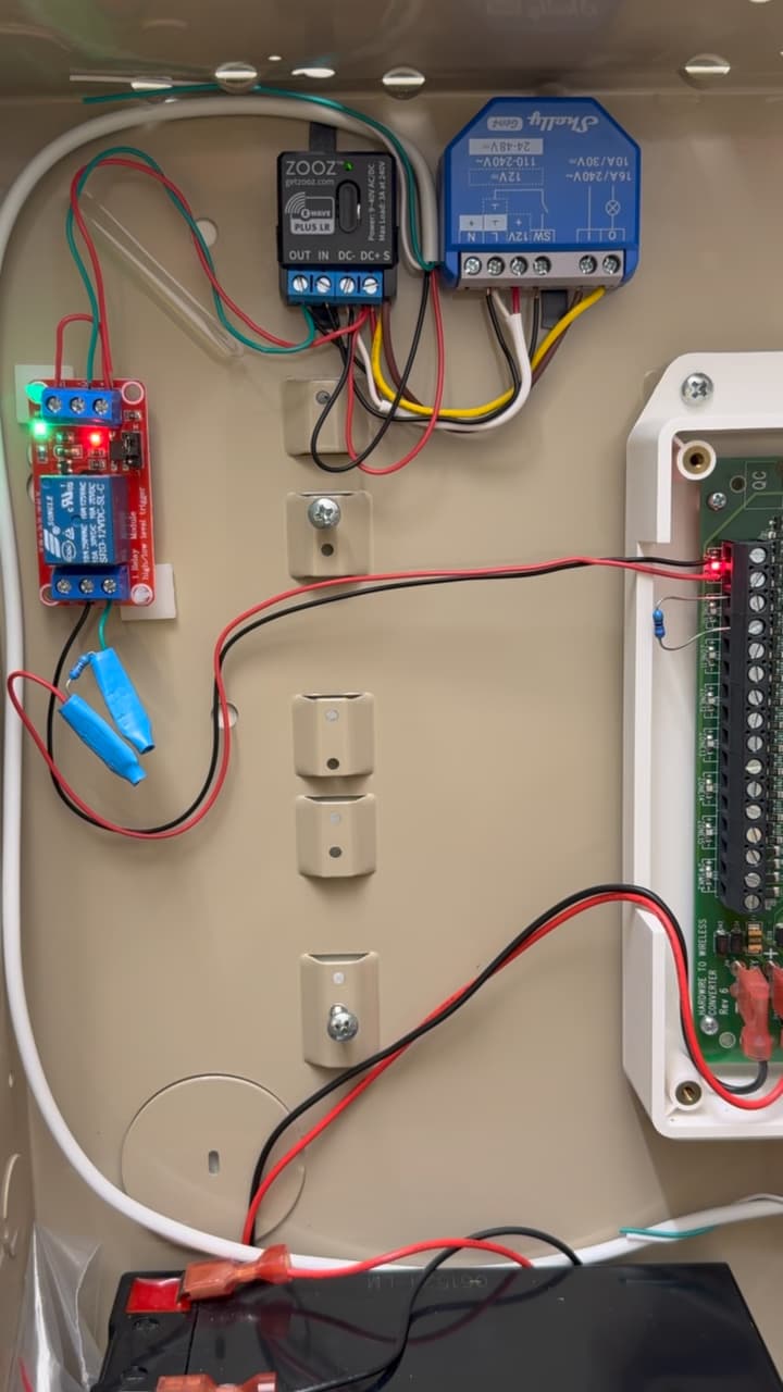

Yes - only a few weeks old. I was lucky to put it through the testing regimen here in the lab and have one in production at this point. The direct association capability/compatibility in the IQ 4 and the fact the switch input works as a remote in ADC is really its killer features. Really like it so far. Here’s a pic of it living in my alarm can happily relaying and establishing scene control between ADC and Home Assistant!
(Sorry if slightly off topic.. I’m nerding out over here… I have video and schematics available if desired…)
