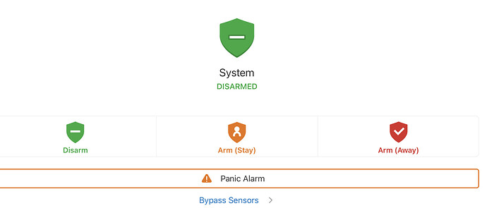

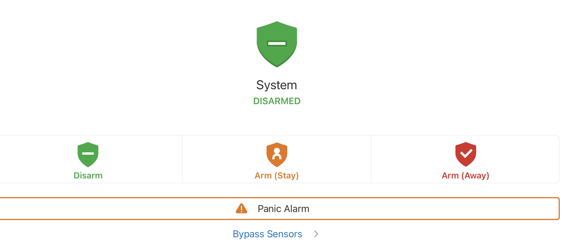

My alarm.com security system screen shows an error for panic alarm (but not master bedroom panic alarm) and won’t clear despite me putting in fresh batteries
No messages or alerts on iq4 panel settings
No error messages on ADC Home Screen but only on System Screen
The Master Bedroom Panic Button low battery condition was resolved according to panel reports to ADC. I’m not seeing any active trouble alerts.

Once again, had to change the batter on this panic button. It alerted low battery. The low battery alert won’t clear. Pulled battery and waited 2 minutes. Resinserted. Didn’t clear. Rebooted panel. Won’t clear
It takes about 2-3 hours for it to go away . Ironically it was the same sensor. Posting this so the solution comes up in searchers. Just have to wait it out for panic buttons
