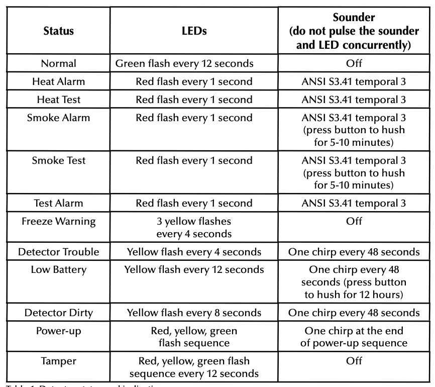

Two of the IQ Smoke (QS5110-840) keep beeping with the light flashing yellow every 45 seconds or so. I replaced the battery but does not help. What could be the problem?
Below is the status chart from the manual. The timing of the flashes will tell you the underlying issue. What does the behavior match on the chart?
I think it’s detector dirty. Could you give me the instruction on how to clean it?
