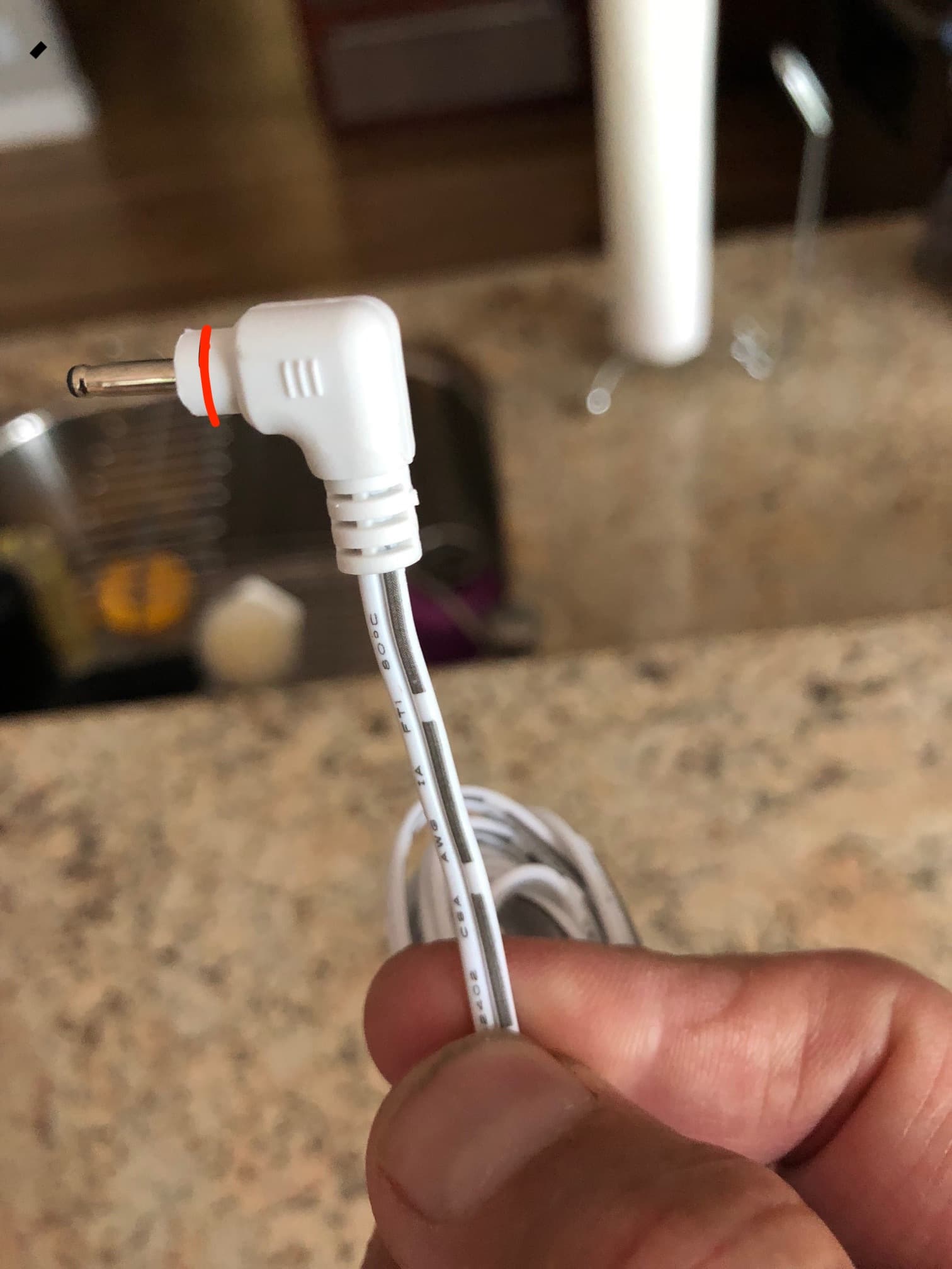

Additionally, sometimes, the barrel connector housing on the IQ Remote needs to be trimmed back a bit, to reveal more of the barrel connector to make better contact. See this image for reference:
When trimming, ensure the power supply is completely unplugged first, before proceeding.
