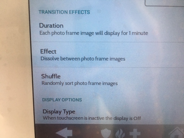

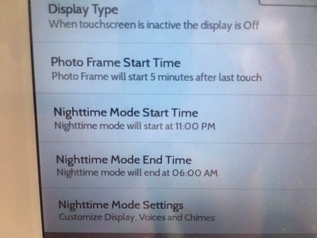

I’m happy to pass along the issue to Qolsys. Can you submit a photo of how your IQPG is currently set up in Photo Frame Settings?
Navigate to Photo Frame > Settings and take a picture of all of the settings as they currently are. You can submit them here or to us off the forum at support@suretyhome.com.
yes.
Can you please provide the rest of your settings?
Thanks again for your assistance.
Thank you for the images, I have reached out to Qolsys to see if they have any recommendations and will follow up here once I have heard back. Based on the images received, the test panel I am using is on the same settings.

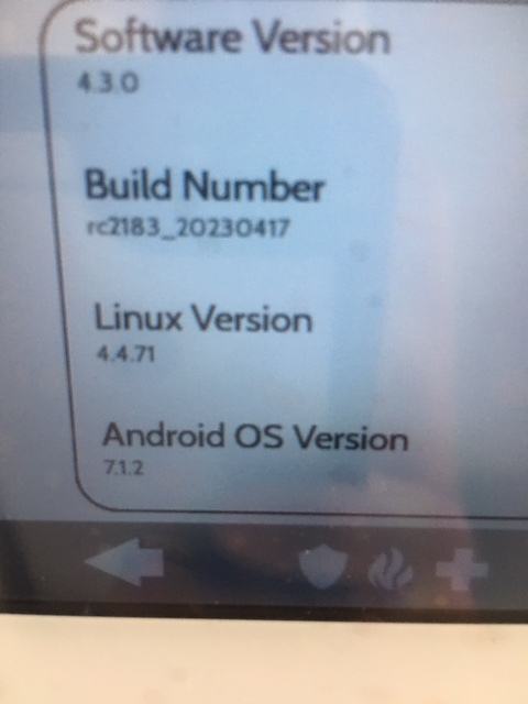

However, this ticket is pretty old and the issue may have been resolved via firmware. What firmware is your main panel and IQ Remote on?
Hard to say. The remote panel will not stay on for more than a few seconds as the battery apparently needs to be replaced. Remote powers up but a window pops up stating it is powering off before the system fully comes up.
I will need to check the main panel.
