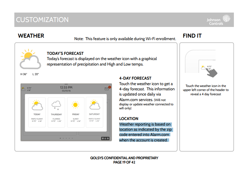

From the manufacturer, weather is available during WiFi enrollment, which is why it was encountered during this time.
Weather information is pulled from the zipcode on the account through Alarm.com. I have confirmed the zipcode for the panel programming matches the one on file.
From previous discussions, with Firmware 4.4.1 there has been some troubles with weather that have been noted.
