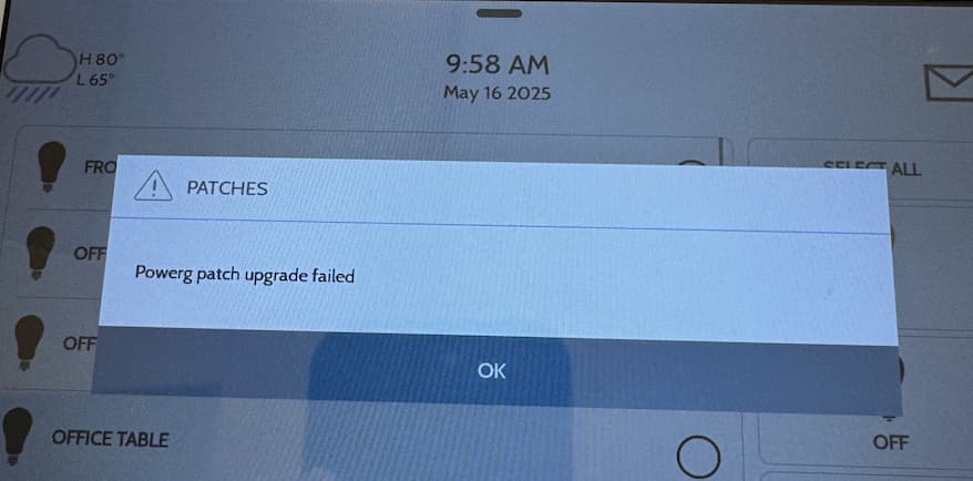

But a few minutes later this error popped up on screen on the remote. And keeps coming up every few minutes
“PowerG patch upgrade failed”
I also tried manually doing the IQremote PG Upgrade and it fails as well
