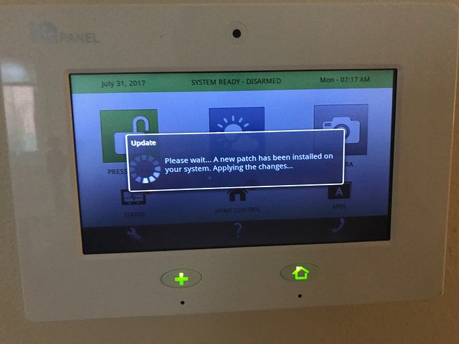

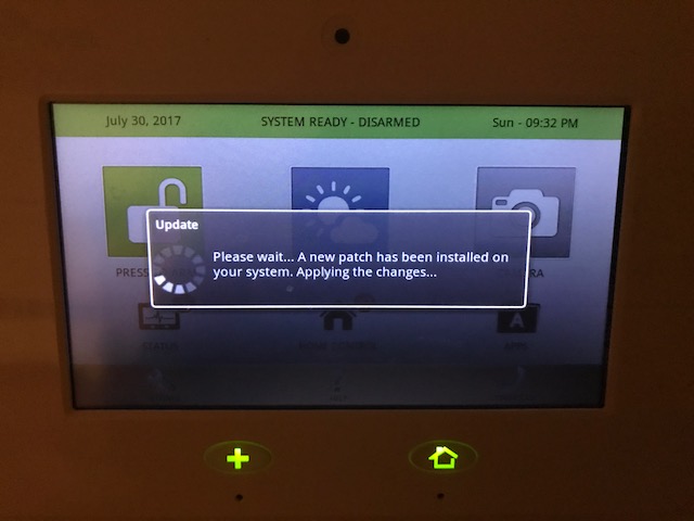

Hey - I’ve been using my IQ for a while and this afternoon I ran the network software update. It looks like everything went well and the panel restarted.
Now it is saying
Please wait... a new patch has been installed...
And it just sits there. I’ve restarted the panel and it simply goes back to this message immediately upon booting.
How can I get around this?
Please see attached. This is the second time a qolsys update has prevented me from using the system.
I’ve restarted a total of 6 times over 4 hours.
An extremely frustrated customer.
I gave things another 10 hours straight without any intervention. No luck. It does appear to update the time every 30-45 minutes or so.
The panel is completely non-functional in the interim. Alarms are not triggering, door openings aren’t being logged, I can’t arm the system, nothing.

It looks like the panel is reporting a non-standard firmware, which may be indicative of a failed install. We will send this to Qolsys to be sure.
Qolsys firmware downloads come directly from their firmware server. We can have them check to determine if the download was not successful based on some panel diagnostics, however it would help to know some information about the circumstance:
What firmware version were you attempting to install? Did you use a patch tag or just “Upgrade using network?”
What was the firmware version you were on previously?

How long did you wait between the first time the panel rebooted into this message and then attempting to reboot the panel?
How are you rebooting the panel?
I waited a bit over 3 hours before attempting to reboot (the time in the upper right hand corner was frozen). I held down the home button for 30 seconds and it rebooted and went right back to the same message.
The unit does attempt to reboot every 30-60 minutes on its own. Lights turn red, the system reboots, and then same message.

If the panel was left alone for 3 hours after the update there is no reason to think that it was interrupted. Did it reboot on its own during that original 3 hours?
Using the time in the upper right hand as a surrogate (it never moves in real time and only updates on reboot despite the dial spinning), it’s been rebooting on a cycle every 30 minutes or so since yesterday.
