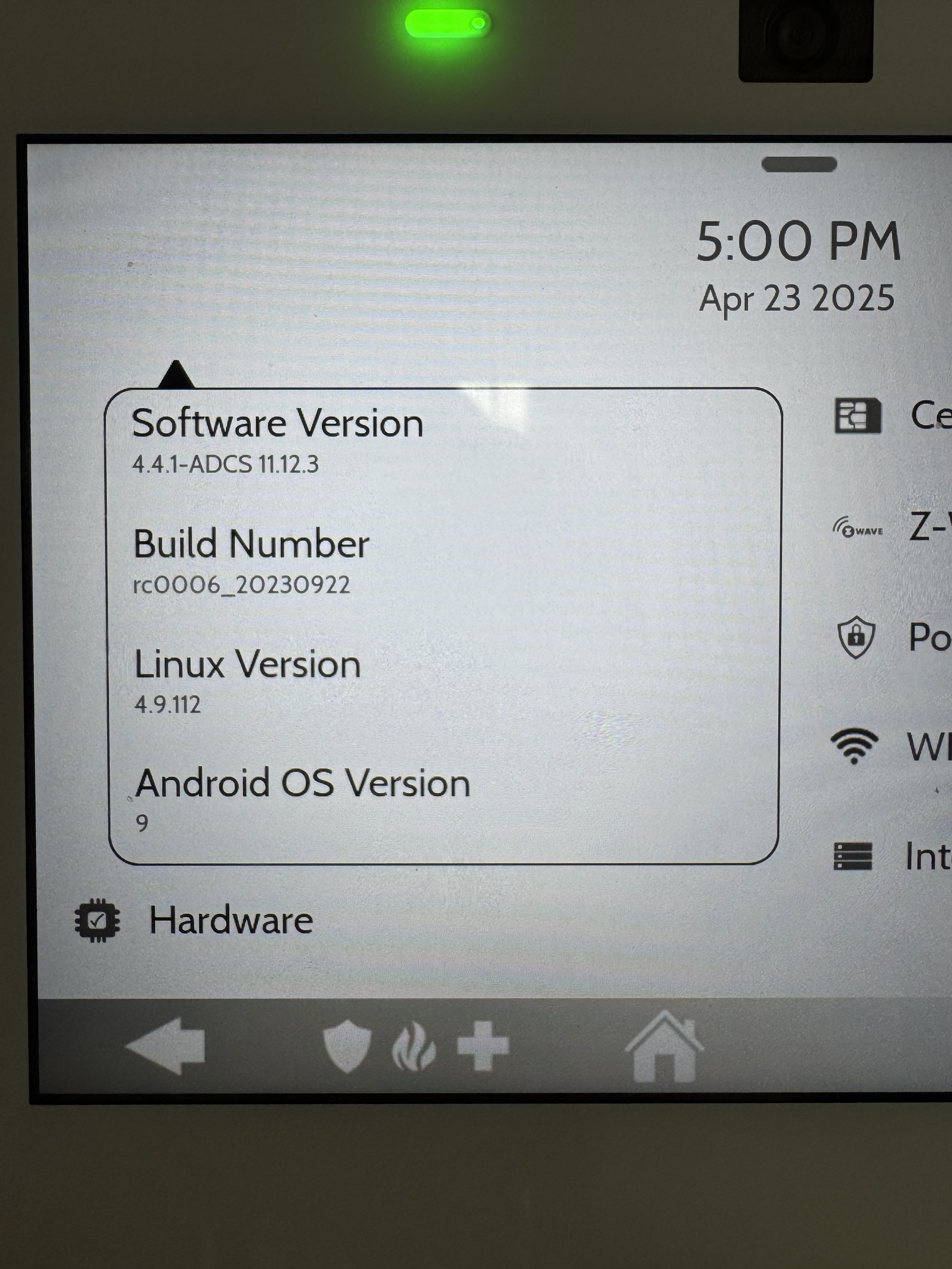

What software version is your panel on?
Qolsys mentioned to me this is something they see on older software versions. You can try updating to the latest version. Depending on what version you’re on, you may need to update by increments. Instructions to update are on each of the firmware release update. Make sure you follow the instructions by writing in the patch tag.
No software updates are showing available when I navigate to firmware updates.
Current version is 4.4.1-ADCS 11.12.3
Build rc0006_20230922
The patch tag must be entered when you try to update firmware. When updating to 4.5.2, you need to enter the patch tag iqpanel4.5.2
Patch worked!
