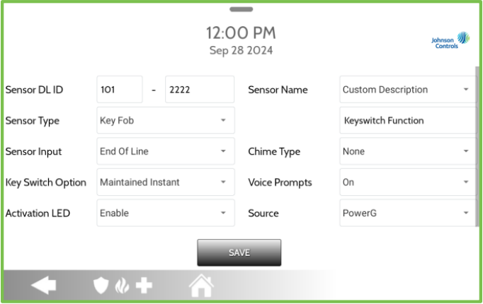

Programming Keyswitch:
Swipe down from main screen > Settings > Advanced Settings > Installer(Default1111)/Dealer(default2222) > Installation > Devices > Security Sensors > You can either learn in a sensor or edit an existing sensor
Note: Sensor input must first be changed to something else from Reed Switch to get Key Fob option under sensor type
Sensor Type = Key fob
Sensor Input = As Needed
Keyswitch Operation = As Needed
