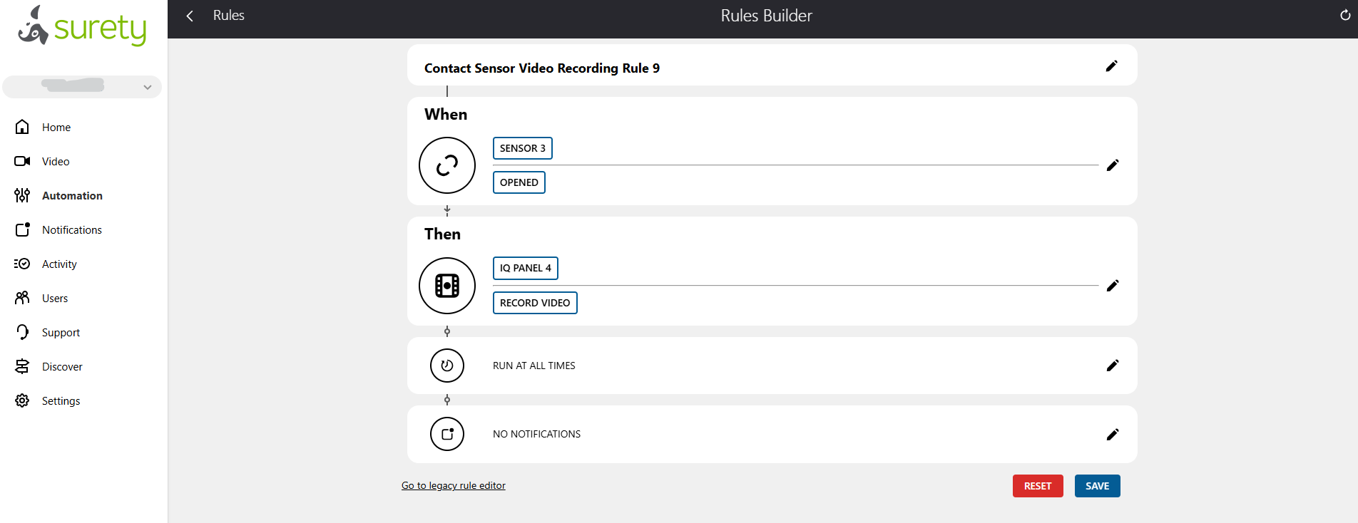

It should look like the picture below. You can have it run at certain times or at all times.

A recording rule can be created to trigger a recording from panel camera based on DW contact activity (open or close) regardless of arming status.
It can also be set to record when an alarm is triggered.
