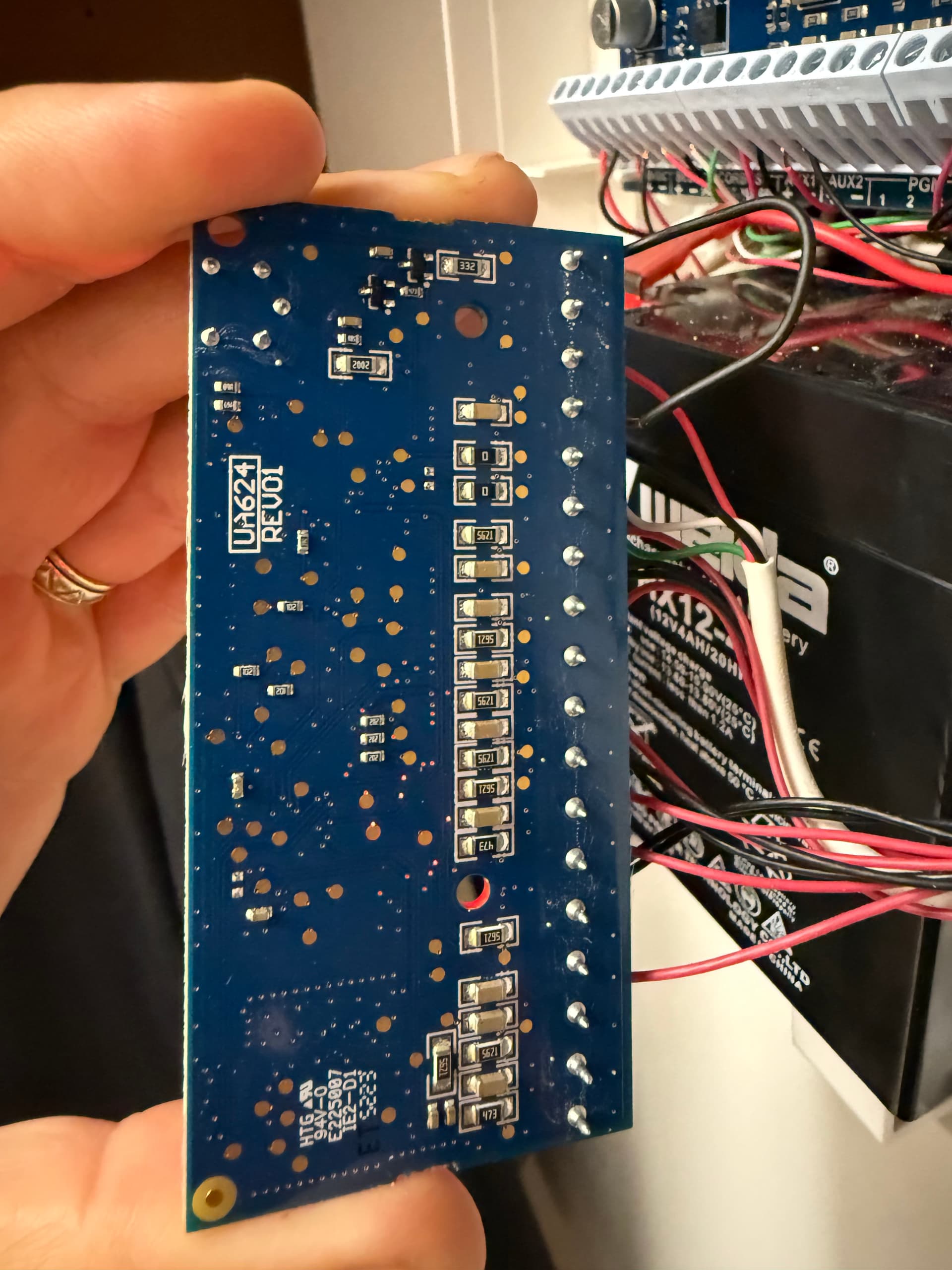

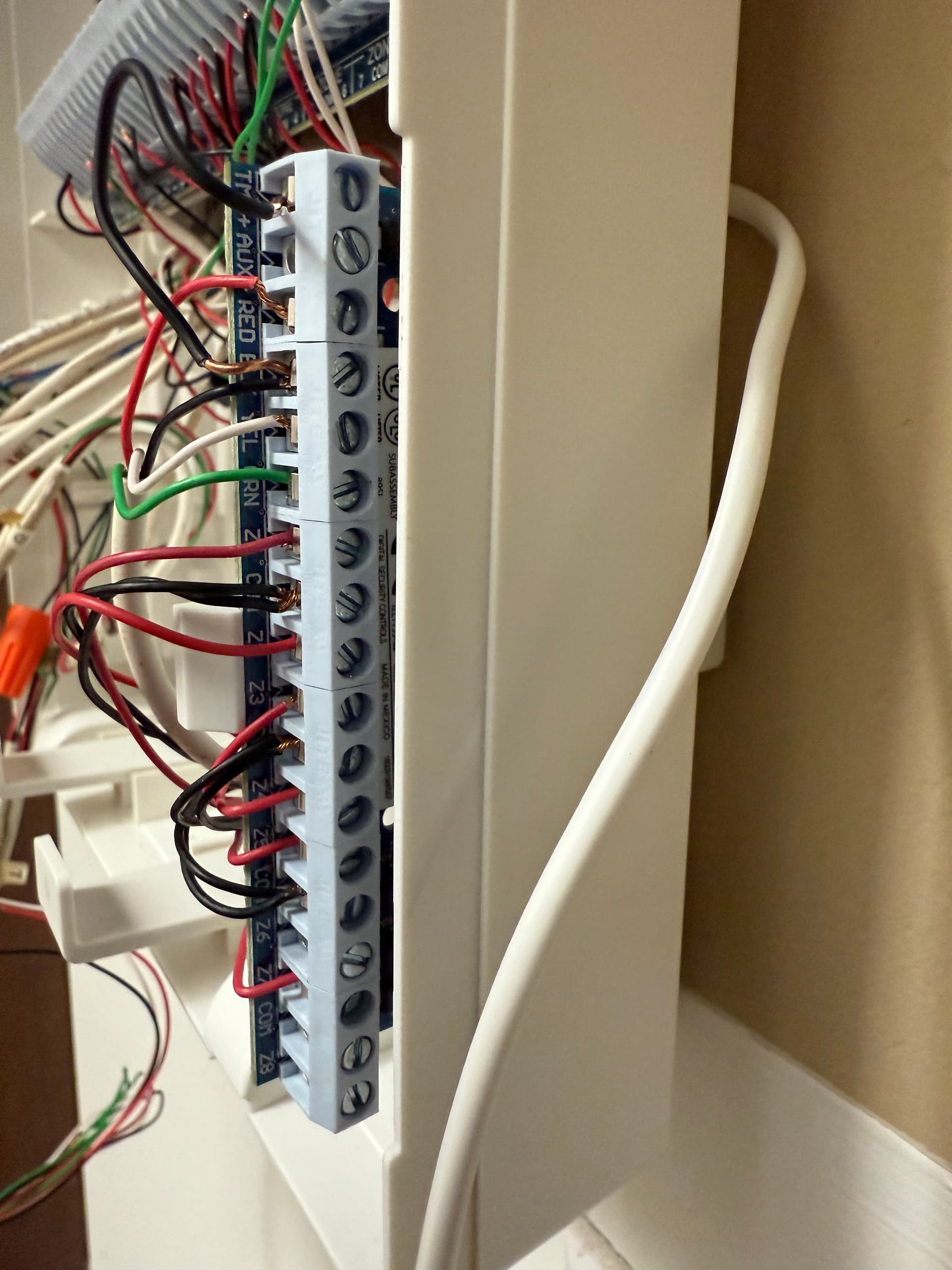

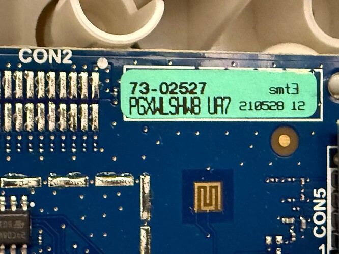

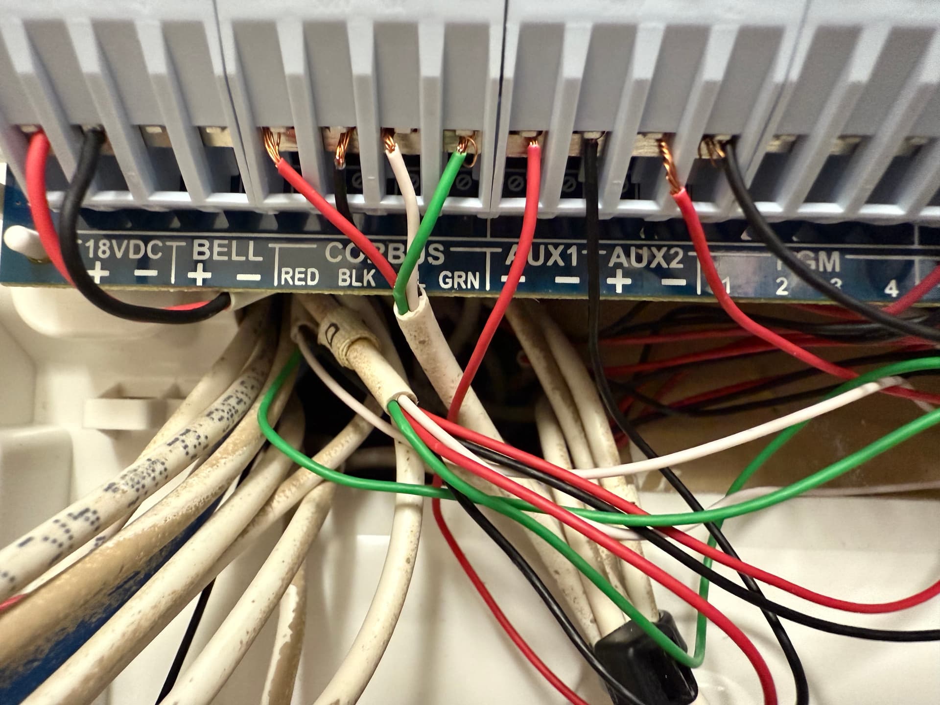

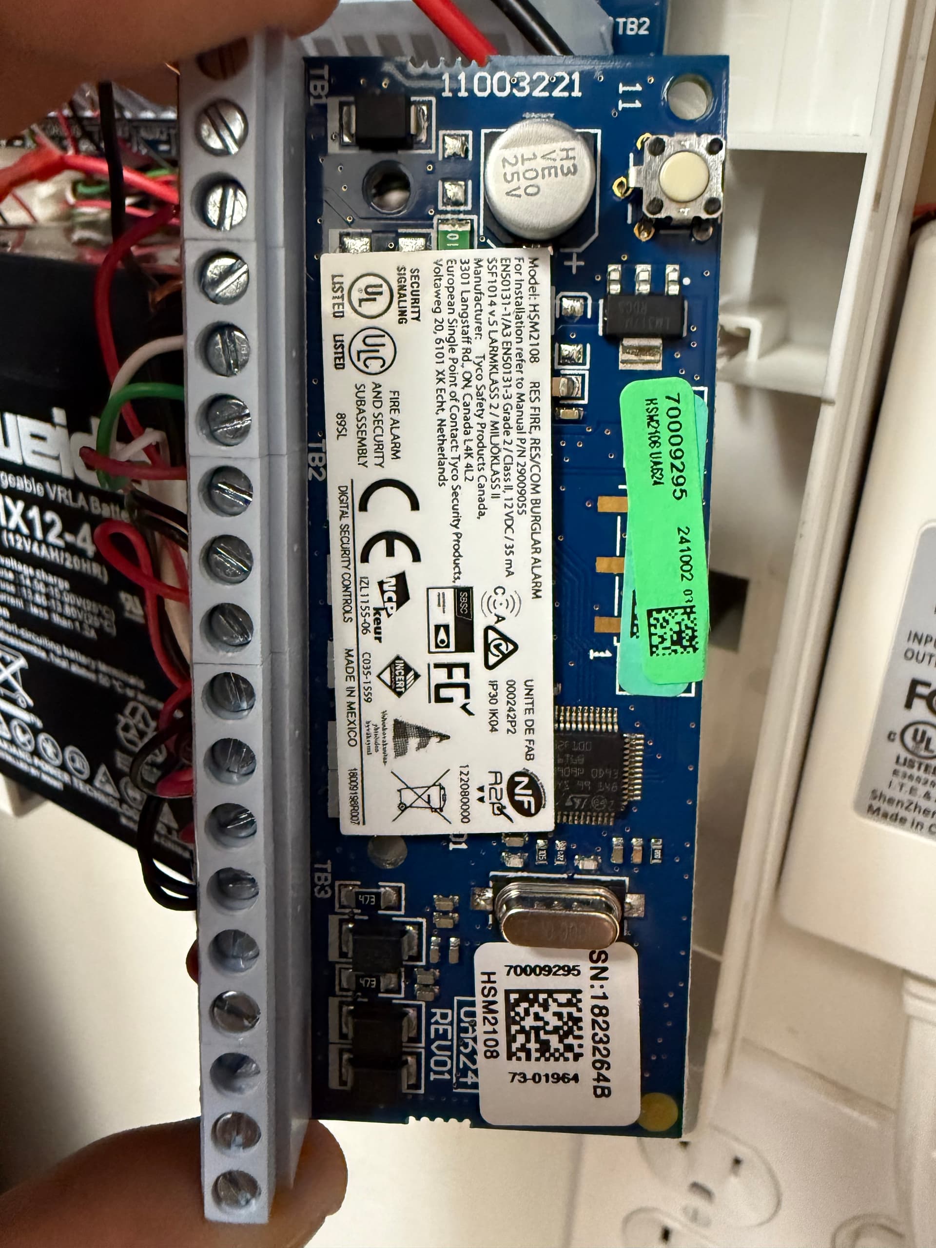

Can you send us a picture of the wiring from the zone expander to the IQ Hardwire Module. Can you also send an up close image of the zone expander board with the date code on it?
Vidail,
It has just one light flashing once. Here are pictures of the wiring. Basically just wired the CORBUS connectors to each other and put in a jumper from TMP to BLK per instructions.

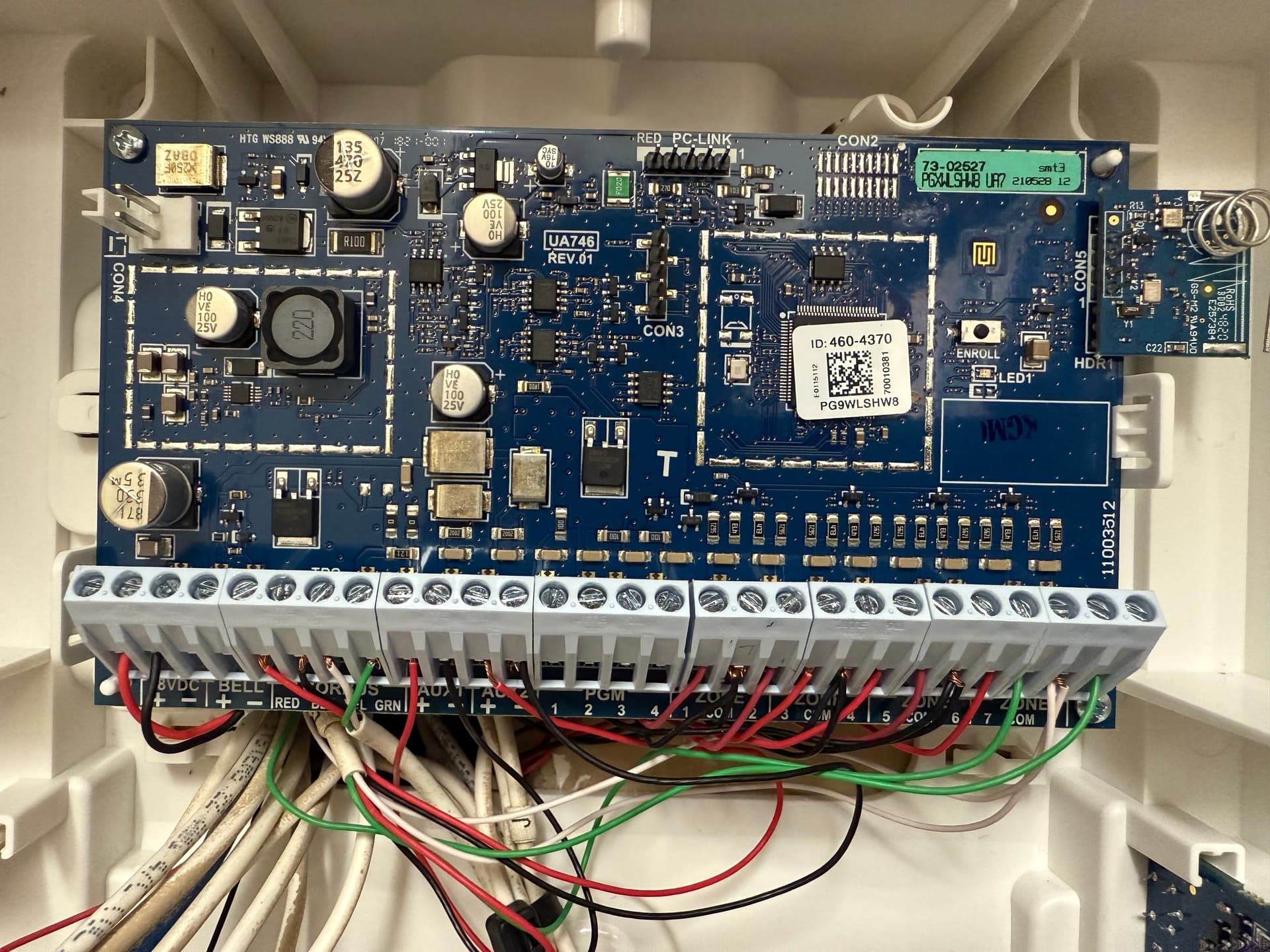

Just reading through the forum and this sounds exactly like my issue. I wonder if my IQ hardwire has an old firmware version. All I can find is this date on the box… can’t find the firmware rev printed anywhere.

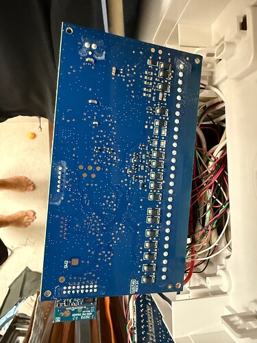

Sorry - didn’t see your request to send a closeup with the date on the expander board. Here’s the expander board and the back of the IQ hardwire.
