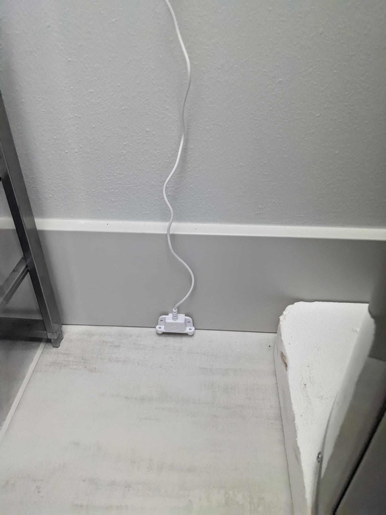

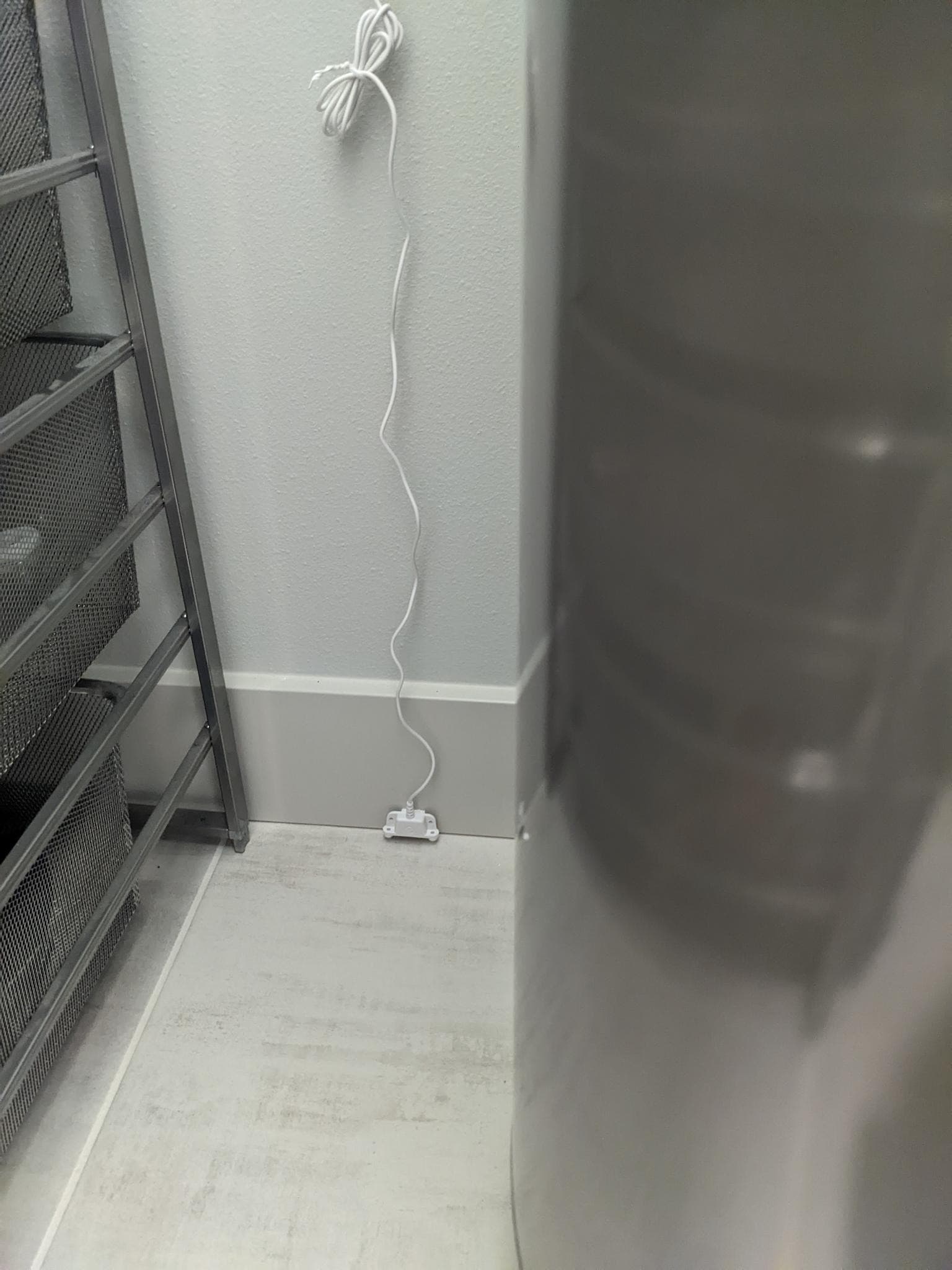

Can you post a photo of the install spot for the probe?
I just re-added the sensor. I noticed the signal source was incorrect. It was showing as “G” where I think it should be “GS”. Now it shows as “GS”. I’m waiting to see if I still get the alerts.
Here are the images.
Any update after changing the source?
Sorry forgot to update here. Yes, that solved the issue. No more false alarms. Thanks!
