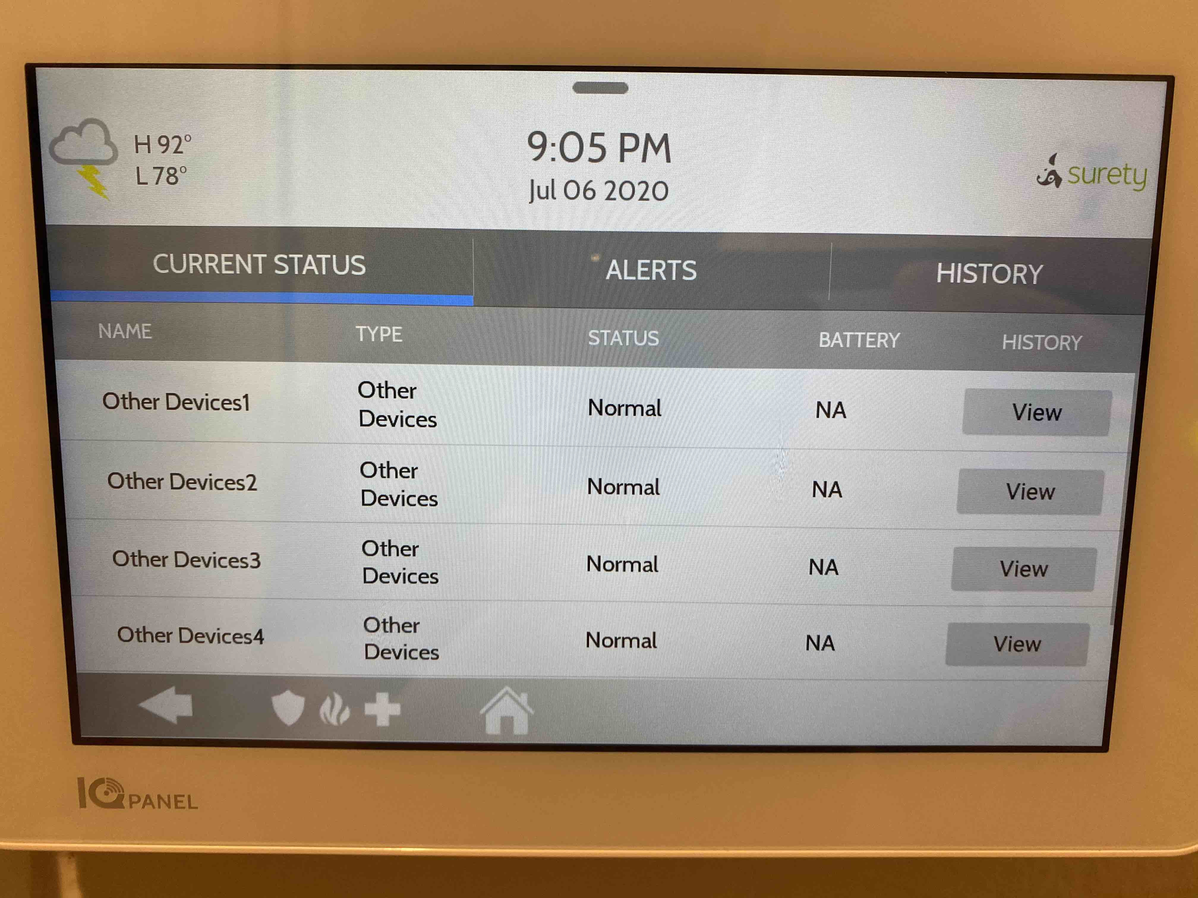

I added the IQ 2+ as a secondary controller as per the excellent instructions. I think it paired okay, but the ST hub shows up in the IQ as “Other Devices1-5”
Anyway, I paired a z-wave yale lock to the ST hub and now it works fine through the ST app but doesn’t show up on the IQ panel. Any idea?
