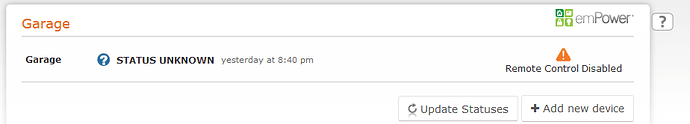

You got me on that one. I did have an extra digit. So I was able to finally add it last night but now i’m getting the following errors on it. Not sure how to remedy this?
Looks like the garage door is showing a malfunction and status updates are not removing it.
How far is the CIGBU from the Garage? Are you using the CIGBU with MyQ enabled wall buttons?
Can you verify that the wall control is currently functioning and the overhead is powered?
Has this malfunction been there since learning in the device or was it more recent?
I do not see this MyQ reporting any status changes, although up until very recently I see a prior Linear Z-wave unit reporting changes. It looks like it was very recently removed. Can you verify that the control button wires were not loosened/damaged during any work that was done?
I have the CIGBU only about 15 feet from the garage right now. Yes the overhead is powered and the opener is working (just tested it). So originally I had a Linear Iris garage door opener that powered my dummy unit that was previously in the garage. I have since removed it but I paired the CIGBU while the iris unit was still paired to the unit so I don’t know if that caused any issues?
The malfunction has been showing up from the very get go, would it be good to start from scratch and have you guys remove it and I’ll re-pair it and see if that clears it up?
Yes, probably good to re-install. I’ve sent a command to remove the door. Please log out of Alarm.com and log back in to verify it is now removed. You can then re-add.
That did the trick! Thanks!
