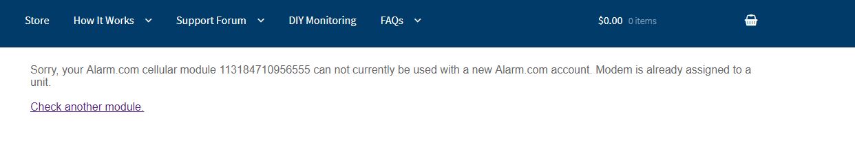

This is the message that appears before a successful cell phone test is run on the panel. Have you attempted to run the initial cell phone test yet? If not, instructions are included in the welcome email.
I did try that and it did not work. I realize that I may have made a mistake and skipped the step of checking the module. I put in the ADC # and received the message that I put in the attached document. What Can I Do at this point if the unit is locked?
If the module was used to create the account for which you got the message indicating there has not yet been a successful cell phone test, then yes, it would show as already assigned to an account. A module can only be attached to one account at a time. If you had no service associated with it, it would say it was available for use with new service.

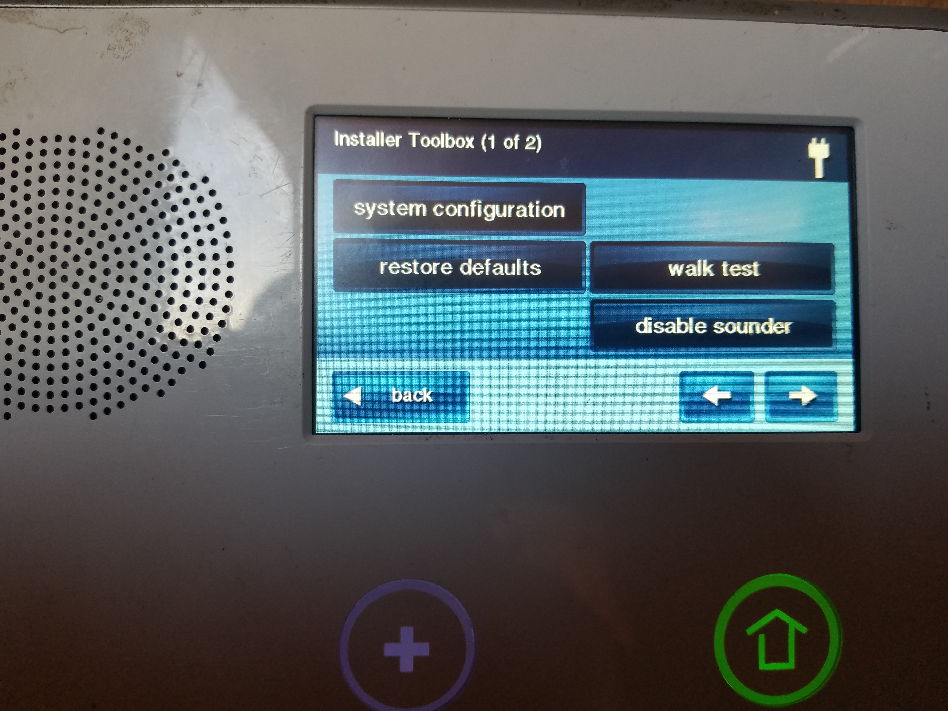

I wanted to send you a picture of the panel. If it is possible for me to send the module and program my old one to your service I think that that is the option that I would like to do.
As you can see from the picture of the panel that the button to test the cell is not there, whereas with the other module it was there and showed me a signal of 16 out of 31.

Thank you for sharing the image. If the panel does not show a radio status button, that means that the panel does not see that a module is physically attached.
The module may be loose. The panel may not be of adequate firmware. The module may be damaged. Or the module was installed/swapped when the panel was still powered by transformer or battery. Those are the likely culprits.
If your older module is unregistered now and you want to try it, the process for swapping it would cover every possible issue above as far as troubleshooting goes.
