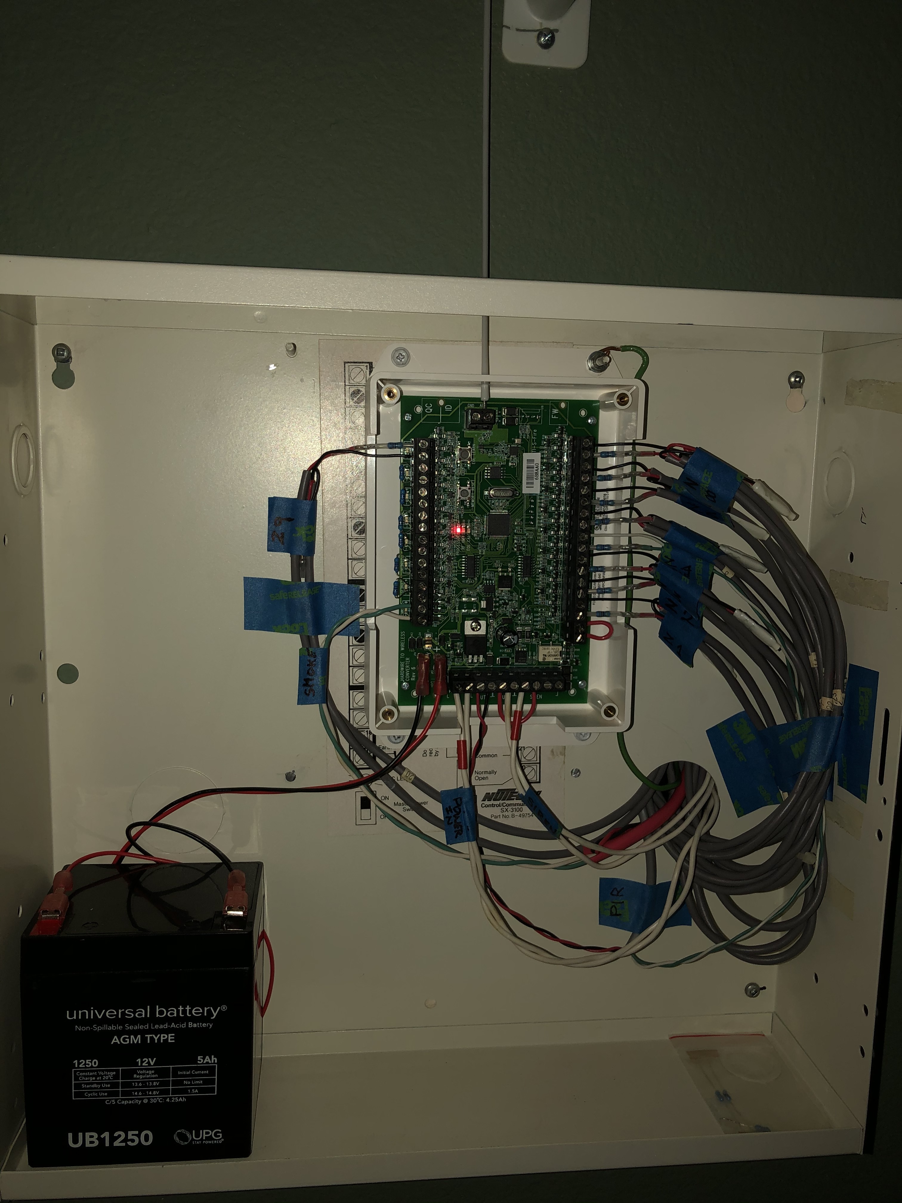

I assume it’s wired properly since you said it’s working. But since we’re running out of troubleshooting options, can you upload a detail pic of the 16F so we can see how it’s wired?

Since we’ve tried 2 batteries and one of them was exactly to the 5Ah spec, the problem is more likely caused by the wall power supply. From your pics, I see that you have the wall power transformer outside the box and connected via the wire labeled Power #2. How long is that wire? We need to troubleshoot that wire and any connections between the transformer and the Hardwire 16F.
