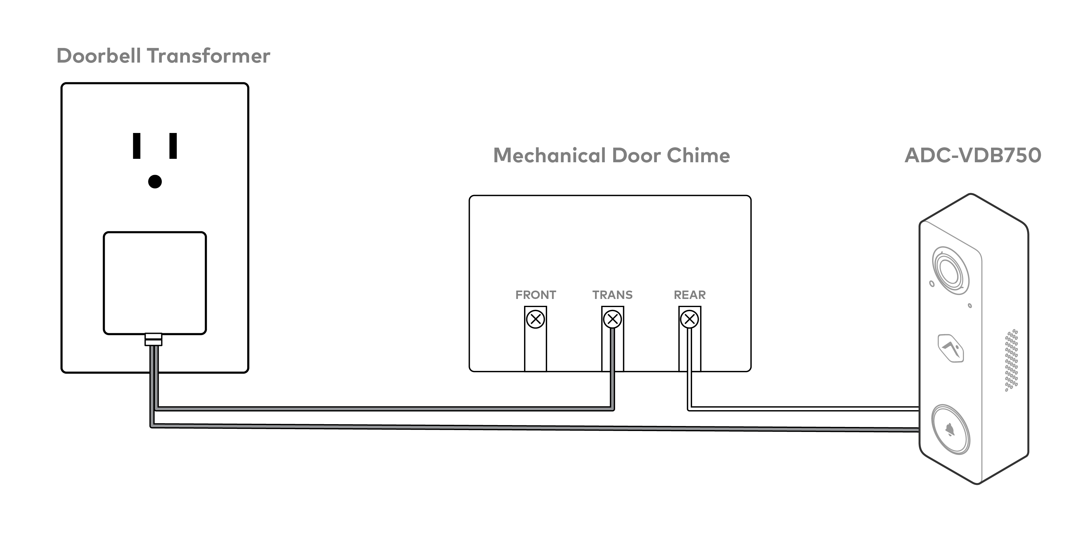

Wire the ADC-VDB750 to a mechanical chime
To wire the ADC-VDB750 to a mechanical chime using an AC transformer:
After wiring the doorbell to the transformer, wire the doorbell to the front or rear terminal of the mechanical chime.
Note: If the doorbell hums or buzzes, attach the resistor provided between the chime terminals used by the ADC-VDB750 and the transformer.

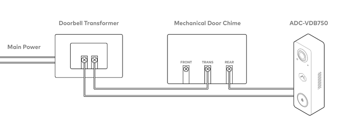

To wire the ADC-VDB750 to a mechanical chime using a DC adapter:
After wiring the DC adapter to the doorbell and trans terminal of the chime, wire the doorbell to the front or rear terminal of the chime.

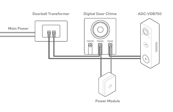

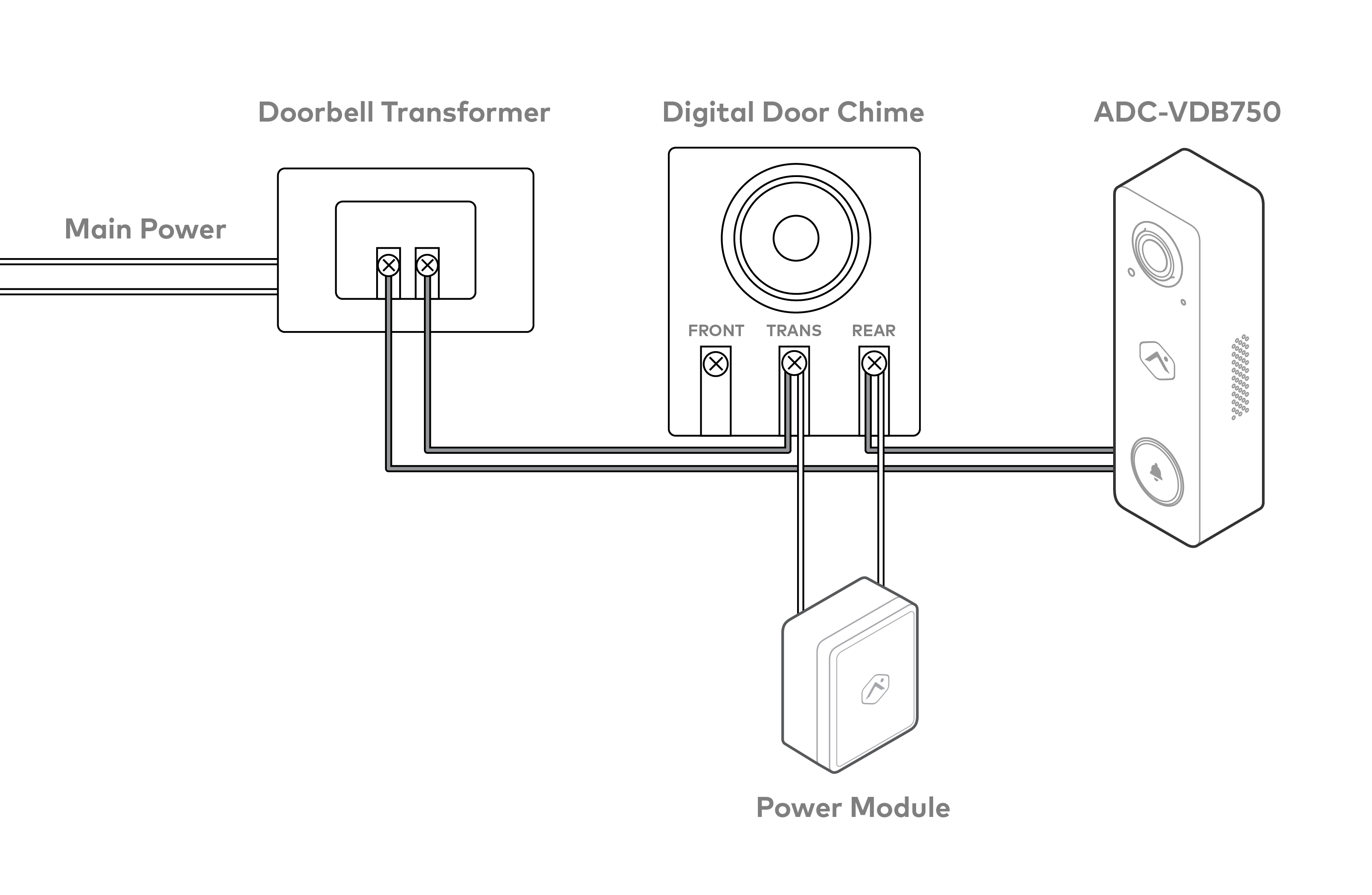

To wire the ADC-VDB750 to a digital chime:
After wiring the doorbell to the transformer and chime, attach the white wires of the power module interchangeably to the same terminals as the transformer and doorbell.
