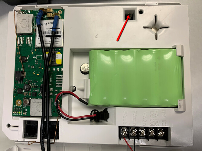

The tamper switch on an Interlogix Simon XTi is the spring near the top portion of the backup battery on the right side of the back of the panel.
How to resolve:
Disarm the system, then open the panel. Affix the backplate onto the panel and verify the tamper spring is pressed down when attached.
