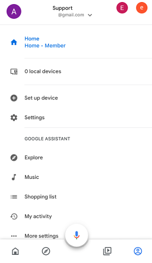

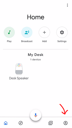

- Tap to open the Google Home app.
- Tap the Account icon as shown in the following image.

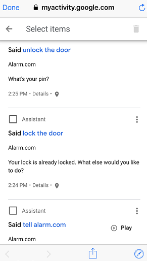

Tap My activity .
Flick to scroll and find the recent commands said to Google Assistant.
- Confirm the device name Google Assistant heard and the device name on the Alarm.com system match. If the names do not match, change the name on the Alarm.com account to match what the Google Home heard.
