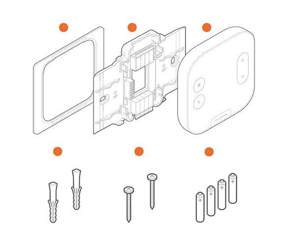

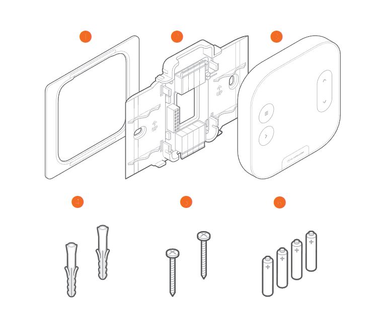

In the Box
1. Trim Plate 2. Back Plate 3. Thermostat 4. Drywall Anchors (2) 5. Wall Screws (2) 6. AA Batteries (4)

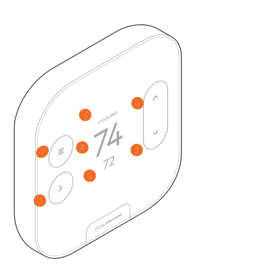

Buttons & Display
  1. Menu - Enter menu
  2. Select - Select/confirm menu item
  3. Current Mode
  4. Ambient Temperature
  5. Target Temperature
  6. Up - Adjust target temperature up or Navigate menu
  7. Down - Adjust target temperature down or Navigate menu

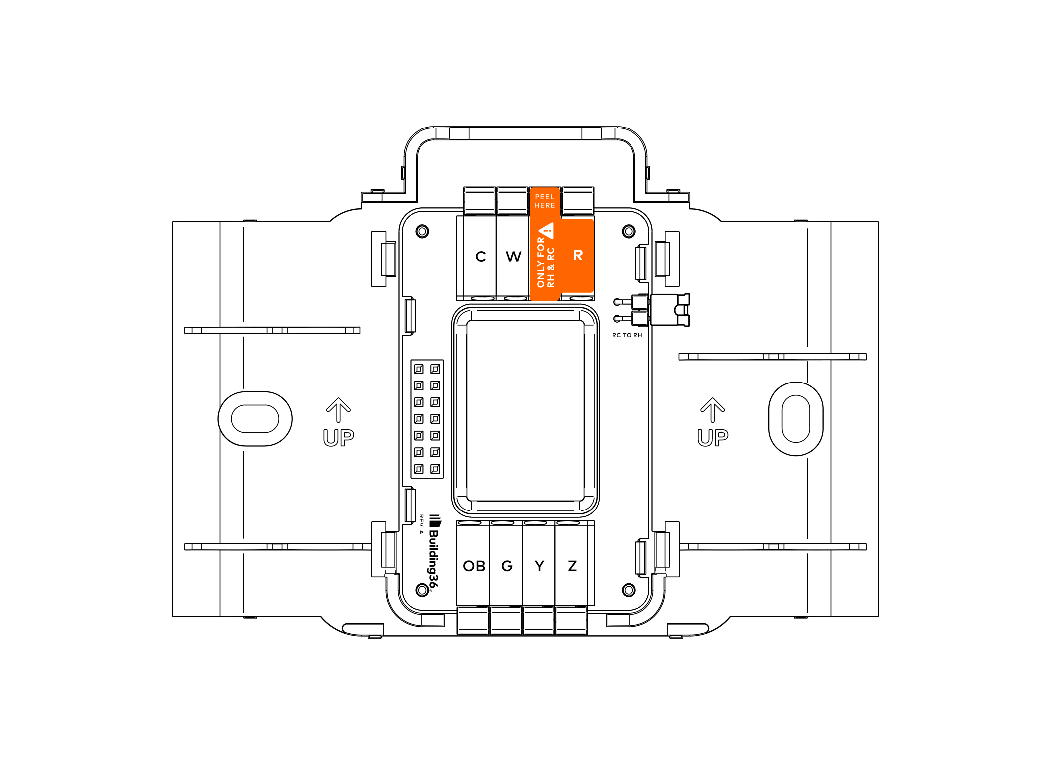

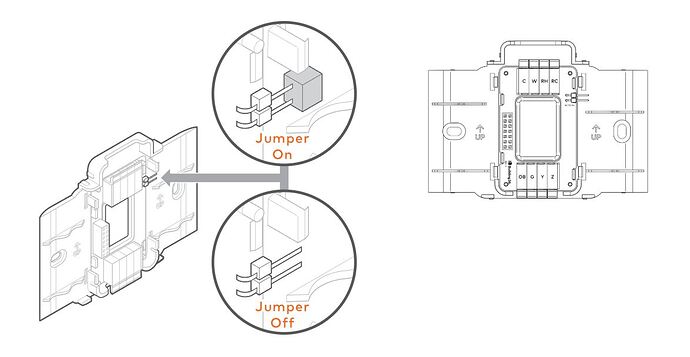

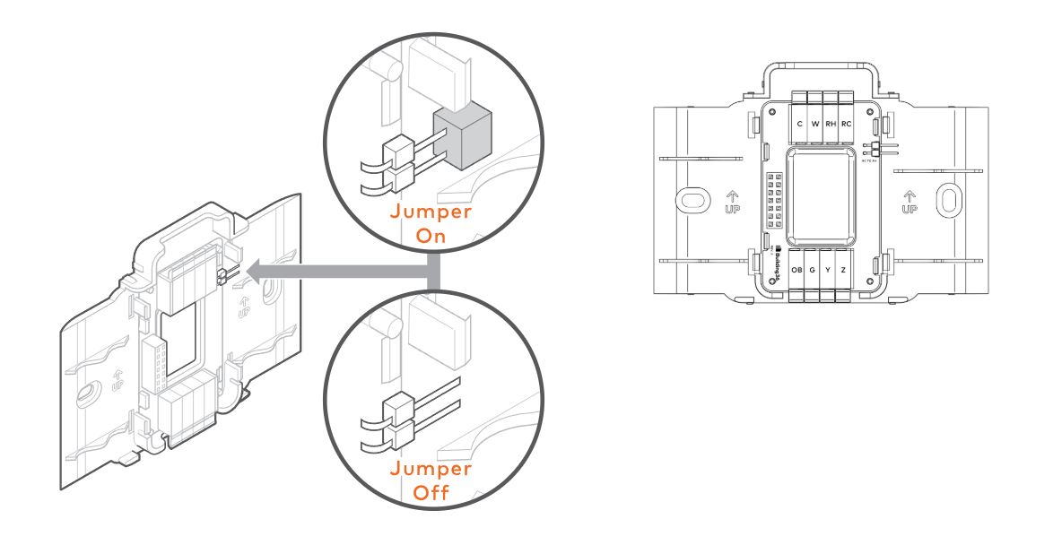

  • If there is only R, connect to RC. The following image displays the terminal layout with the sticker on it directing which terminal to connect for R.
  • If there is RH and RC, peel the sticker for RH & RC and remove the black jumper in the top-right corner of the backplate as shown in the following images:

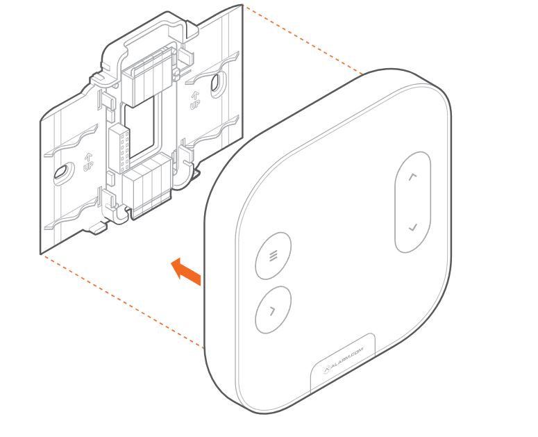

  3. Connect the Thermostat to the Back Plate.

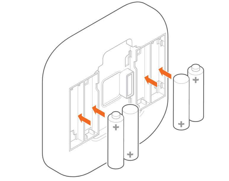

Changing the batteries
If the thermostat batteries are low, replace the batteries with four new AA batteries.
  1. Remove the thermostat from the backplate by pulling the thermostat straight out and off the wall.
  2. Take out the existing batteries.
  3. Insert the new batteries following the specified polarity markings on the thermostat.
  4. Return the thermostat to the backplate by pressing the thermostat body firmly into the back plate mounted to the wall. Ensure that the pins on the body are correctly aligned with the back plate. Failure to do so could cause damage to the thermostat.
